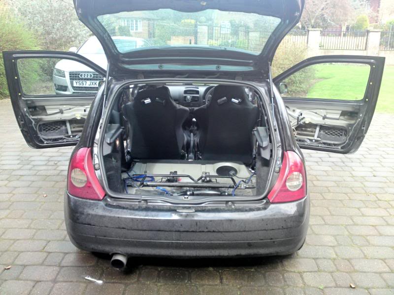

In my PH2 the back seats with the bar
weighed 20 kilos, car feels much lighter now.
I put some carpet down and fitted an OMP rear strut brace.
When I put them back in for MOT time the car feels like Sh1t.
