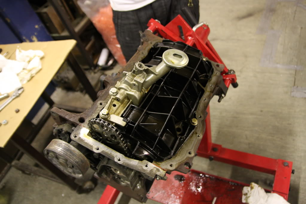

I definitely think they’re a good thing. I’ve never had the sump off a 172 yet so don’t know to what extent they’re baffled already (if at all) or indeed exactly where the oil pick up is located.
Anybody know or got any pics???

Done a bit more research into it and with the above pics has given me more confidence in the standard set up. I always slightly overfill the oil too, so don't think I'm gonna bother with it.
So cheers, thats saved me a few quid I can spend on other stuff.
