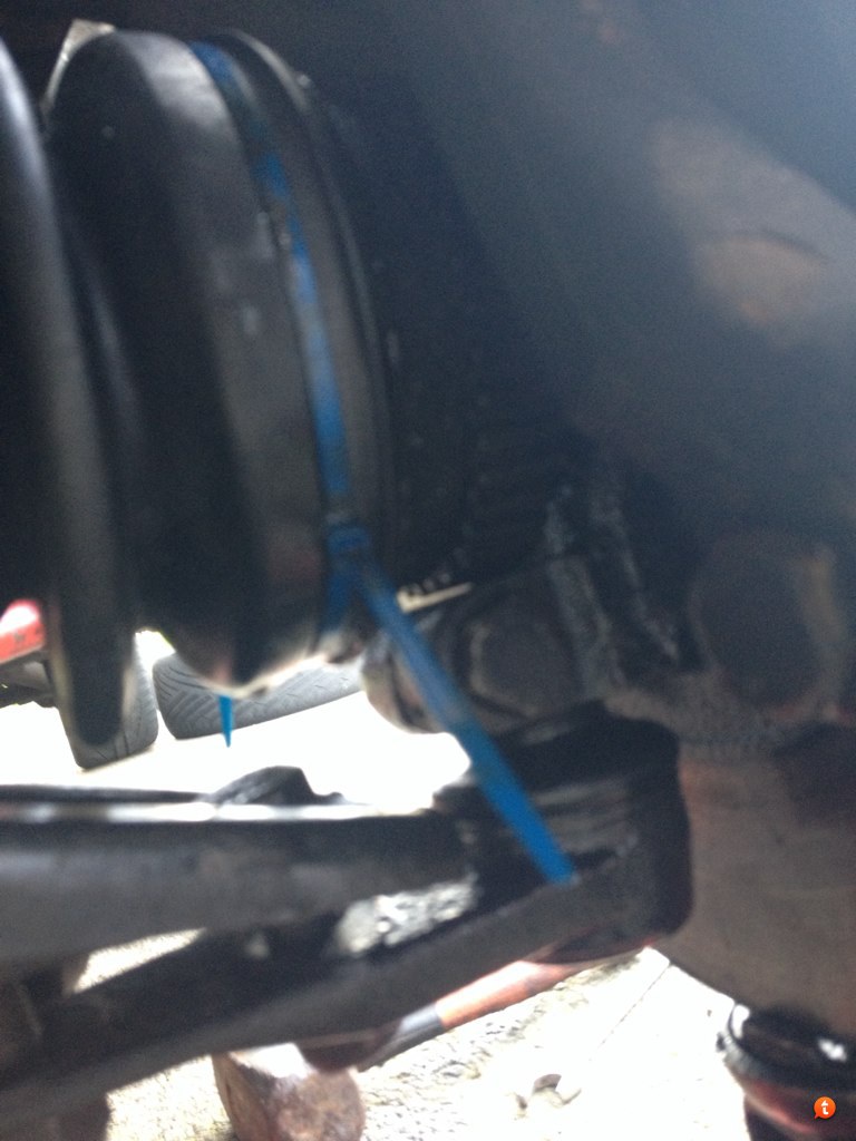

I have all the bolts undone but cant get the both out from the joint end itself. Tried everything, havent got acsess to power though any ideas?

Have you got a ball joint splitter? If so put it between the hub assy and the ball joint and hit it hard with a hammer and it should drop out

No no splitter unfortunaly.
That bolt wont budge though

Flol get rid of that stupid cable tie holding the boot on as it won't last. Jubilee clips are cheap enough.

Yea need to get one tomorrow to change. Nowere was open after i got it back on today. Also need some wheel nuts and one removed from the hub now. Lol
