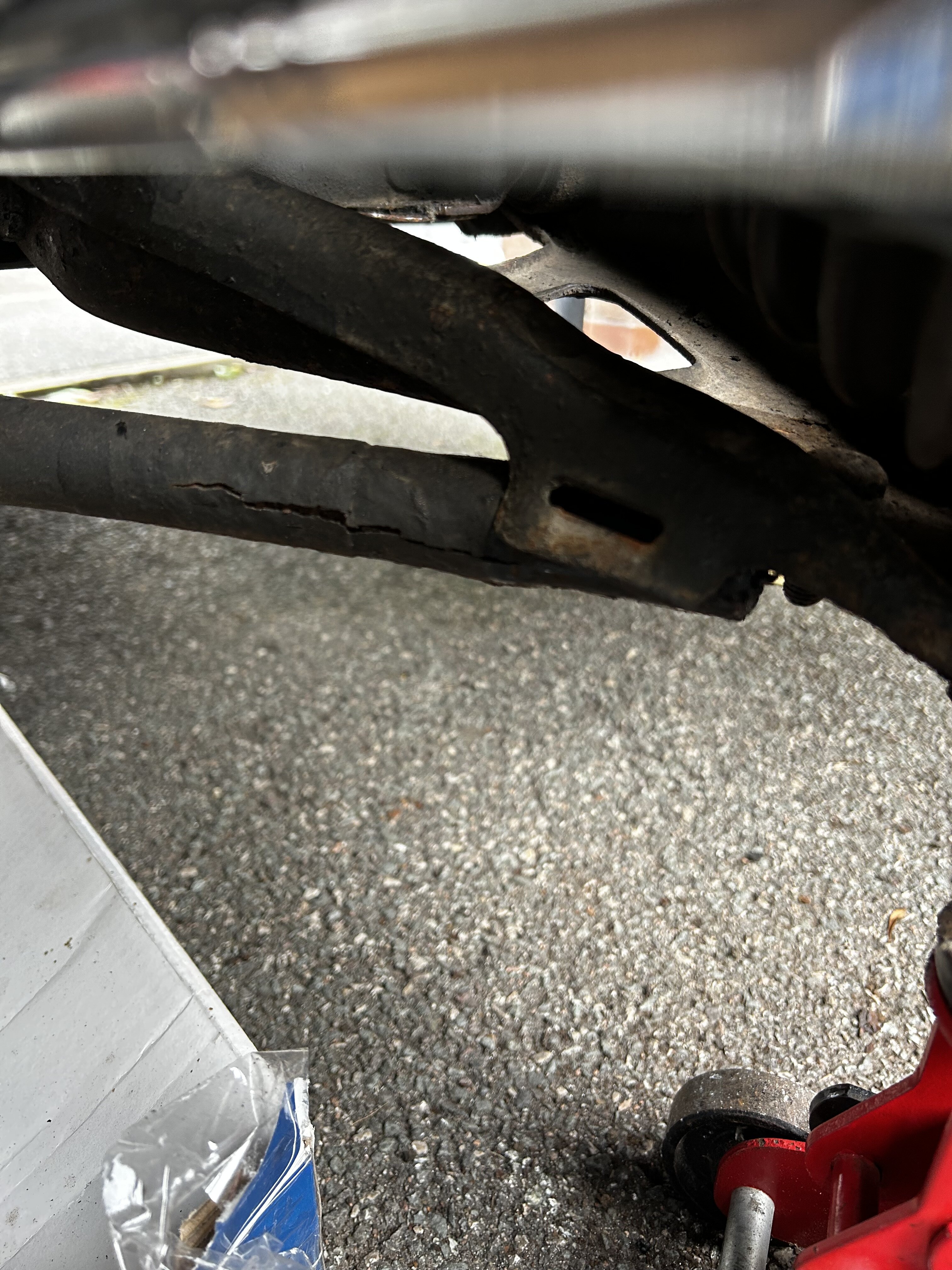

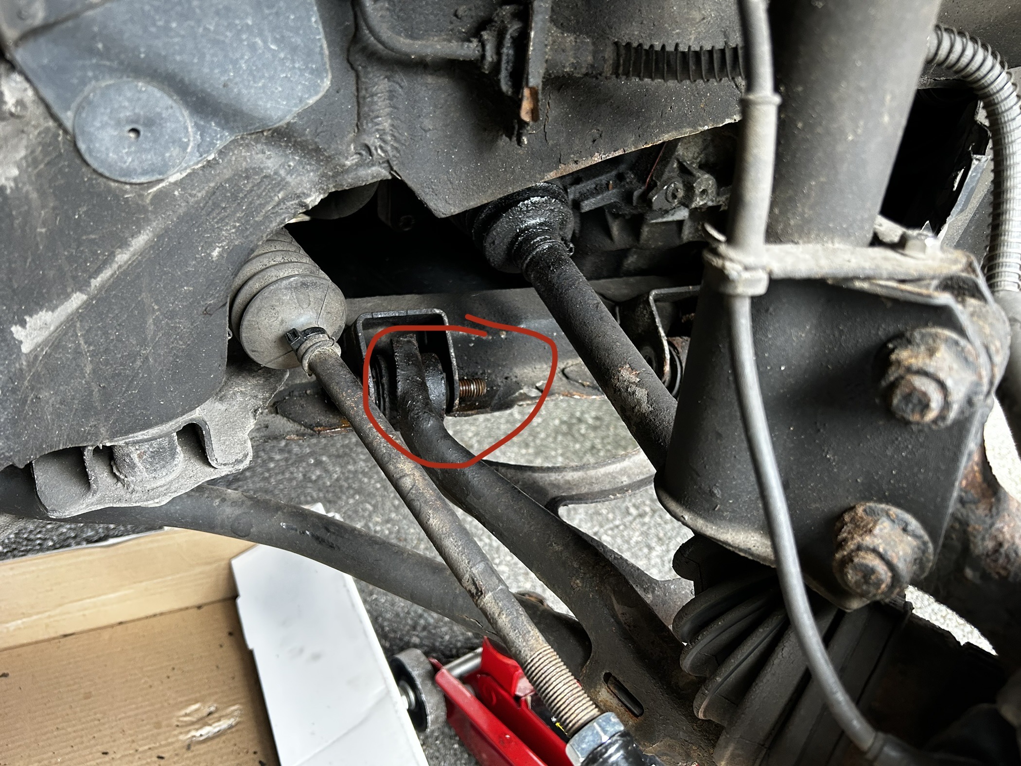

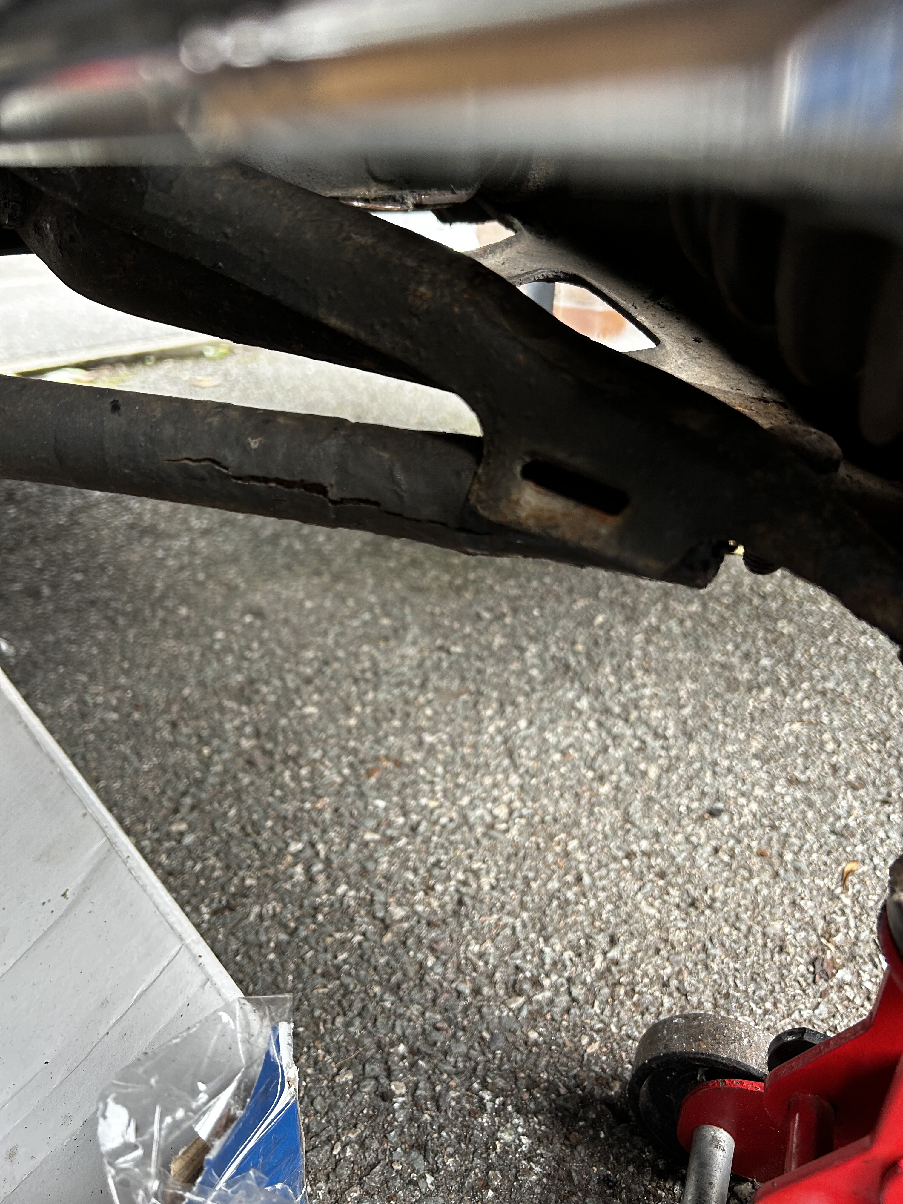

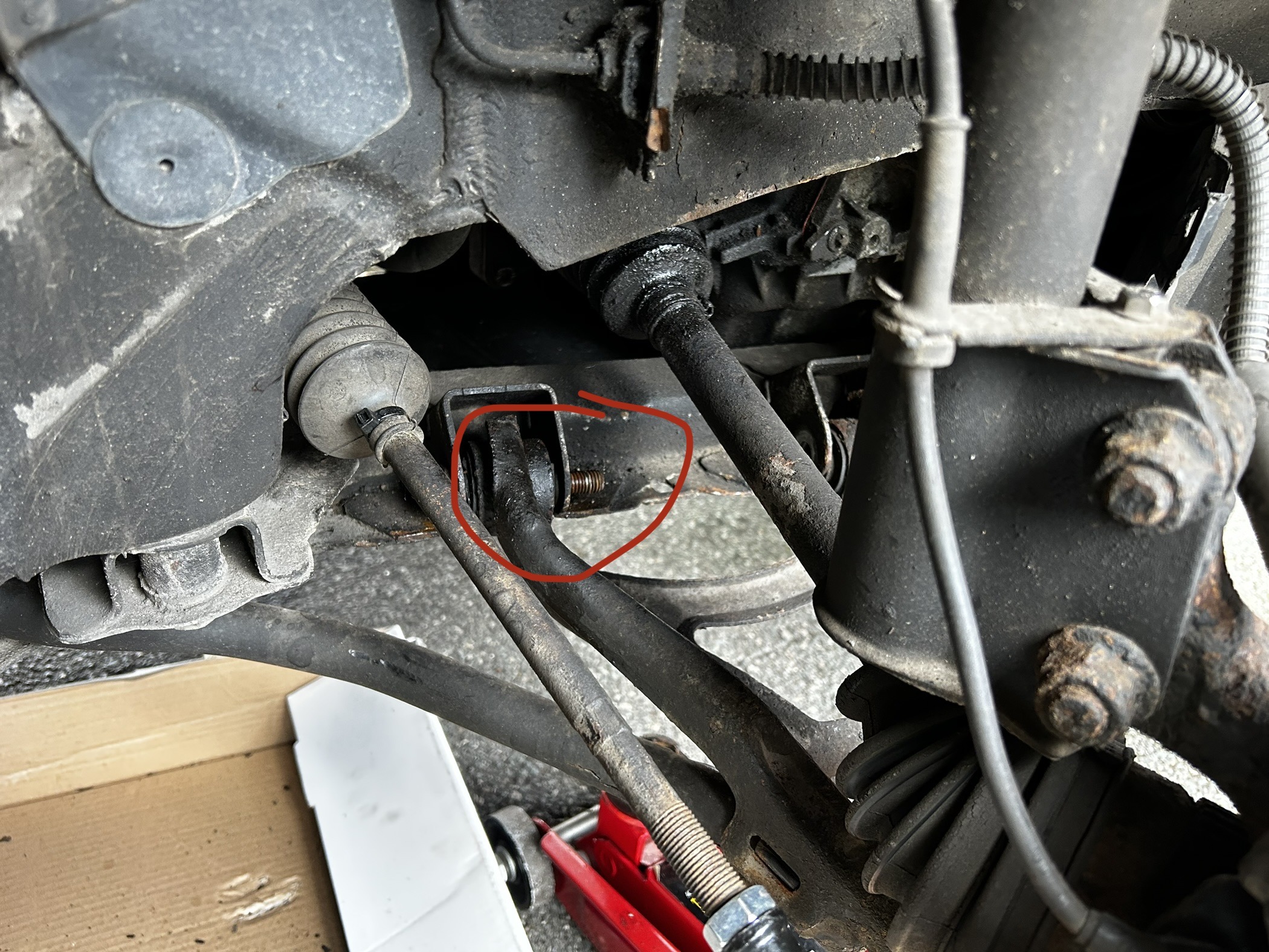

I’m after a bit of help please, does anyone have any ideas on how to remove the bolt on drivers wishbone as pictured? There is slight movement but not coming out.
All other bolts are out, the Arb has tension in it which doesn’t help, both front wheel jacked up.

Does the bolt move at all?
I had one of my wishbone bushes seize to the bolt so I had to cut it either side with a reciprocating saw to get it out
Thanks for your suggestion of the reciprocating saw, I used one on the seized bolt. It had seized to the metal insert in the rubber bush which had come away from the rubber, there was no shifting the bolt otherwise.
