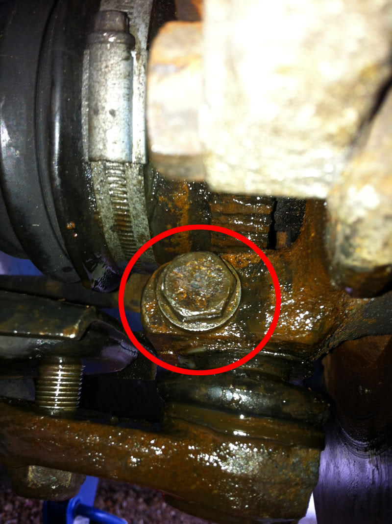

Any help on removing this:
You'll need to grip the nut on the other side, as obviously its spinning the whole bolt/nut.
I removed the nut expecting the bolt to come straight out.
The thread has burred on the bolt and i cant get thr nut back on the thread :(
You should get a new one with your new ball joint, therefore you can try turning it and tapping the other end with a hammer. The hole is not threaded so if you do damage anything it will only be the ends of the thread on the old bolt.
