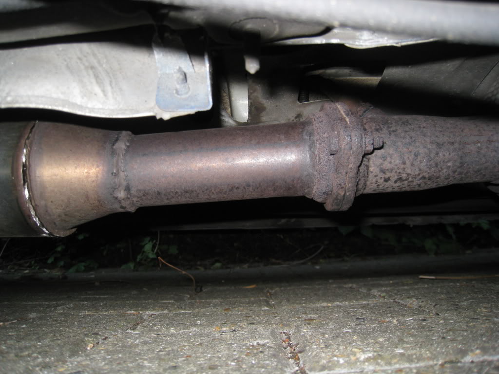

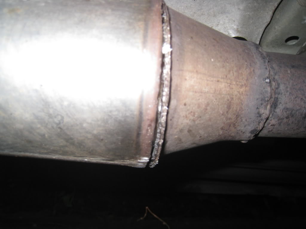

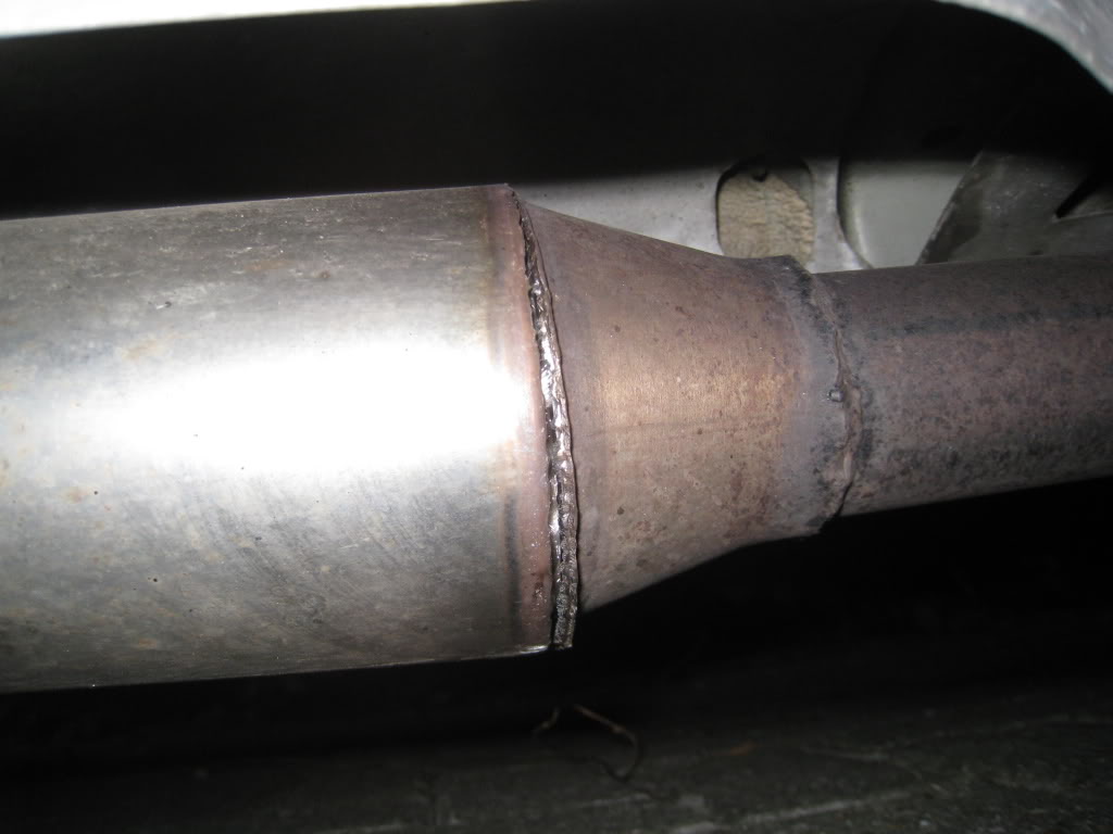

OK, had this Prospeed put on last January, loved the sound and the stealthness of it, however after a few months I noticed an almost baffley noise coming from the backbox... nothing loud just a slight bugging noise. Anyway i left it, then a few days ago I started the car and it sounded bloody awful... like it was really blowing in the centre section.... have been a bit busy but just had a look and this is what I found on the centre Section...
Now prospeed have a lifetime warranty, so I thought I should take it back and get it replaired/replaced, but on closer inspection I can see that its scraped on the bottom side a couple of times and assume this may be a factor in the splitting of the seal... however should it have split so easily? what are peoples opinions? Warranty job or not?

If it was me i'd sand paper it down and spray with some high temp paint that protects the exhaust, that way they'd never know i presume

Is it simply weldable?

Will the car get through an MOT with that?

That won't pass an MOT, but if it was me, i'd weld it back up.
Its a quick job and certainly not worth driving 400 miles!

phone prospeed first mate and tell them your situation and that if its ok for you to get the welding done at a local garage. otherwise if you dont tell them then it may invalidate your lifetime warenty but surely a few scrapes shouldnt make the welds burst open like that so i would look to getting a replacement made. i would look for a local powerflow dealer or exhaust place and get them to make you a new cantre section. will probs be cheaper than the petrol you will use to get to prospeed
Cheers guys.. gonna call Charlie today at some point. Was thinking about swapping the backbox for the 182 type rear box instead anyway.
