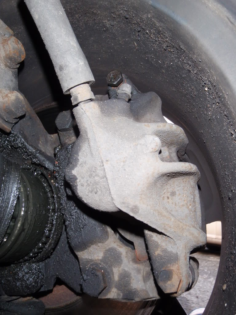

Anyway, here's where I found the screw that came out of the top of the caliper (wedged in between that bracket and the chassis)
You can see in this pic where it's out of the caliper

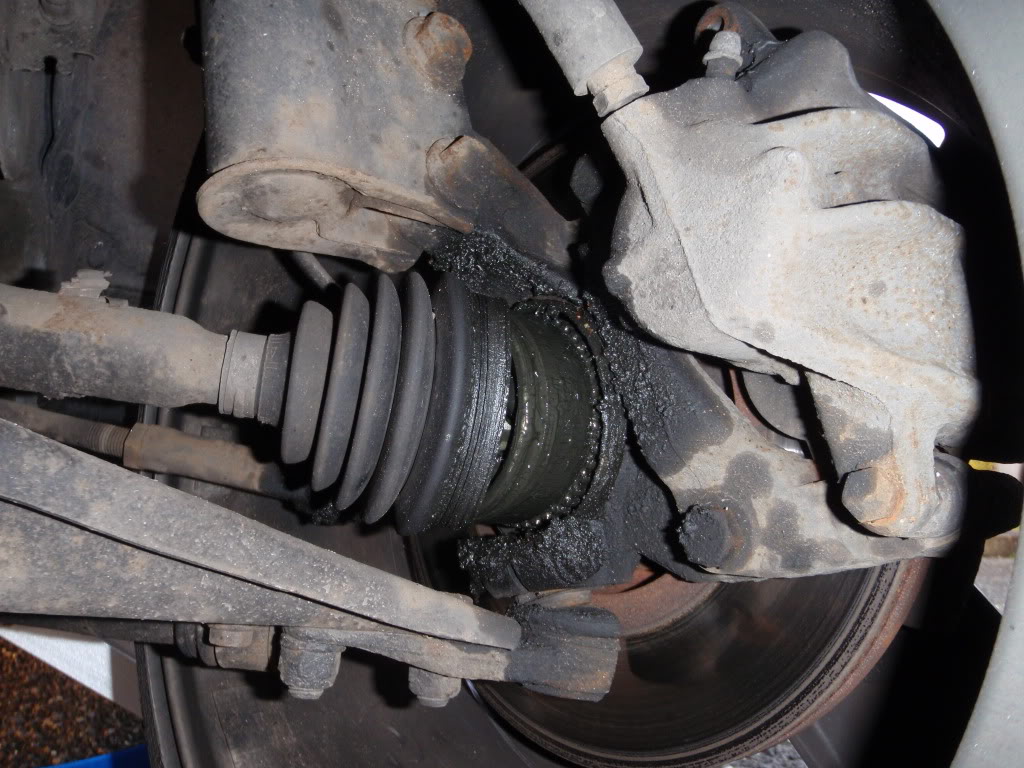

And of course my lovely CV joint :rolleyes:

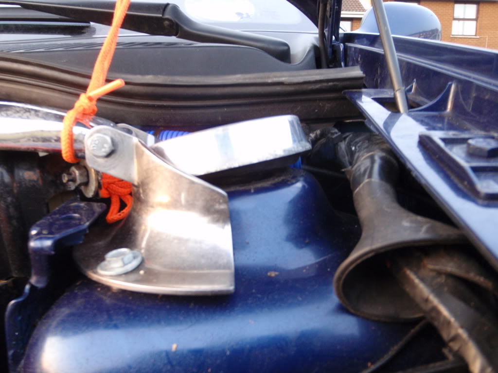

Top mount in full left lock!

^^ My god thats a bit messy haha.. CV joints are a nightmare when they come apart! Looks like in those pictures though that the carrier is hubbing on the joint (not sure if its just the grease thats making that effect or not)
Looks asif there are a few issues with your offside, I'm pretty sure the top mount shouldn't be sitting like that when on full lock, Mine tilts ever so slightly but not as bad as that... Hopefully you have it sorted mate I bet that was a bit of a shock to find a random bolt wedged into the chassis lol

Just managed to get onto a PC with a much better monitor then the sh!t we have a work.. Can see now that the carrier hasn't rubbed the CV.. Oh and I meant Nearside really! Doh!
