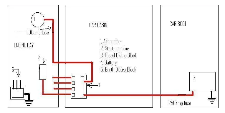

The above sketch is merely an example of how I would go about relocating the battery in my car, as I stated earlier I'm not familiar with the Clio so you may not require all the under bonnet earths or fused feeds.....

Thanks for the replies, so can I use any 4awg cable as everything I can find seems to be amp wiring, will this also be ok to use for the battery and starting etc??
I suppose you have decided to ignore my previous post.....
