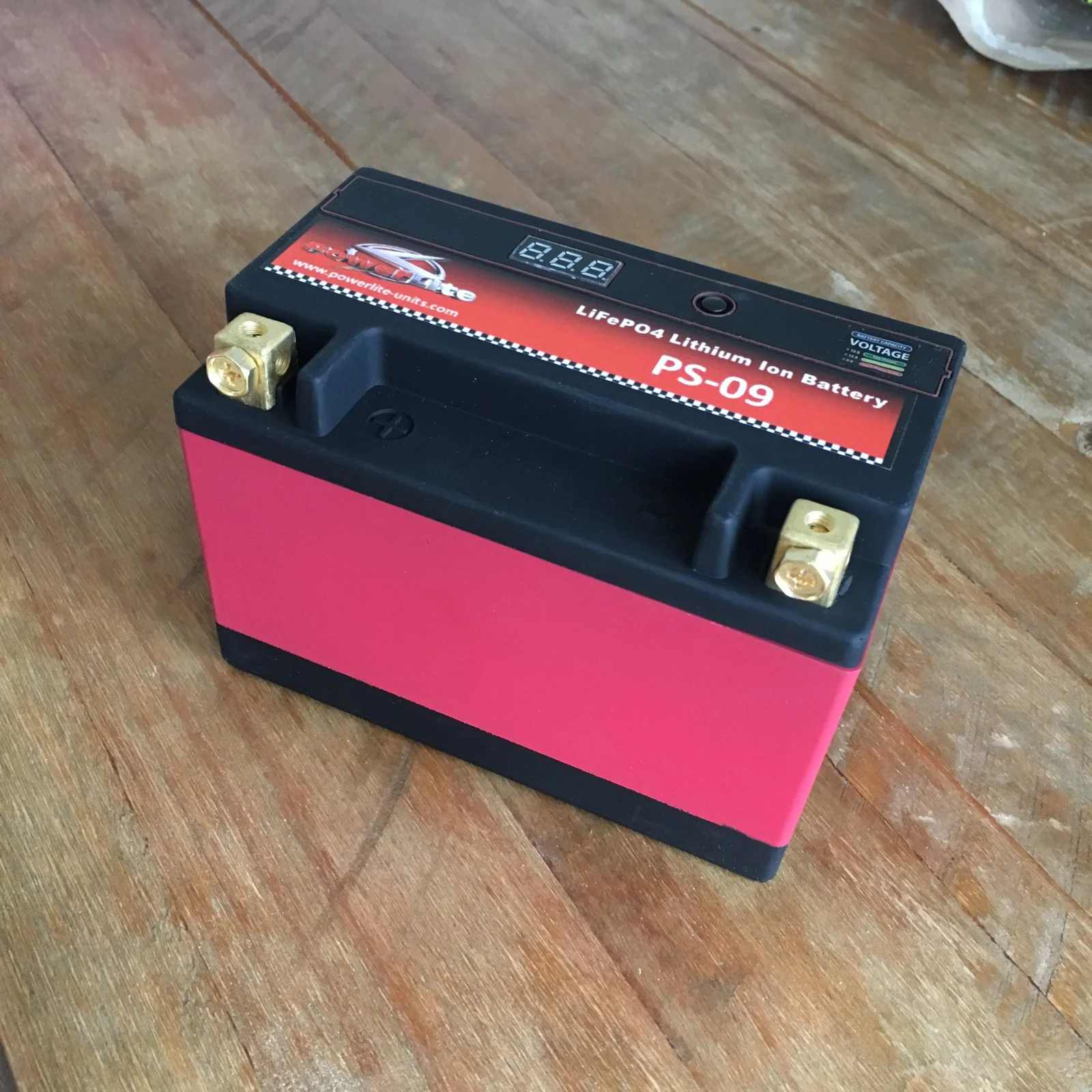

I've recently purchased a new smaller batter for my Clio, a Powerlite PS09, which although is great and light I'm slightly worried about it not having enough power if not left on charge. Therefore I wish to install a cut off switch so that I can ensure it'll start when required when away from home.
The car is only used for trackdays, sprints and the odd Sunday blast, while at home the battery is left on charge.
The battery will be fitted within the engine bay and I will be shortly fitting aero catches so I'm hoping to fit the cut of switch within the engine bay.
Is it simply a case of fitting a cut off switch on the positive side just after the battery?
Anyway here a pic of the battery, as everyone loves a pic!

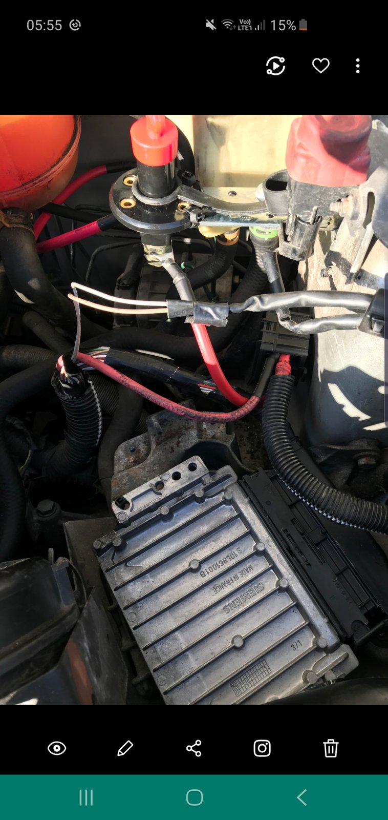

I did the very same as yourself and used a simple isolator, I used a bulkhead fitting and in the engine bay it goes ;
Bulkhead fitting - isolator - junction box - fuse box
Have attached a pic that I found, bracket mounting isnt the neatest but I was kinda hurried at the time and its turned into a permanent fixture haha. If your needing anymore I can grab some as got the car sitting at home just now
My rubber cover ripped after 6 months or so

Attached now
