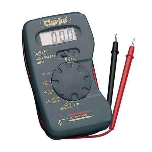

g@z when running its on a steady 14.4V so the altrnator is ok.. also i am a bit new to this mulit meter things so i have a clarke cdm15 which setting would i put it on and what results on screen would be shown if there is something drawing current?

Put multimeter on current (amps), that looks auto ranging so this should do.
Test between -ive terminal and the wire you removed from that terminal.

When measuring Volts, that goes across the circuit like youve done, Amps need to be in circuit, so like Jenic said you need to disconnect the (+) put one probe on that, then the other on the battery. Then remove one fuse at a time (mate needs to do this with the door shut - interior light) and ignition off. Make sure you have the radio code also ;))

I have just been out and tried what you said and the meter said 00.0 so I opened the door and it still said the same!

Shouldn't read more than 0.2A, most cars are around the 0.13 mark
not sure if my mul;timeter is good enough to do this or i am not i put the slider on A and turned the dial to the 200 position also with a A on it?
still says 00.0???

YouTube has plenty of videos to show you how and most multimeters have 3 pins for your 2 cables. You need to make sure it's in your amp hole- read your multimeter instructions though

watched some vids and i read the instructions still non the wiser there is a pic of the multi meter in a post above and idea which setting i should be using?
alreadt tried putting the slider on A and turning the dial to the 200 position also with a A on it?
