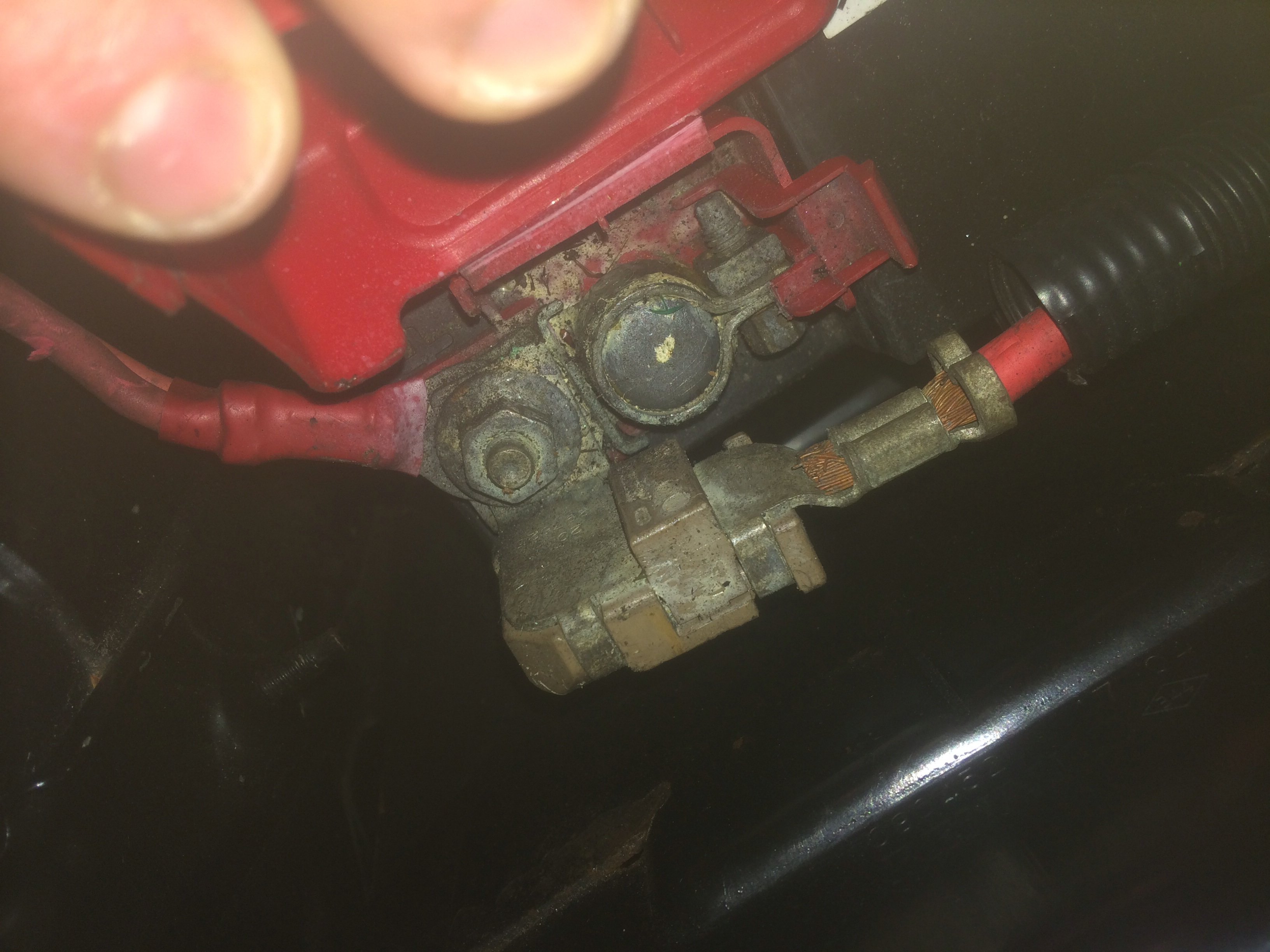

Hi, i have a clio 182 and need to relocate the battery to the boot for more space in the front for a bigger turbo induction setup.

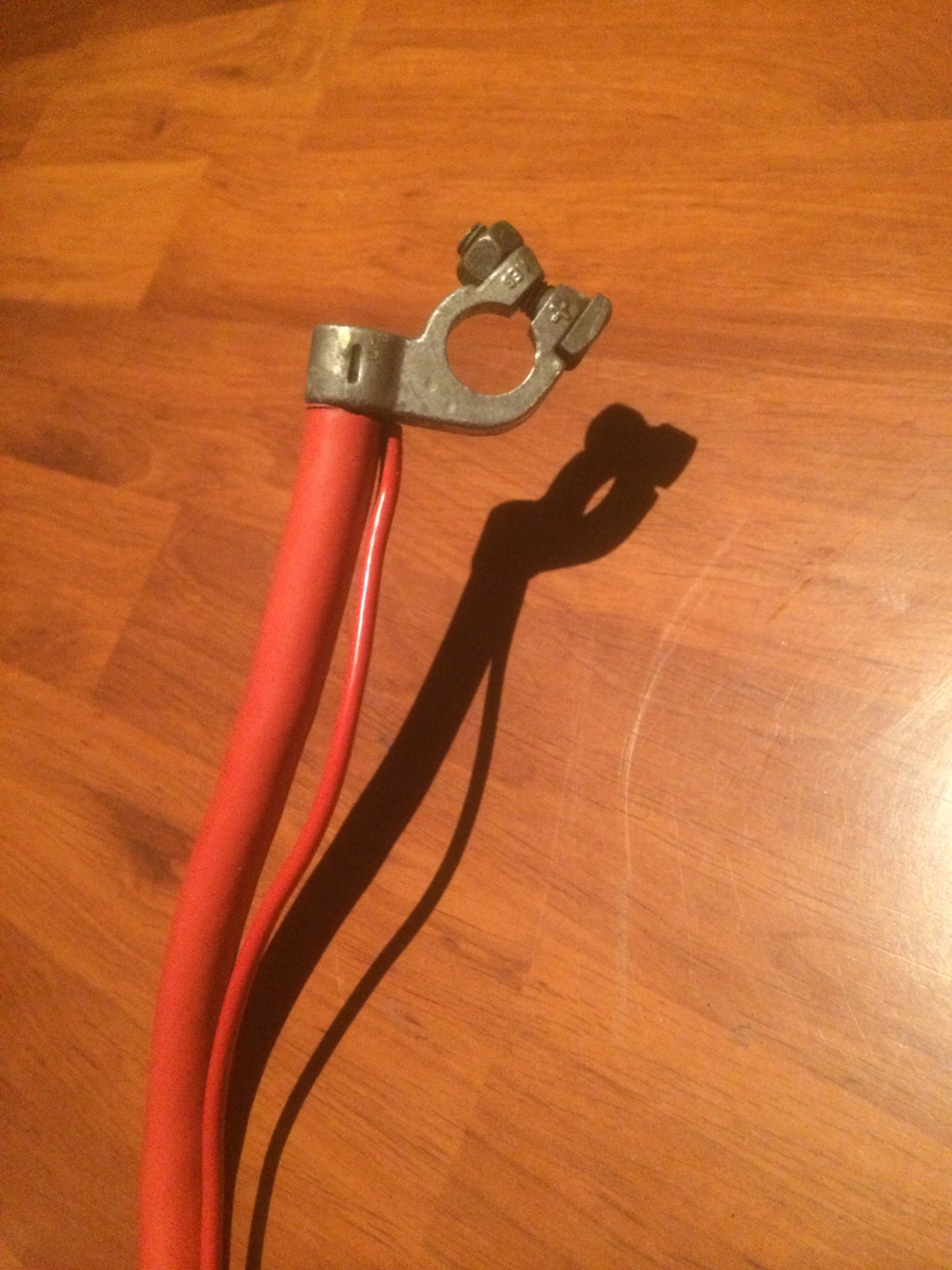

Ive been to the scrap yard today and got a good length of cable from a BMW.
Where my cable connects currently in the clio there is a fuse of some kind and both the main cable and cable to the fuse box connect here, I've attached a photo.
Can i get rid of this fuse and just connect the fuse box cable and main cable to the two new cables in the front (show in photo) and then run the cable from the engine bay to the boot and connect it to the battery in the back with the new fitting from the BMW cable?
Appreciate any help.
Thanks

I bought a junction box off eBay and connected the original bits to it and also the new cable
