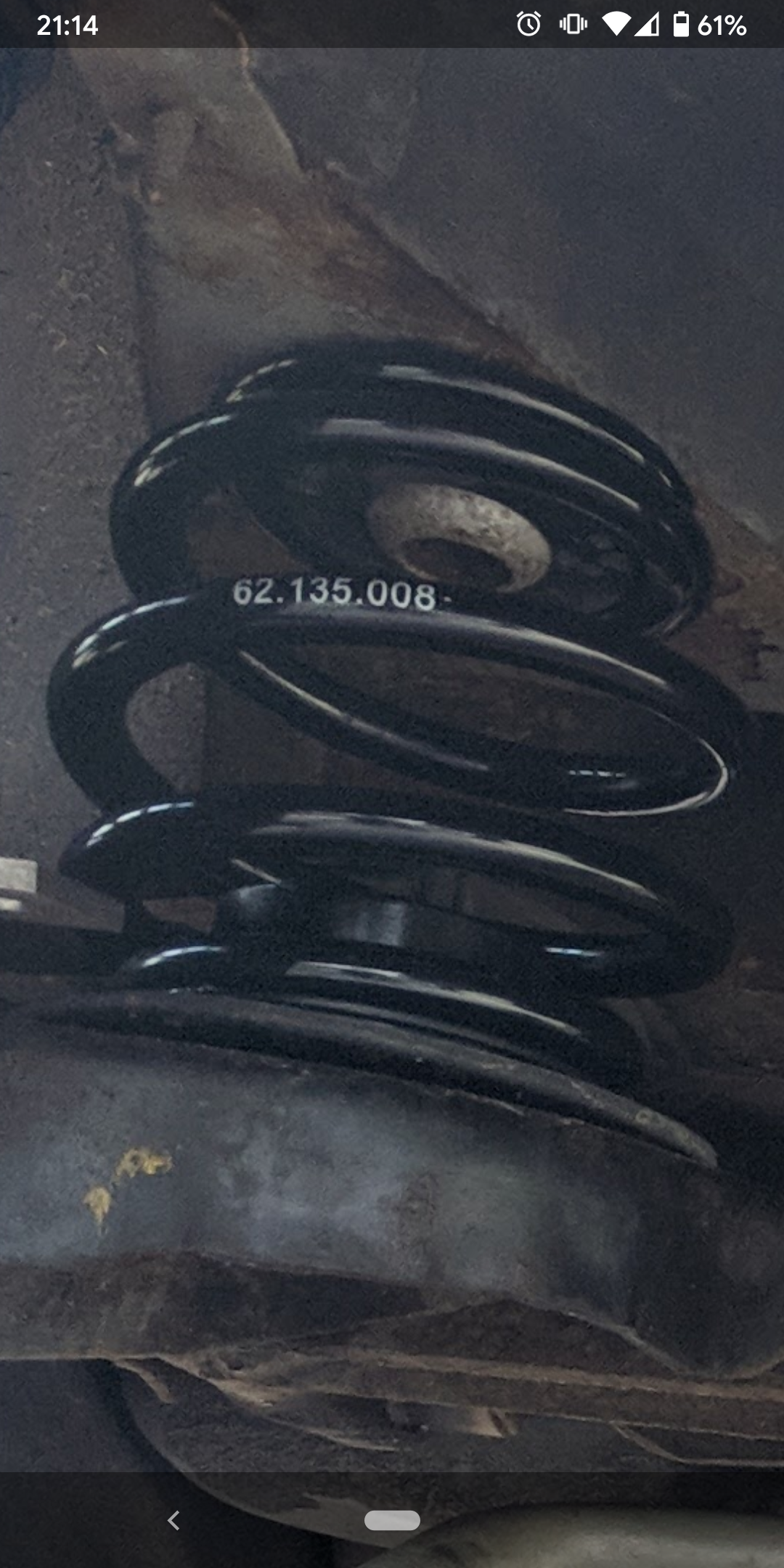

Can just about make out how mine is here
OEM rubber pad, then the spring perch with the smallest spacer ring on and then the plastic ring on top of that to stop metal to spring contact.
The rubber at the top is the BC item.
