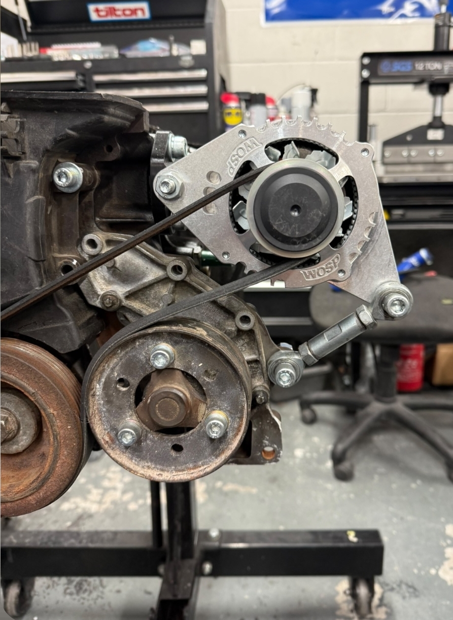

I'm not sure how it could under the water pump pulley and over the crank as the only other pulley I have is the the alternator which is mounted as per the Cup. This is how mine is set up (not my pic though):
The top part of the belt (on a standard 172 cup setup at least) goes underneath the water pump pulley otherwise it rubs the cover.
On that setup I think it's a 4pk belt that you need to stop it rubbing
