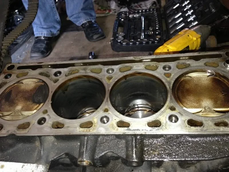

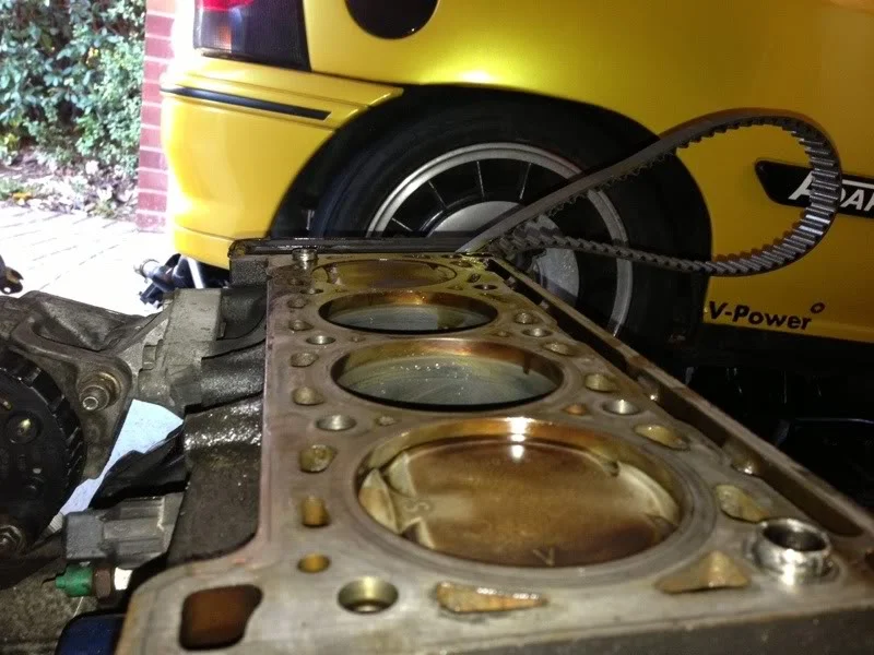

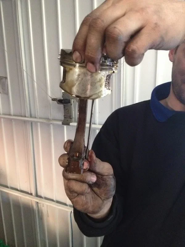

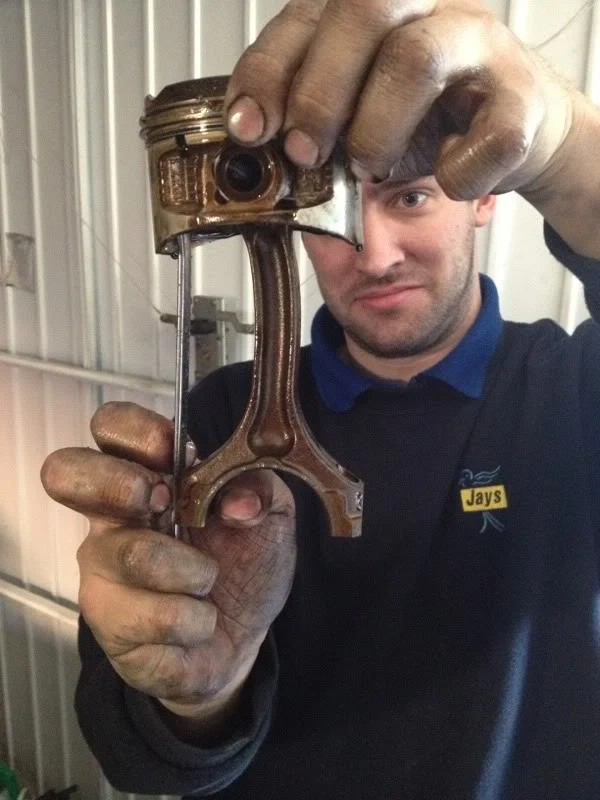

Amazed to find this, car still drove mint, still went like stink and even still idled properly, but look how bent one of the rods was when me and Danpl6 pulled it apart today!
Its actually bent in TWO directions, front to back and side to side.
Lucky it didnt snap really.

It was when I wound it to TDC and said, "Errr, mate you've bent a rod." "You sure?!" "Certain. Look." "Oh yeah."
When you said it was bent I was just about to grab some feeler gauges to check but as I glanced over it was certainly pretty obvious you were right. Lol.
