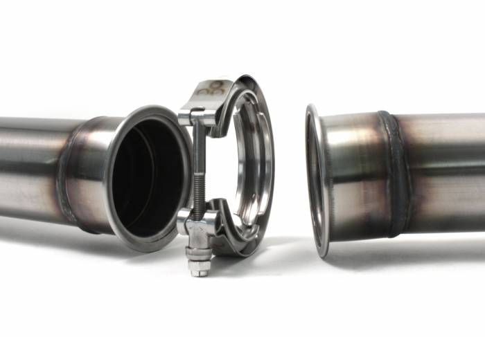

This is a v band clamp
I presume the best bet for a vband is through a proper exhaust place or someone who can use TIG, rather than messing around with MIG. What sort of price would I be talking for one of those to be fitted?
will be fine with mig.
What diameter would i require for the manifold? And doable whilst on the car?
not sure on the size sorry. can do it on the car but just a bit fiddly welding around the top, if you want you can unbolt the manifold from the head and drop it back and down, that weill give you more room around it.
Do you not need some sort of flex though? What with the springs of the fitting kit being missing in a V band?
I thought this as no matter how hard I try, I can't get a good seal on the mani to cat joint.

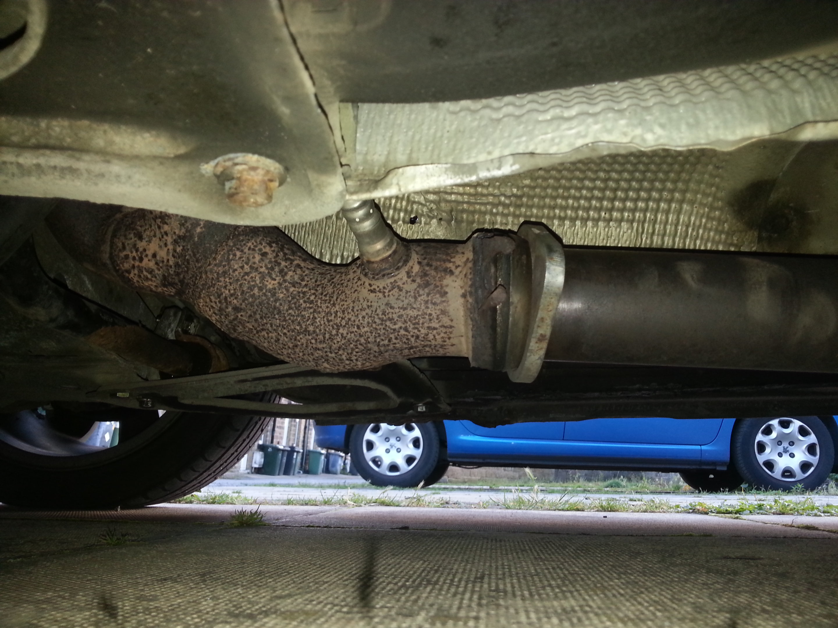

A pic of my flange:
You can kind of see how it's almost twisted on the bottom one. I think I'll get it on axle stands this weekend and make some sort of brace from some 3mm steel and buzz that on. Grinder will soon sort out that rust
Just as I thought, it's bent because of the rust.
Either do what you've just said or replace the manifold with a non rusty one. Is it a 172 mate?
