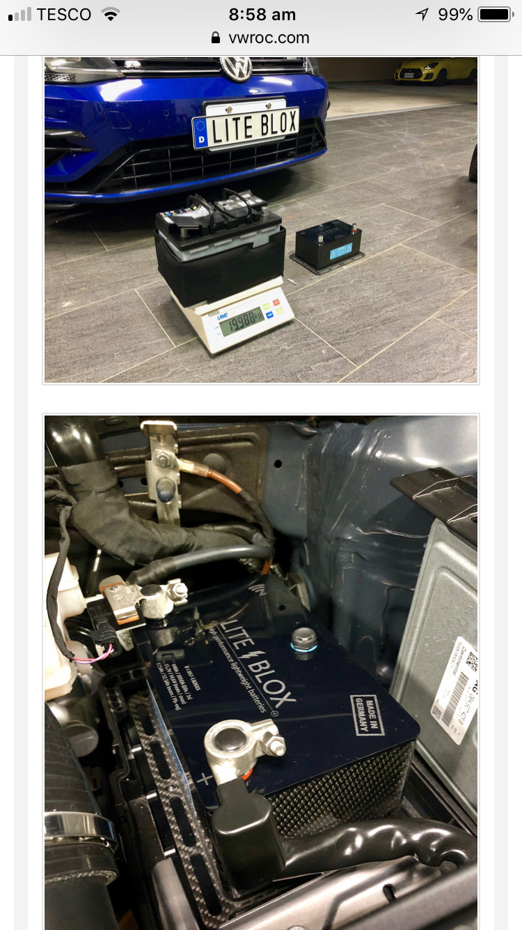

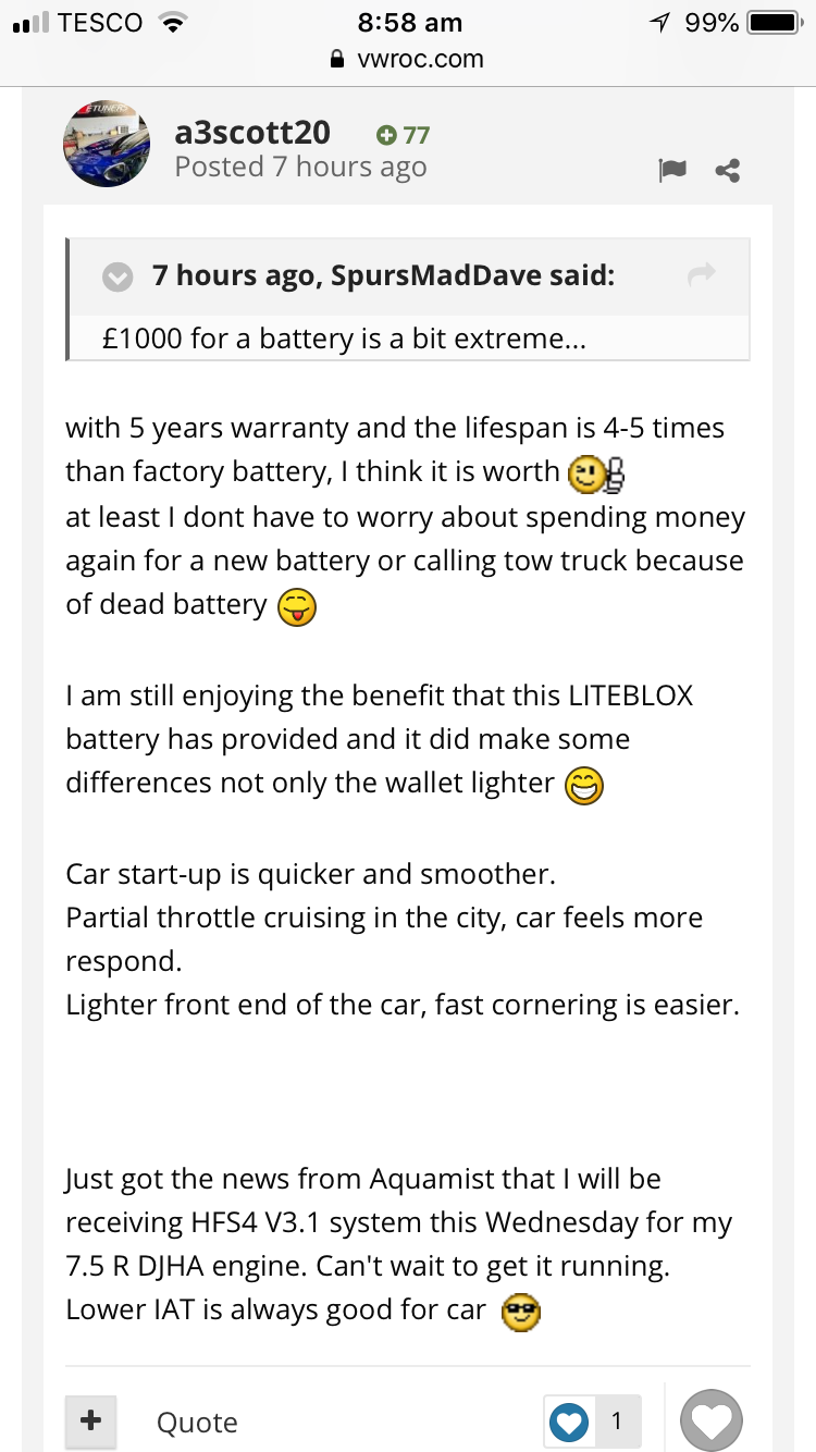

Shall also probably fit a lightweight battery, if Renault claims are true of 1021kg, then saving around 10kg from exhaust and around 15kg from battery will put car around 990kg. :)

I don't buy those, too expensive.
I buy from anti gravity batteries, stuff like this:
https://www.antigravitybatteries-uk.co.uk/oem-case-type-batteries/AG-ATX20.html
I have that in my M3 track car which also gets daily driven and left parked for weeks at a time, always starts with zero issue and the battery weighs around 2kg, I got it for £400. :)
I shall probably put it in the Clio to test fitment and if it fits well, probably grab another or one of the slightly less spec versions for around £300.
