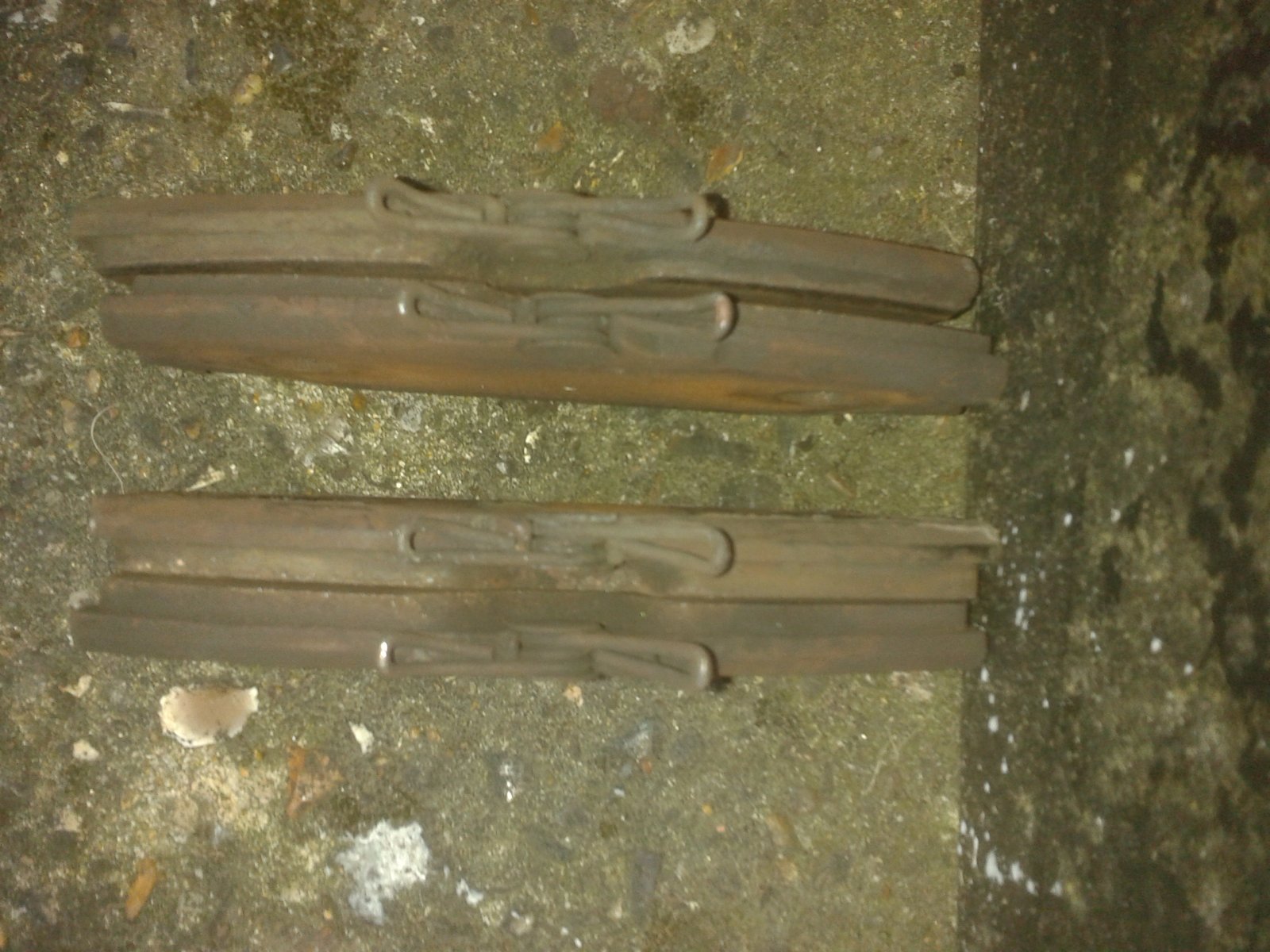

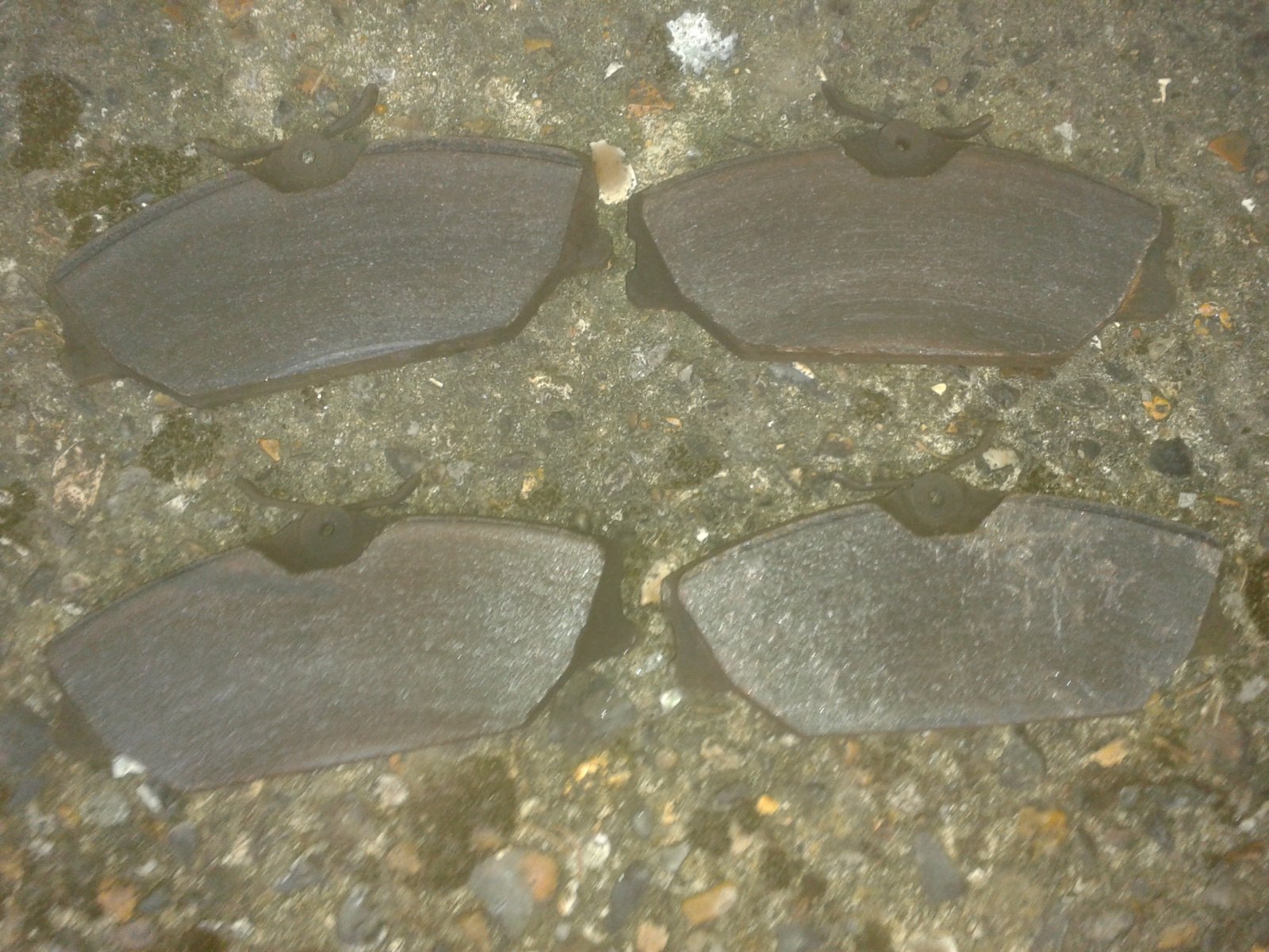

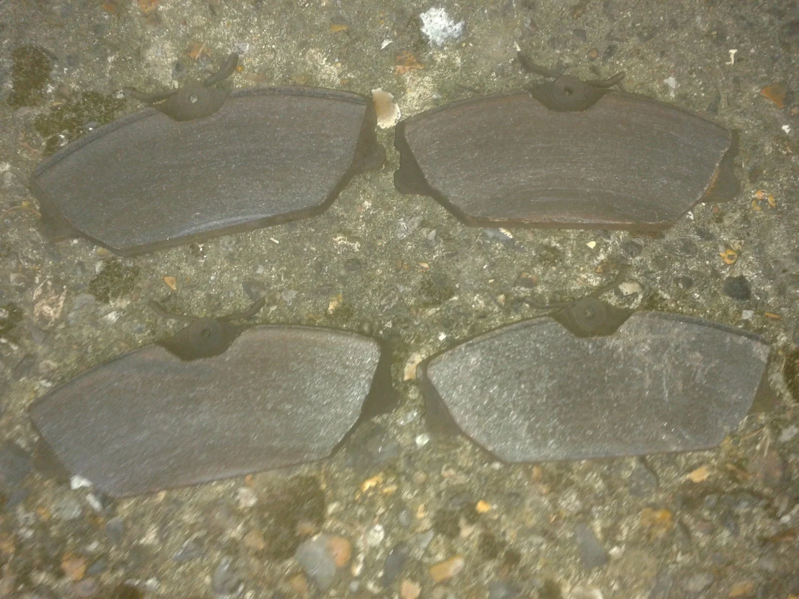

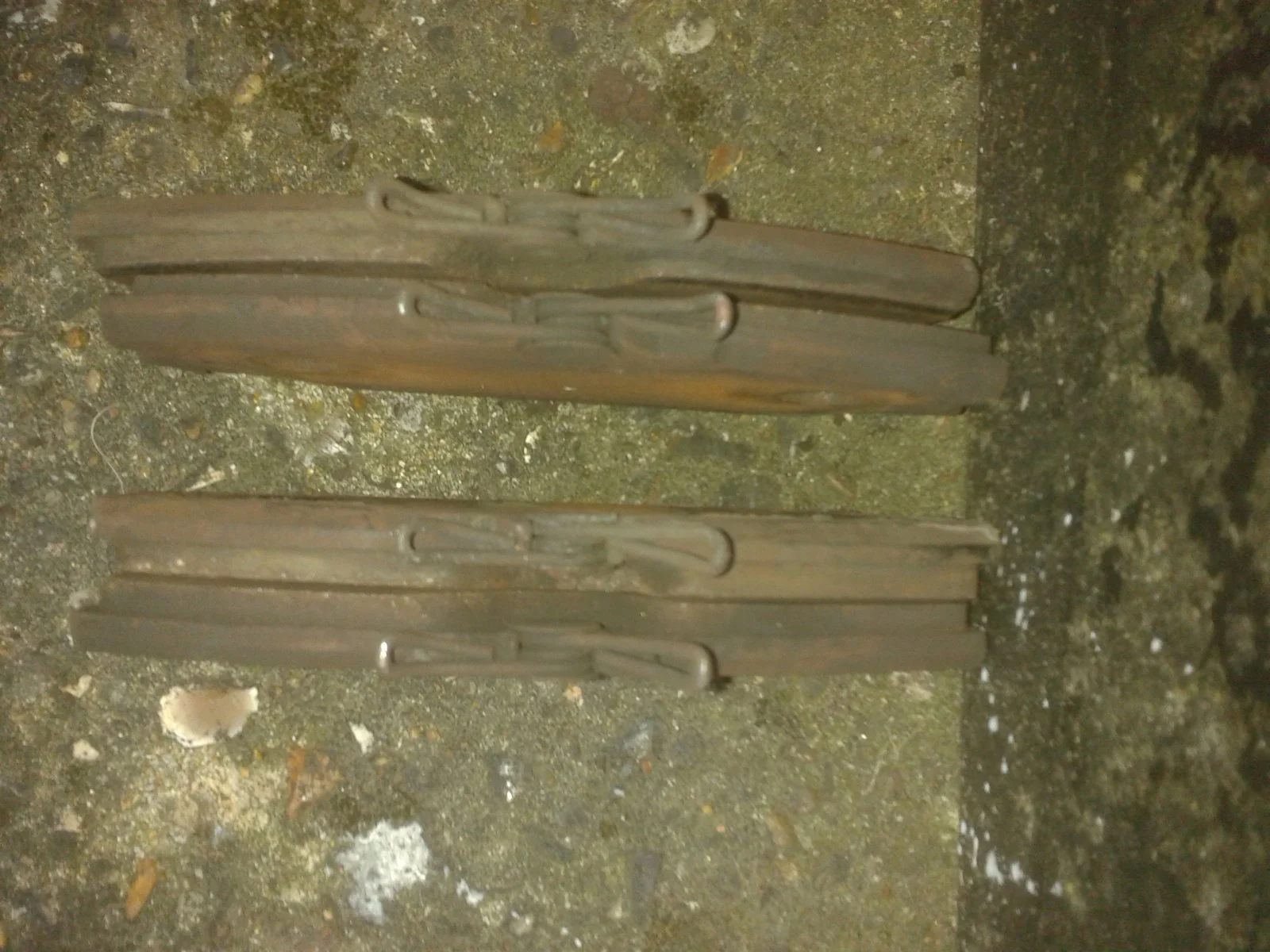

Some Brembo`s I replaced after 16K of use. FRONT BREMBOS AT 16K 2016-03-22 17.37.37.jpg FRONT BREMBOS AT 16K 2016-03-22 17.38.32.jpg FRONT PAD NUMBERS 2015-09-17 15.55.00.jpg
