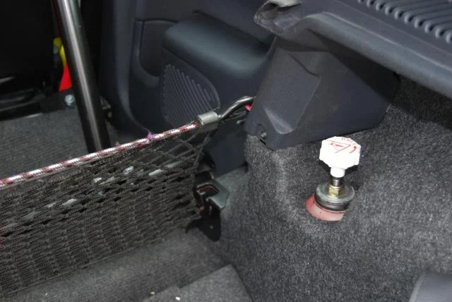

The Sach's units have been un-pinned giving 40 possible adjustments. They are set on 20 clicks from the factory.

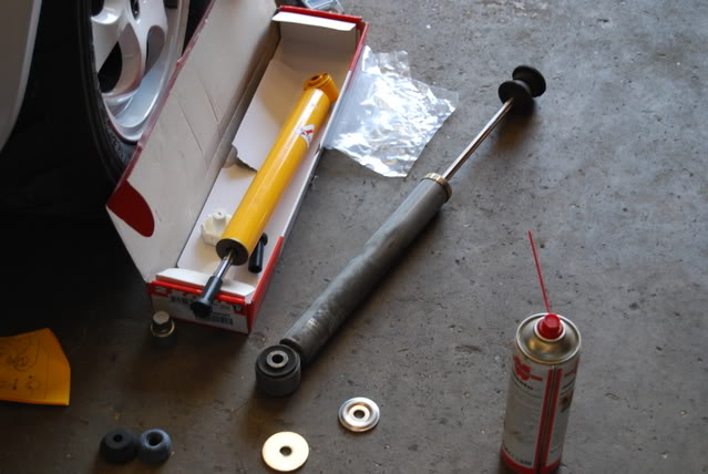

I've have also upgraded the rear shocks with a set of Koni's that Mark Fish has had re-valved to better match the fronts (the standard rear Koni's just don't go hard enough).
They performed great at Brands recently. Next up is top mounts for me!
