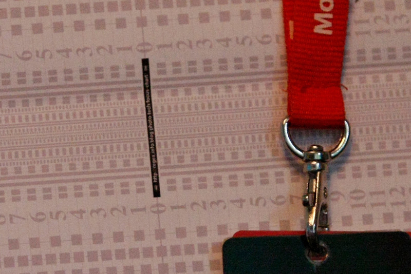

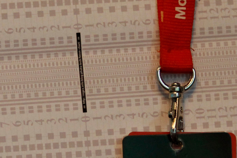

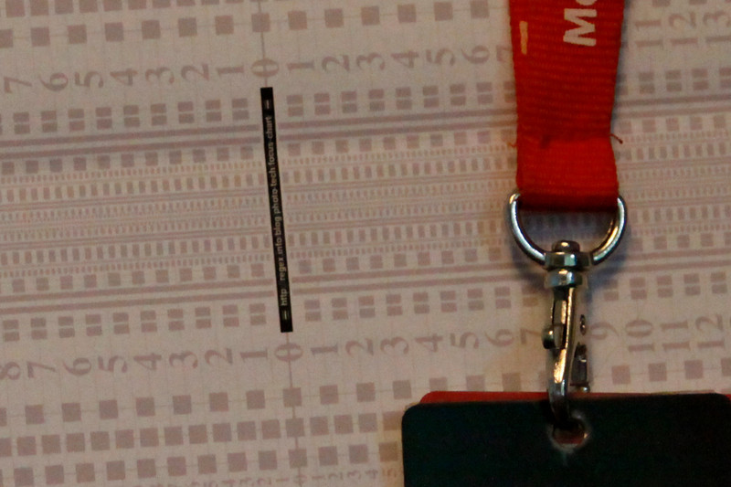

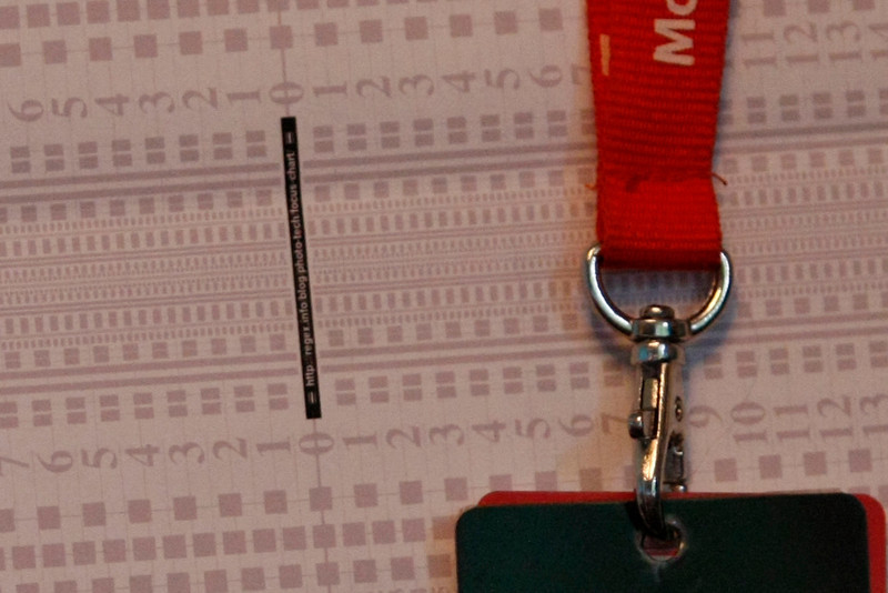

Well im pretty bored, so ive done a quick comparison. Same settings, taken on a tripod etc... (both cameras have all noise reduction features turned on as i use them like this...)
I will say my feelings are that pixel for pixel the 40d is sharper, however its noise handling is worse, albeit it seems to pick up a larger colour range at high ISO than the 50d, but then cant display these colours without noise in them. (the red part of the strap in the 3200 photos)
For what its worth i actually find the AF better on the 40d. And if i didnt need the higher ISO expansion of the 50d i would have simply bought another 40d. So i am in no way biased towards the 50d, if i felt the 40d was better at handling high ISO i could of saved £200-300
40d ISO 1600:
50d ISO 1600:
40d ISO 3200:
50d ISO 3200:
Im unsure why there is a difference in colours between shots, both cameras have had AWB, factory colour spacings, and Adobe RGB used.
