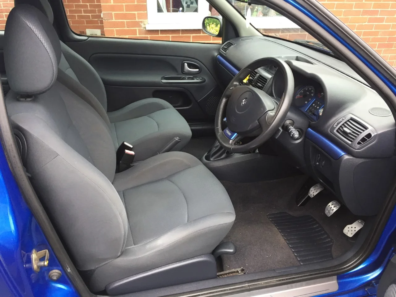

  • Unmarked interior, it is spotless inside

  • No wear to steering wheel thumb grips or seat bolsters

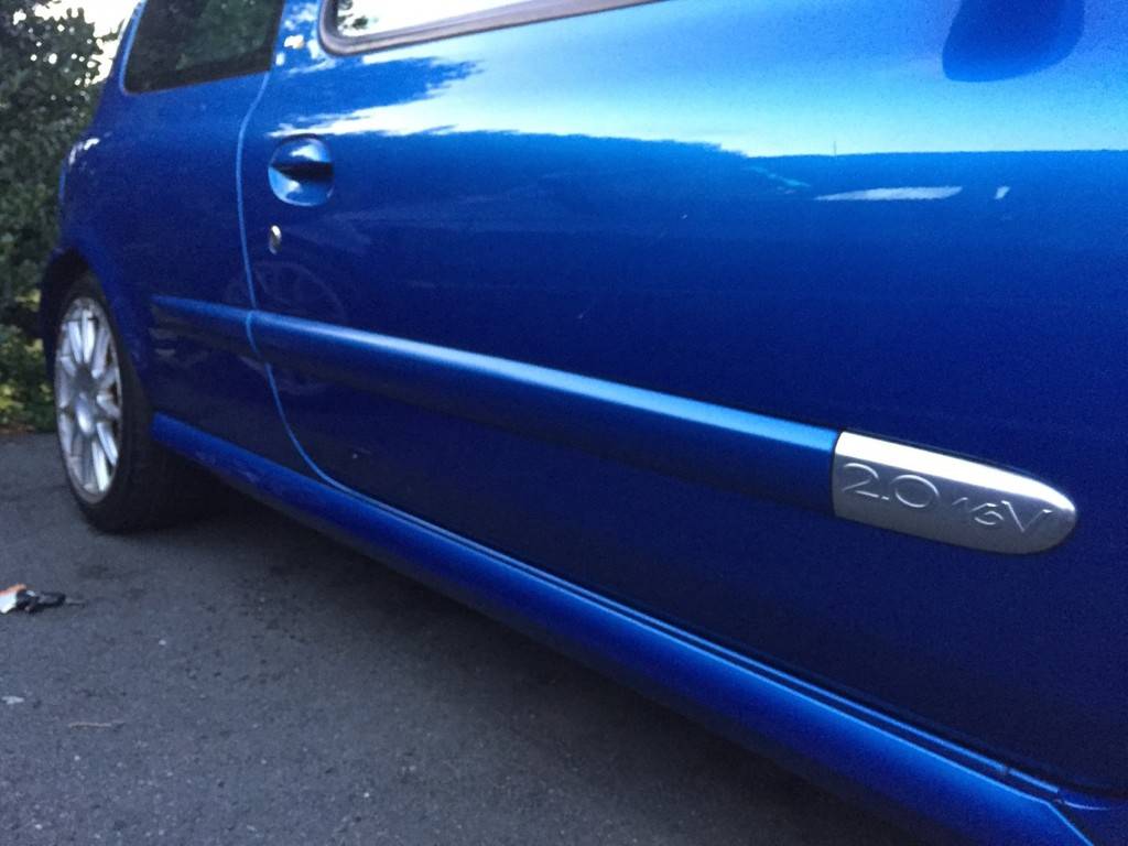

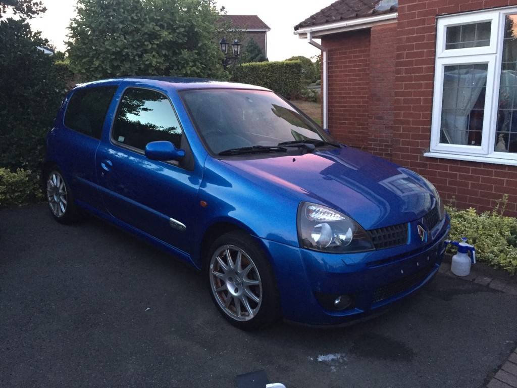

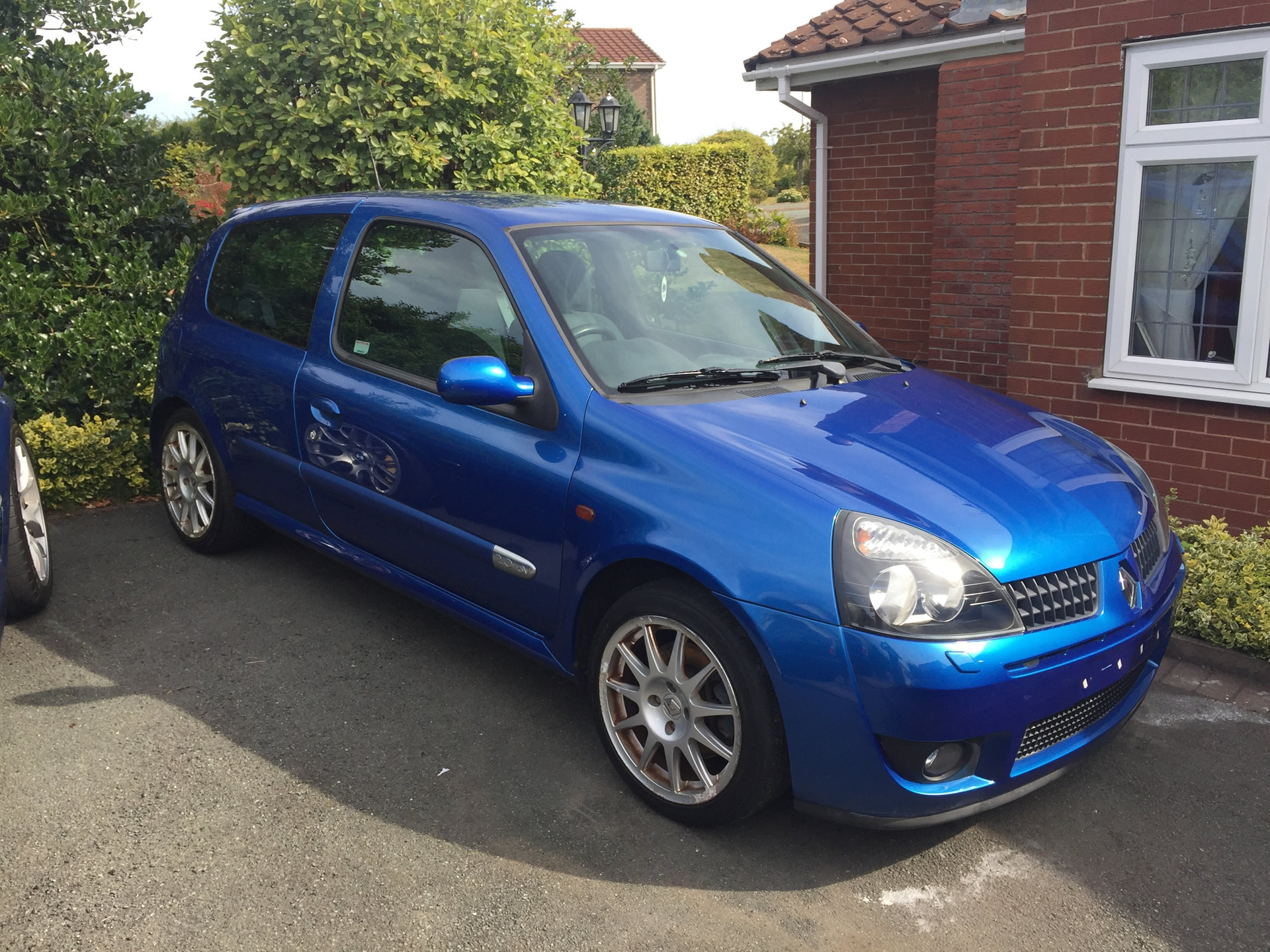

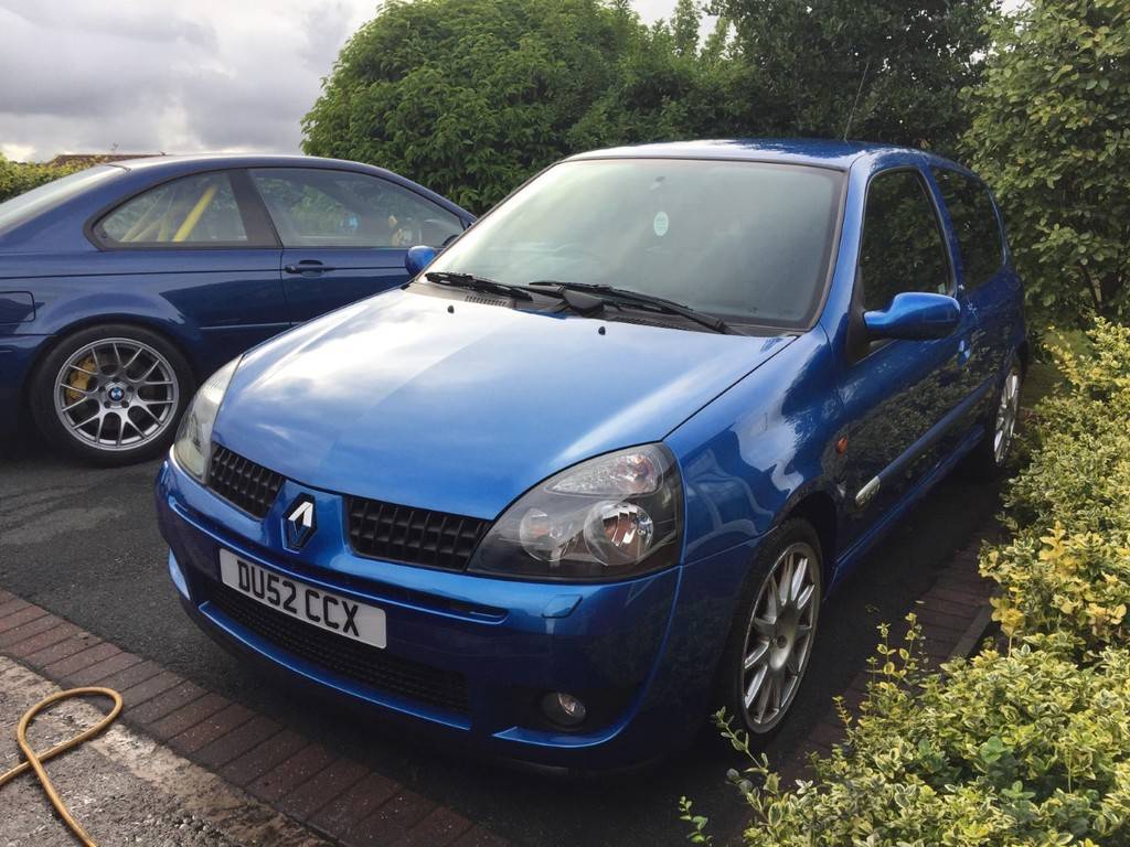

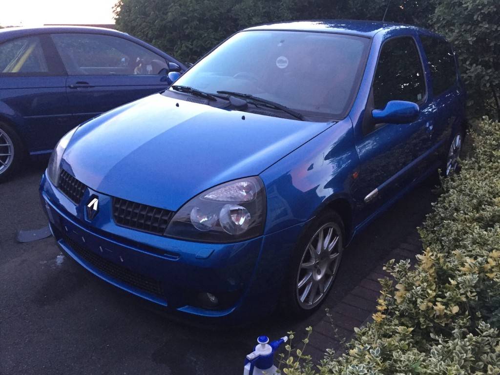

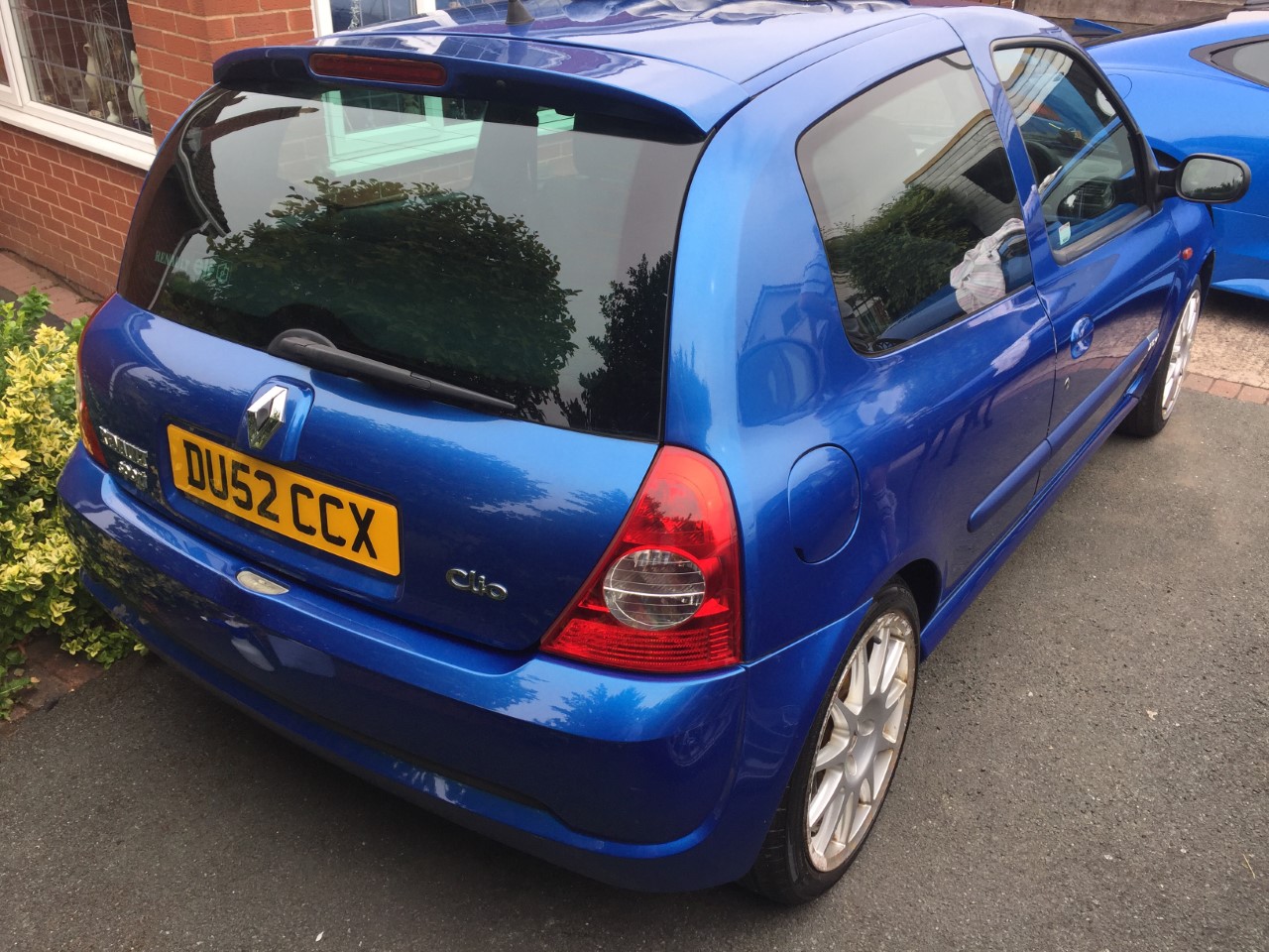

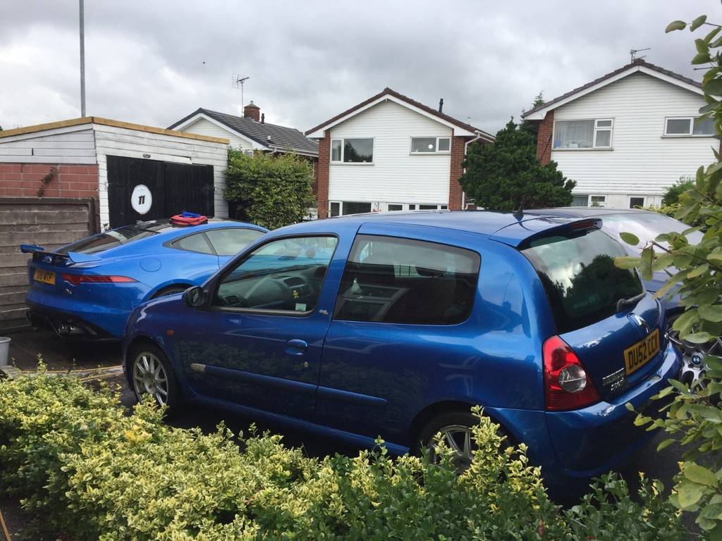

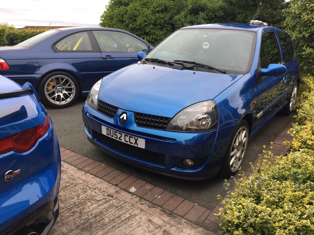

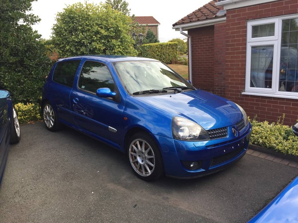

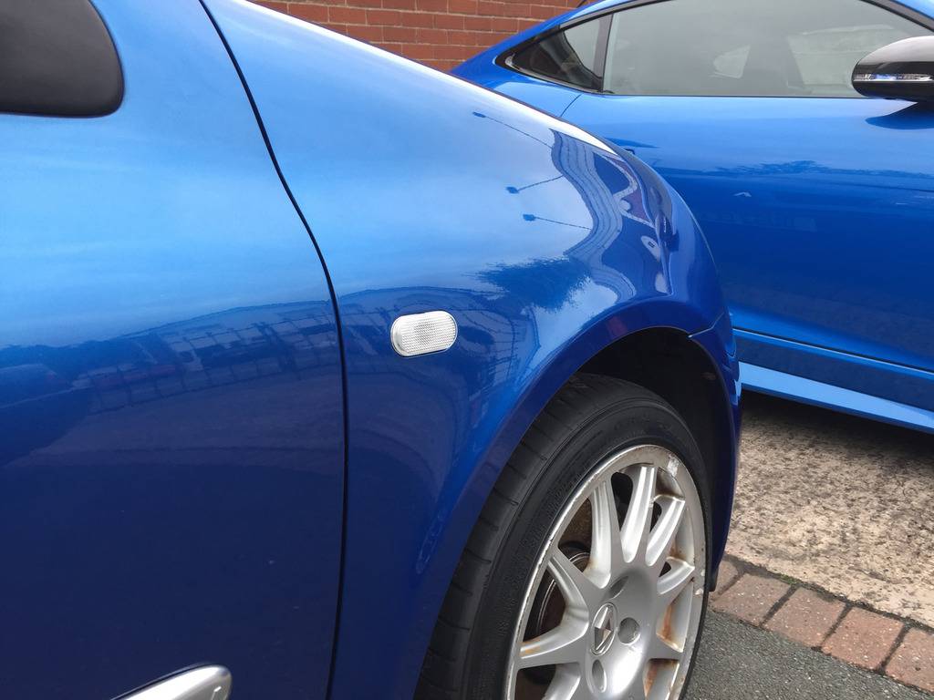

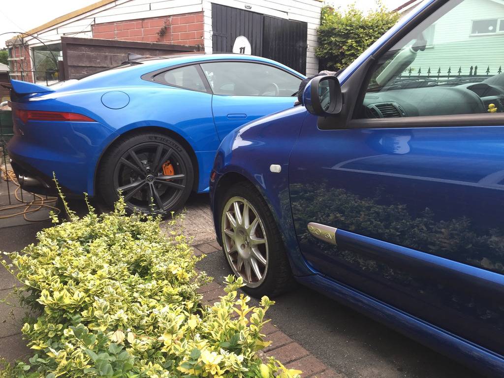

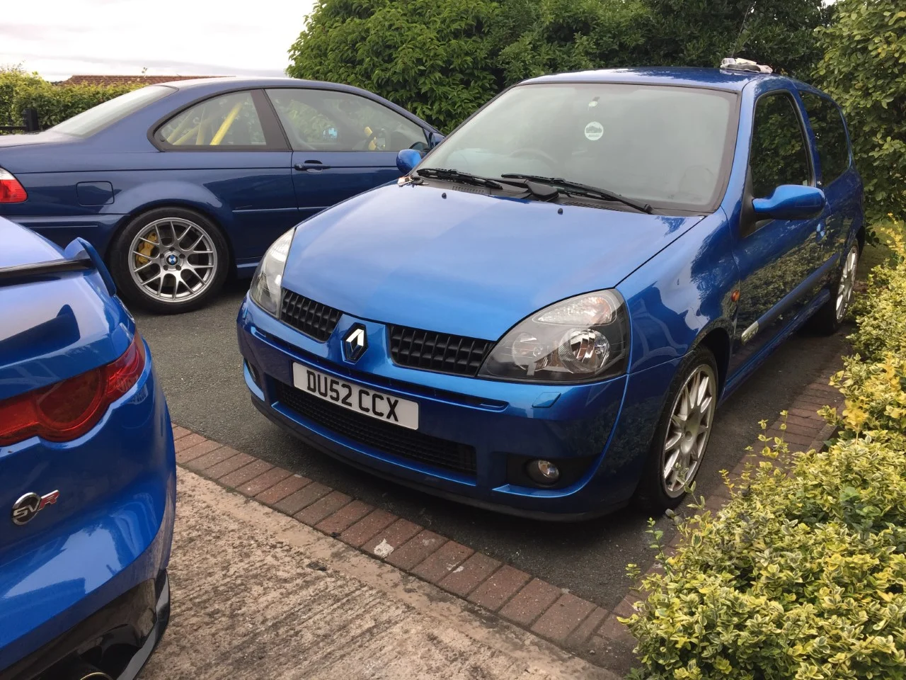

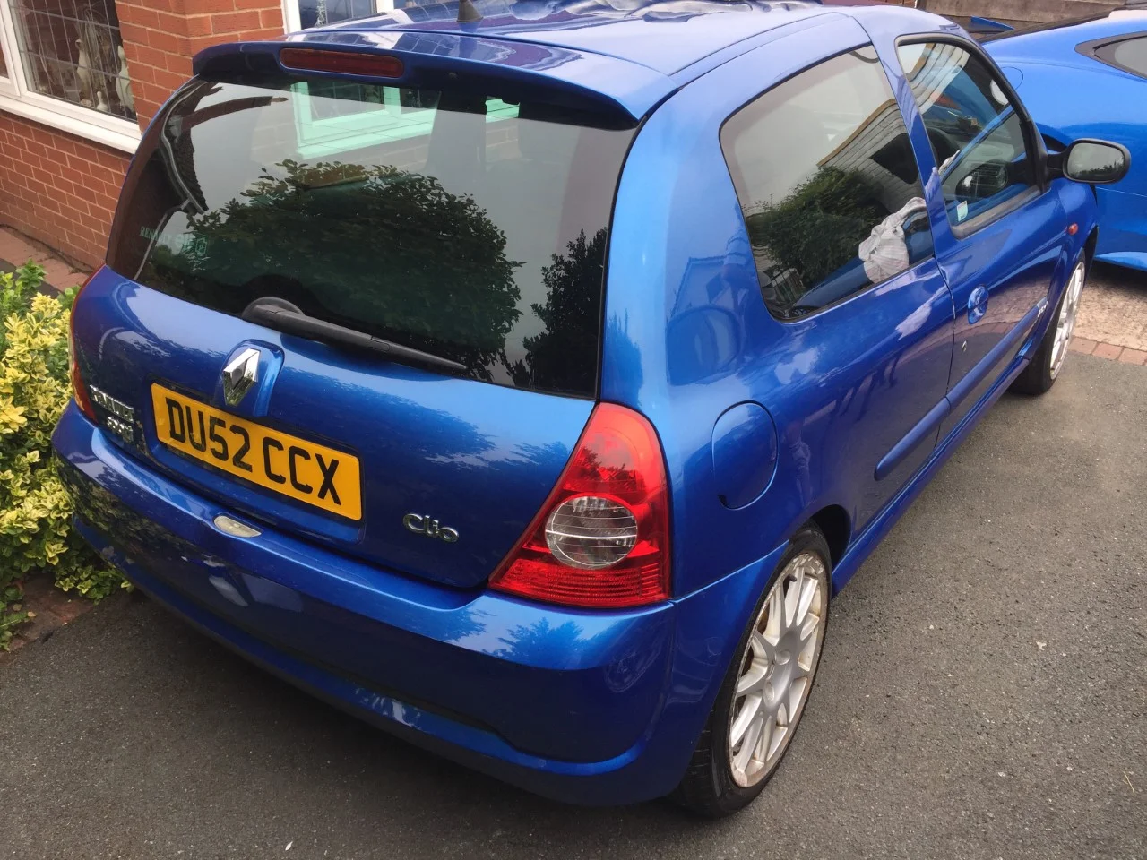

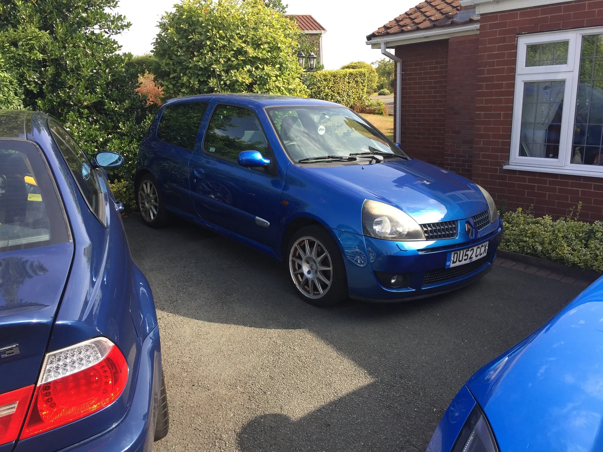

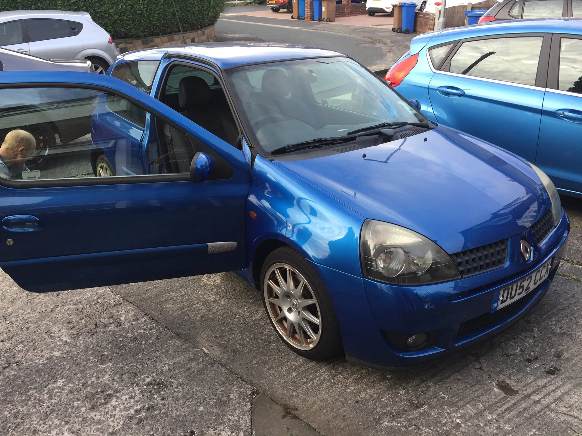

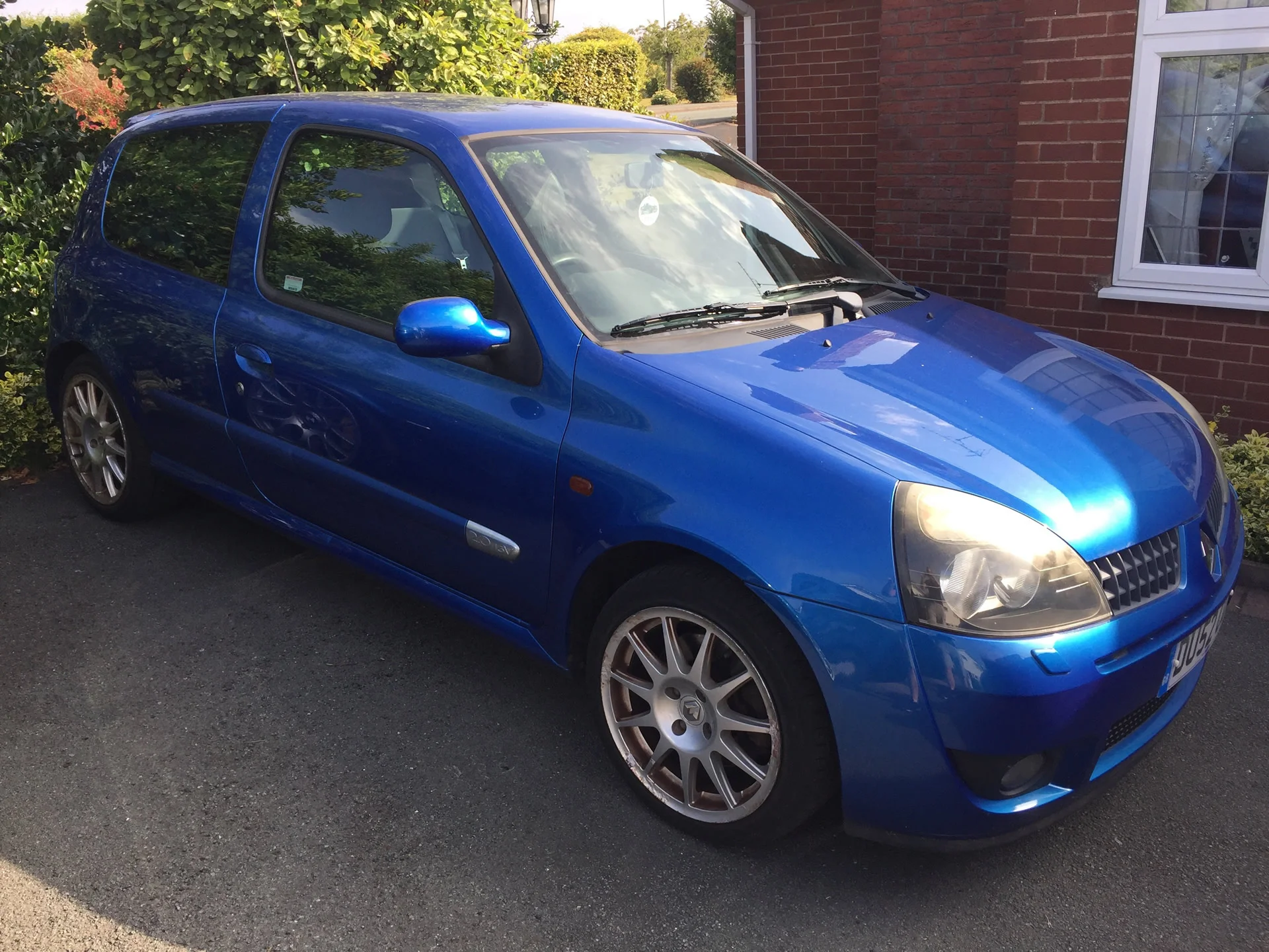

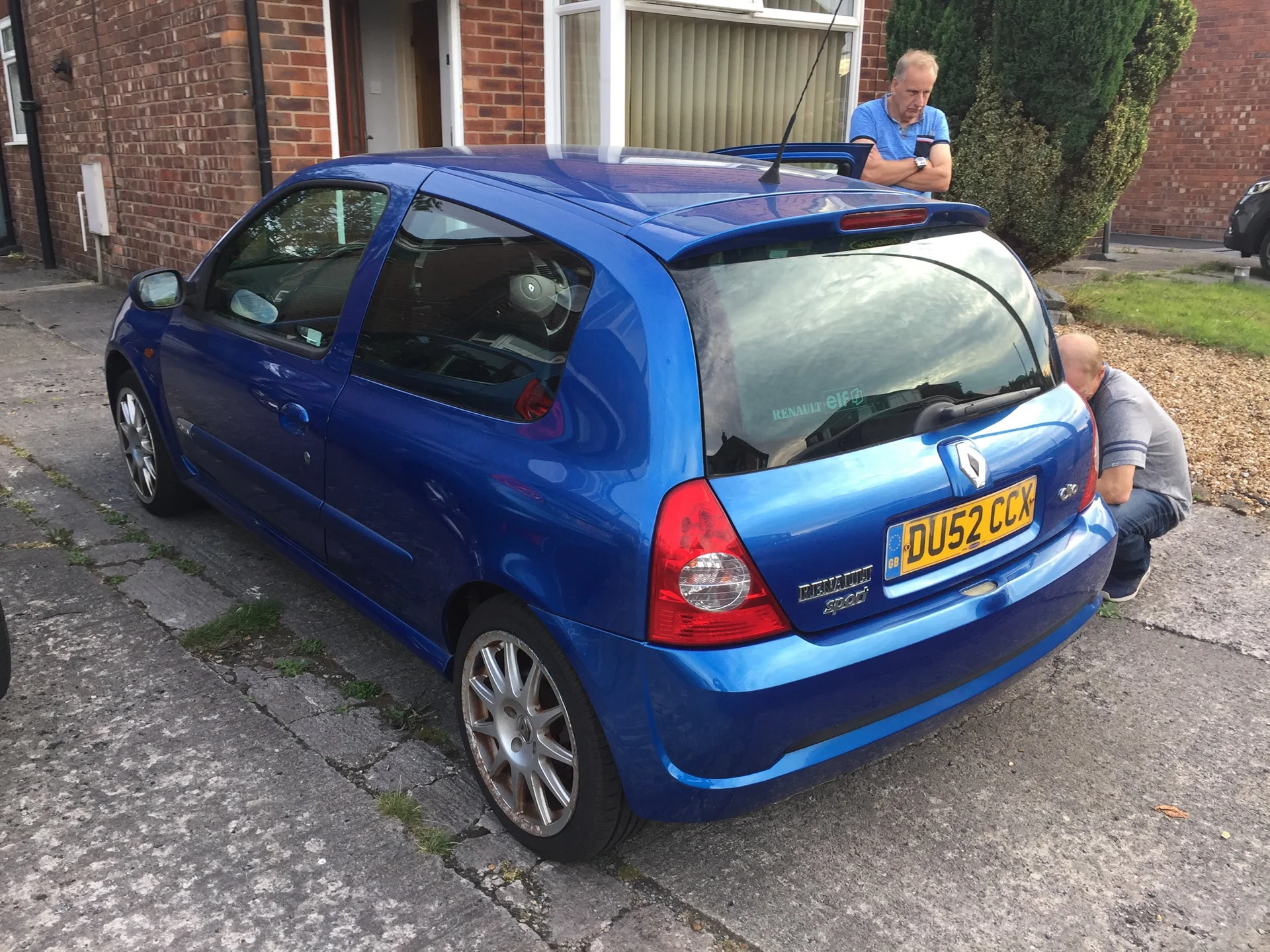

Got it home, took a few pictures:
So yep three blue cars on the drive way, not that you have much choice with a 172 cup as they only came in blue and silver with silvers been under 70 left on the road.

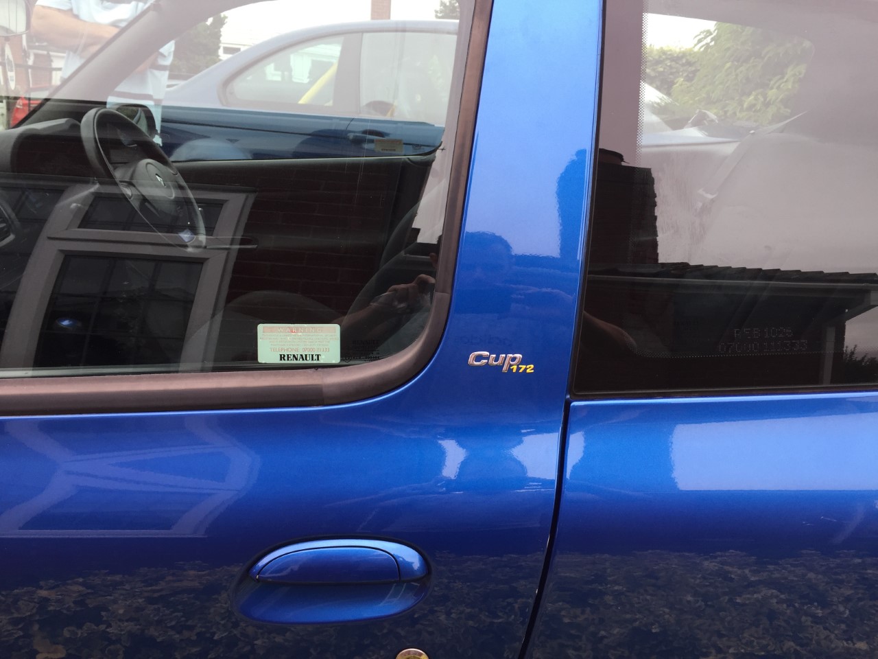

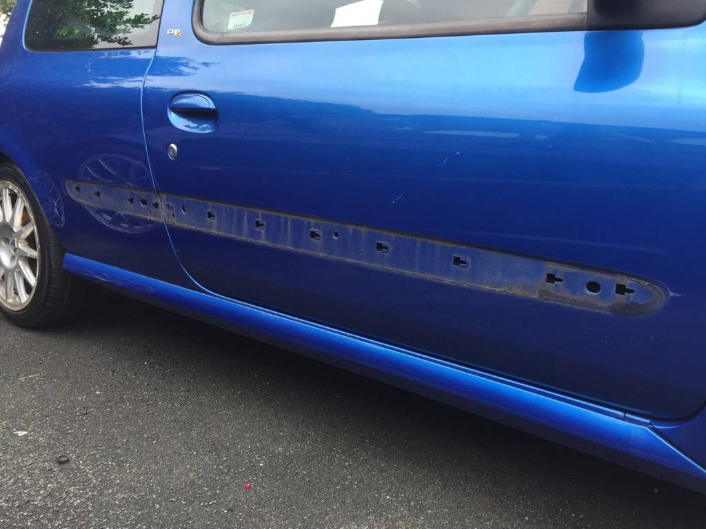

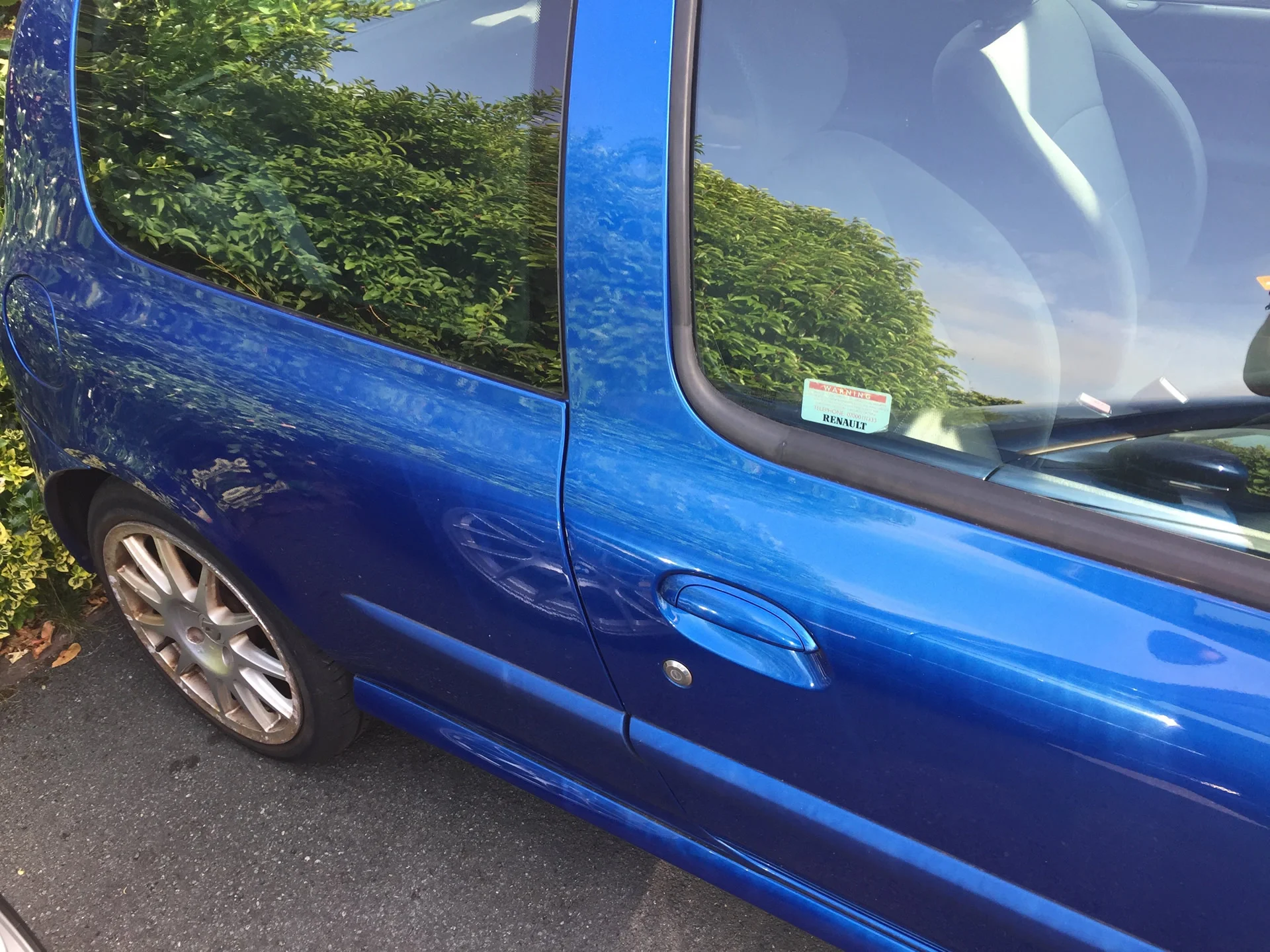

You can see the original Renault window stickers still present (I shall probably leave these as adds to the originality of the car) and the paint missing from door edge and of course the shocking condition of the tyres and clouding of the head lamps.
That is where the car shall stay now for a week or so until it is booked in for its belts, pulleys and full service, plus some restoration work.

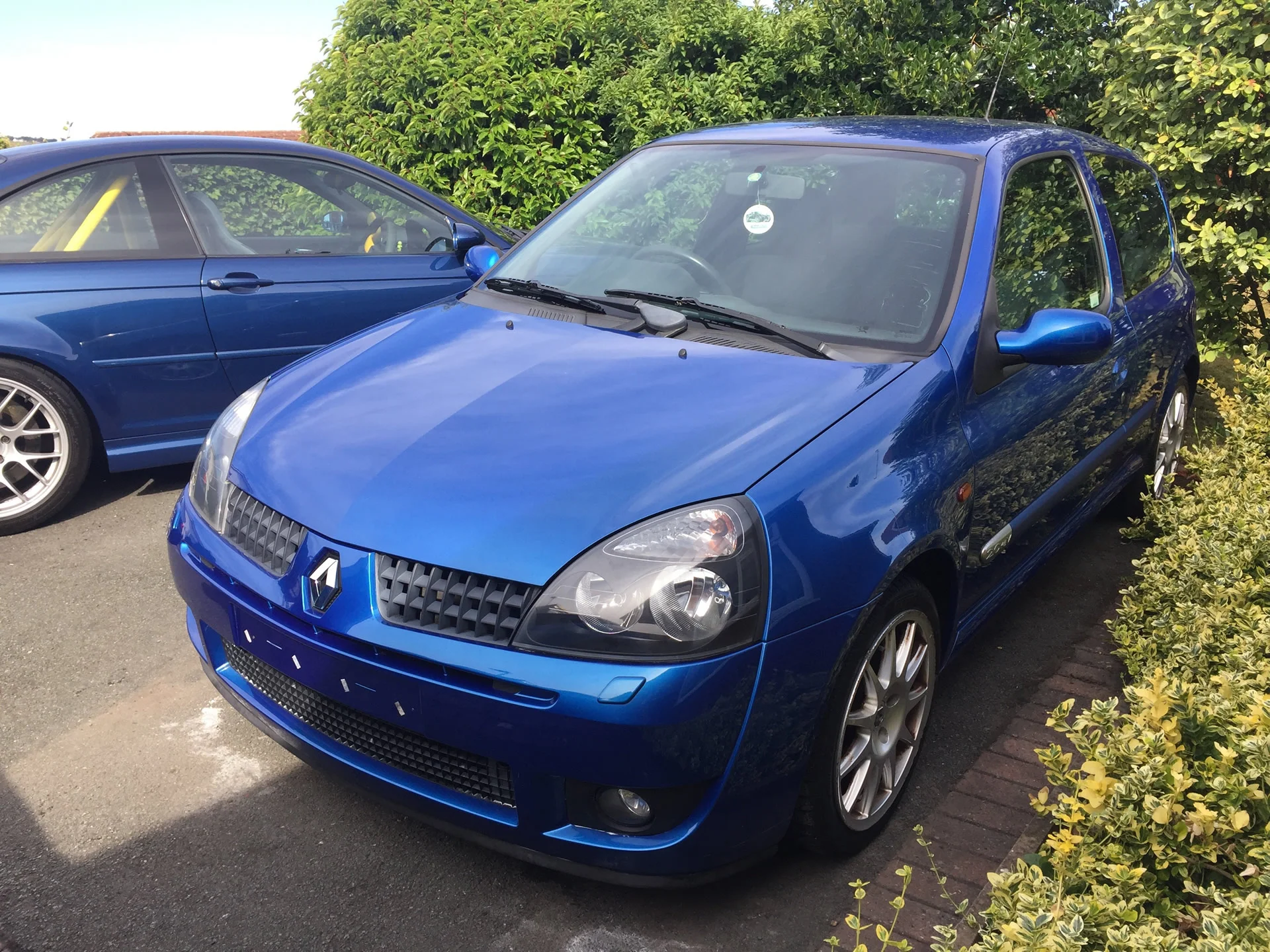

So as I said I got the car a few days ago and posted this up on my primary forums which is Overclockers UK forum in the motors section.

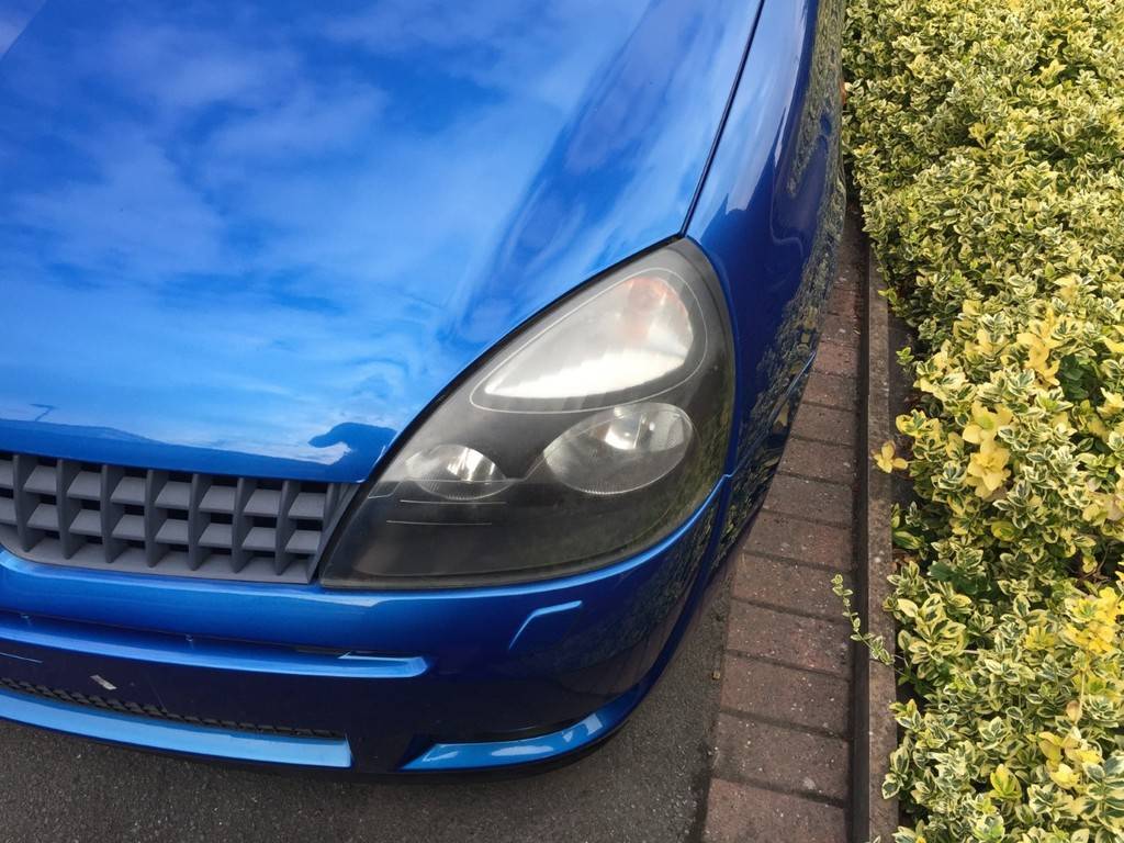

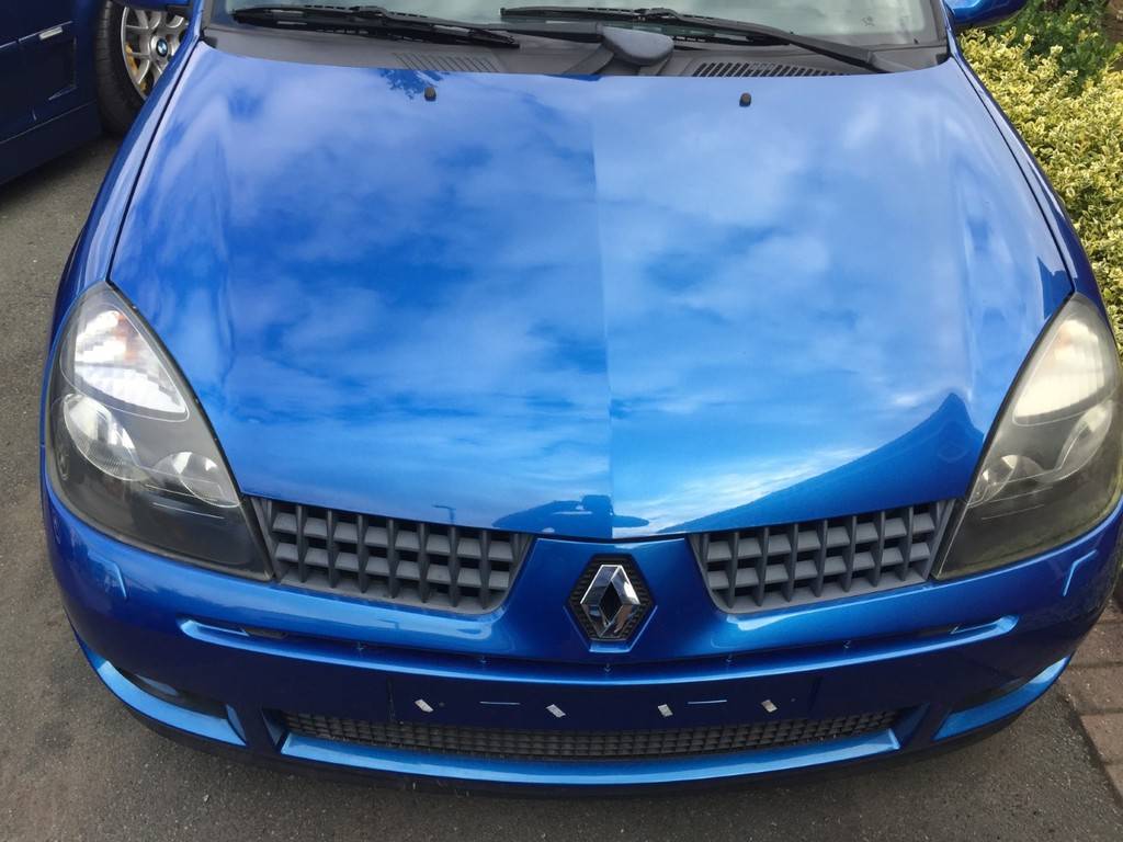

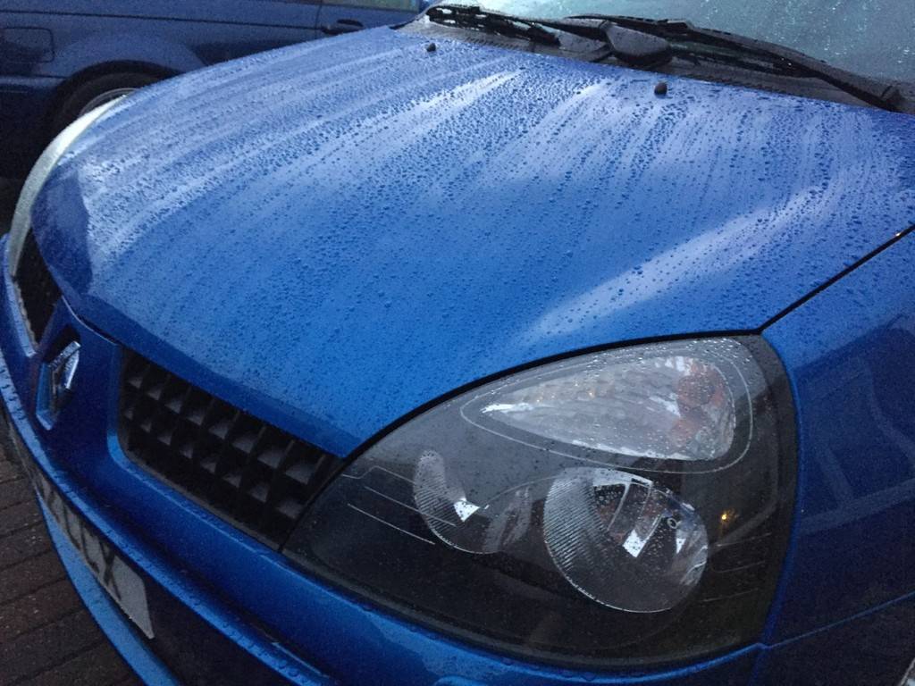

As such first step, fix the headlights!

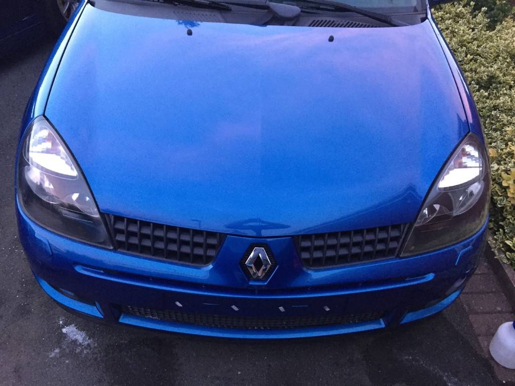

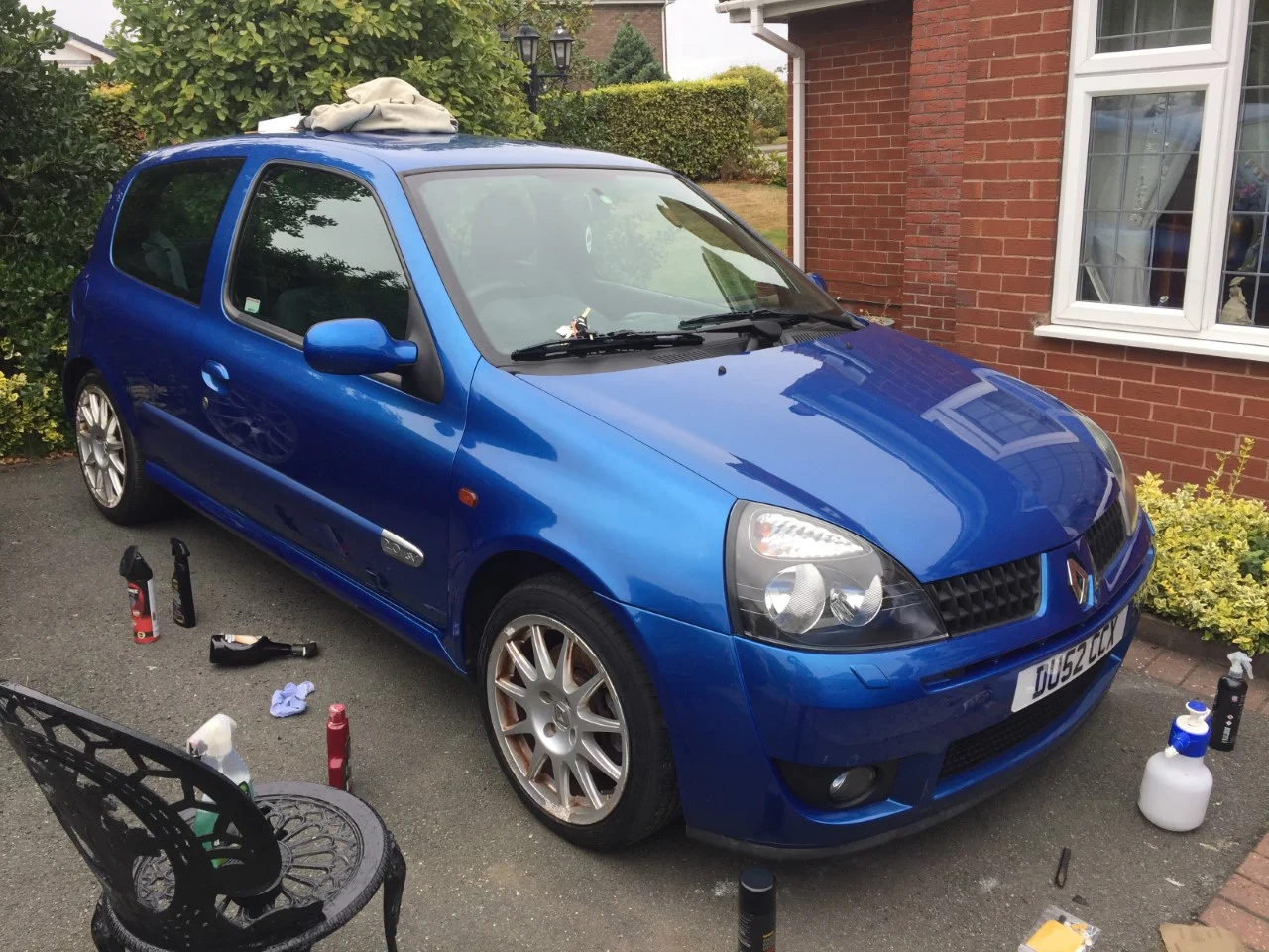

So yesterday removed old scabby plates and all washed yesterday along with arches cleansed and tried a quick polish on drivers headlight, came up quite well but not perfect, plus a quick hoover inside:

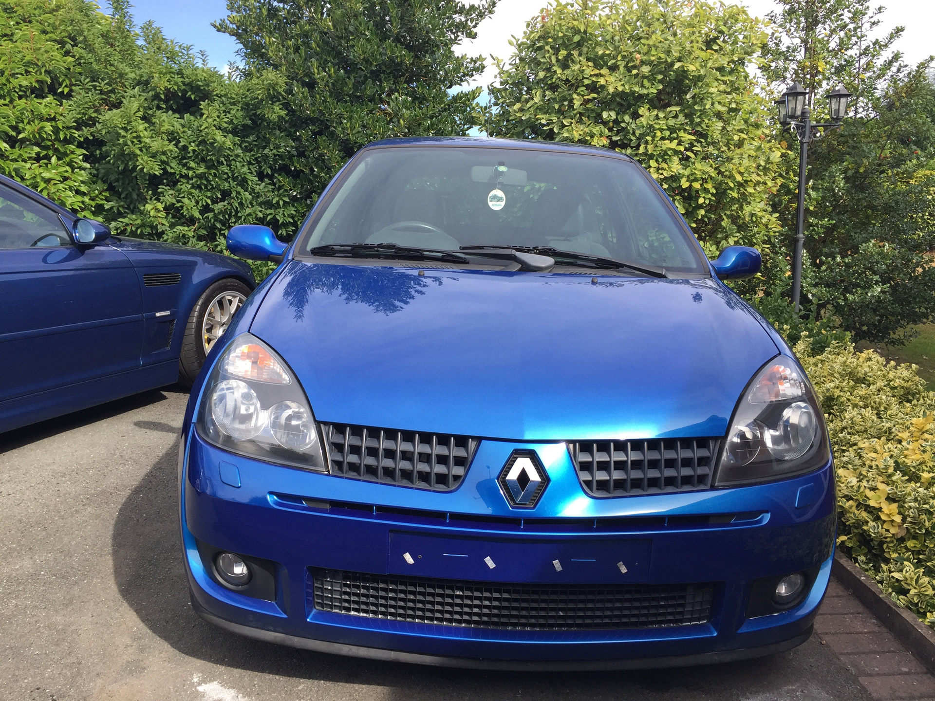

So tonight a bit of wet and dry, polish and wax for the headlights to properly restore them:

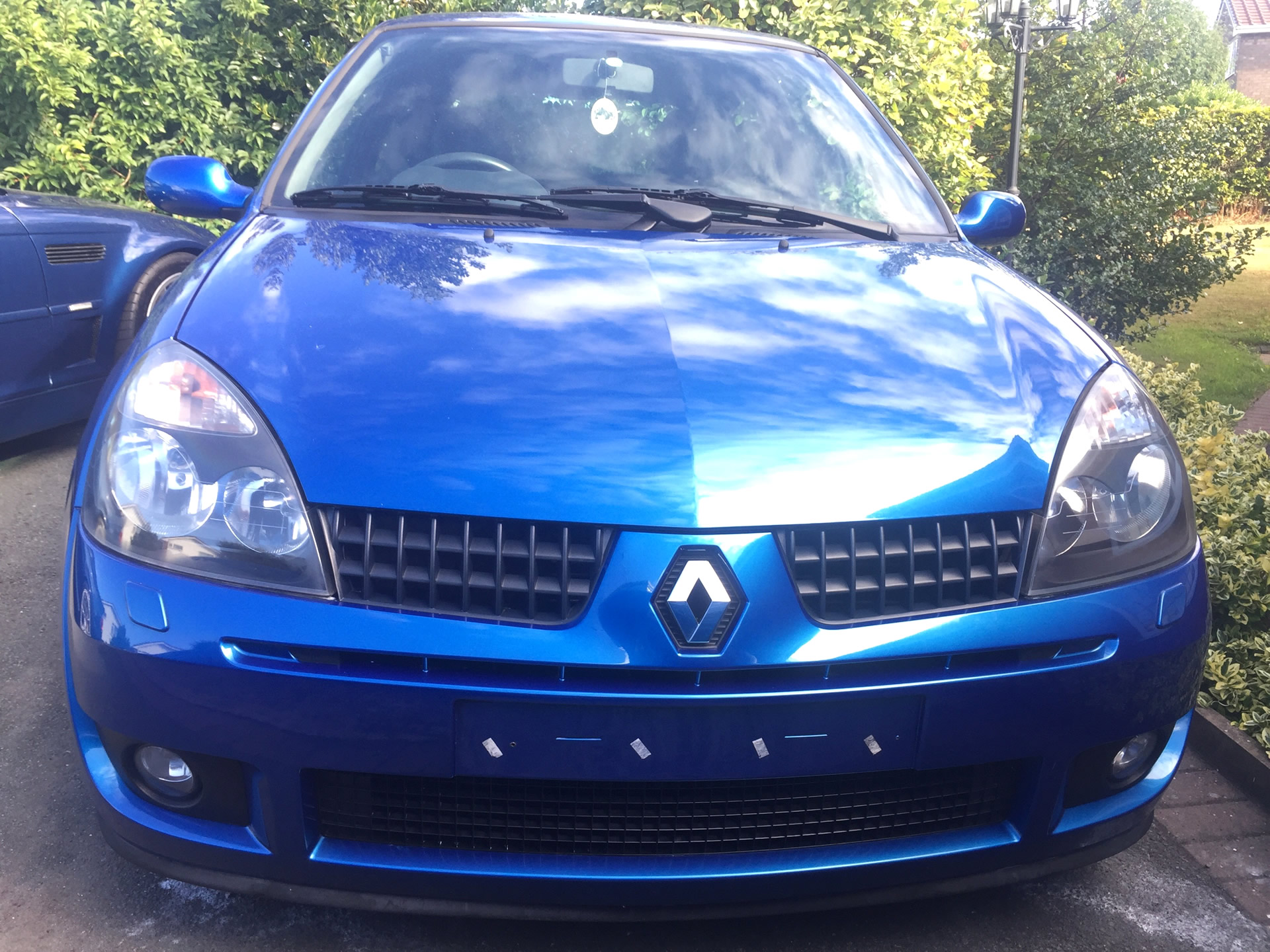

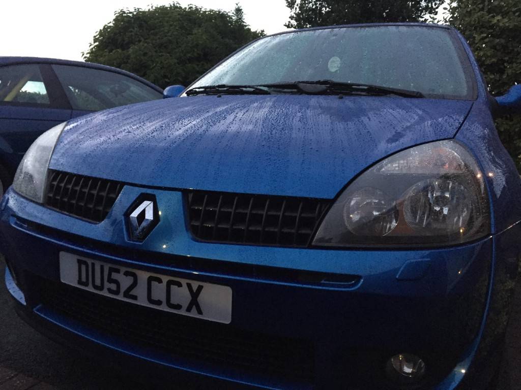

Before (drivers side already polished):
After:

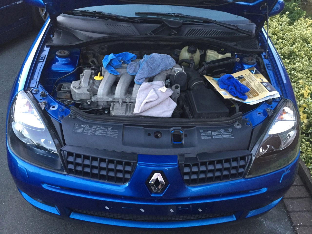

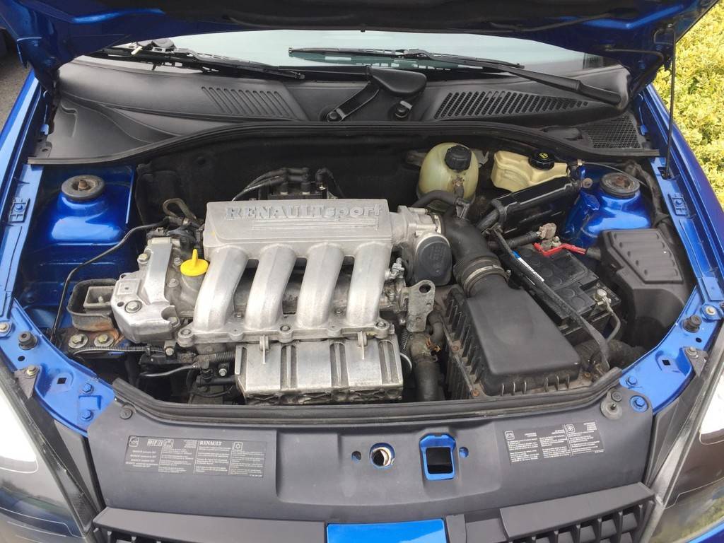

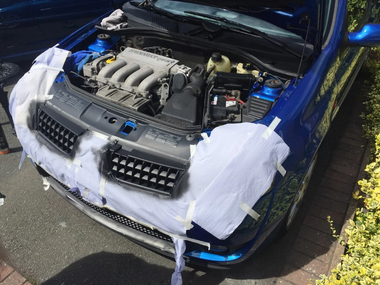

Also spray some brake cleaner around the engine bay to get rid of grease, oil and dirt, plus a quick wipe over, by no means a proper clean:
Very happy with results on the headlights, in person its a dramatic improvement. :)
Some better pictures I took this morning, a really nice improvement:

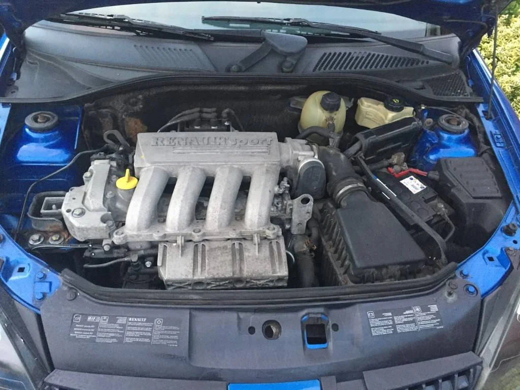

So some further updates and questions:

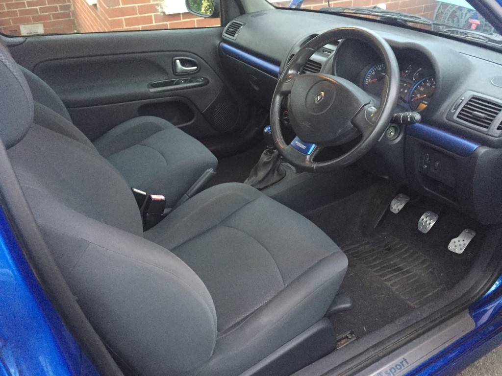

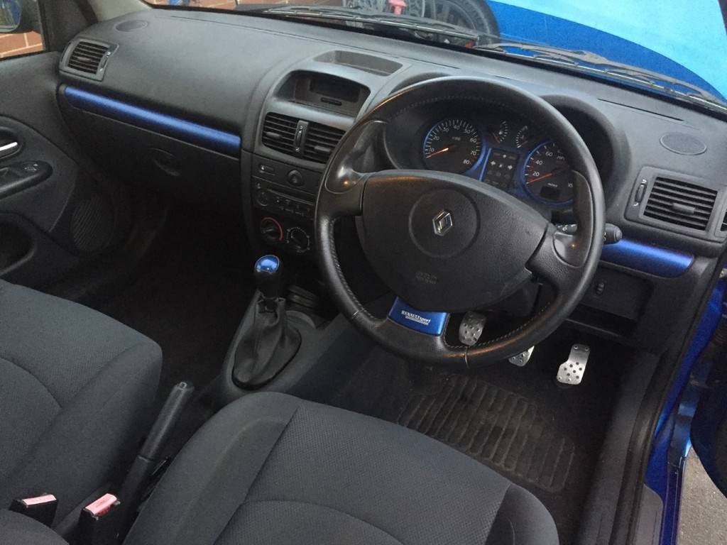

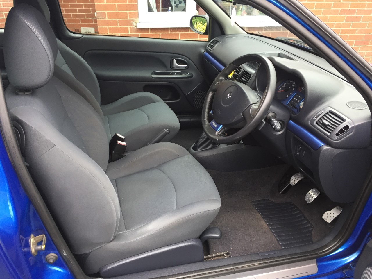

1. Wiped down interior and all is well, no marks, burns, scratches, spotless inside. But its all rather grey, any kind of recommended trim restorer anyone recommends as its one of the things I don't have in my collection of car cleaning products.

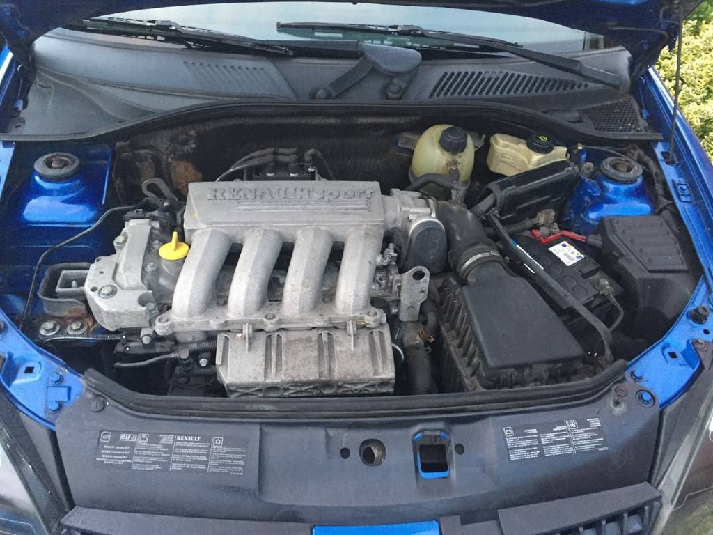

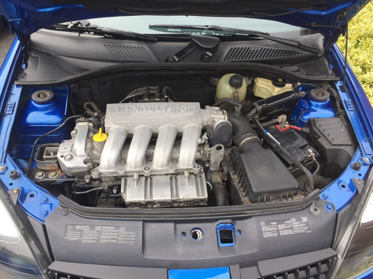

2. The battery is not fastened down by anything, so you can move it and I can't see any kind of bracket to clamp it, obviously it can't escape as its in a space not much bigger than it but batteries should be clamped down, so if mine missing something?
3. Power steering reservoir is empty, guess the leak at front of engine is power steering from PS pipe, though when I drove it home steering felt fine and was quiet. What fluid do they take, I've got ATF, CHF and slick 50 in my collection.

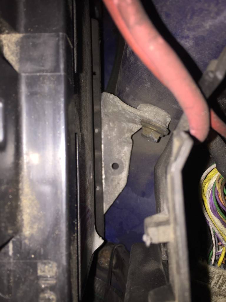

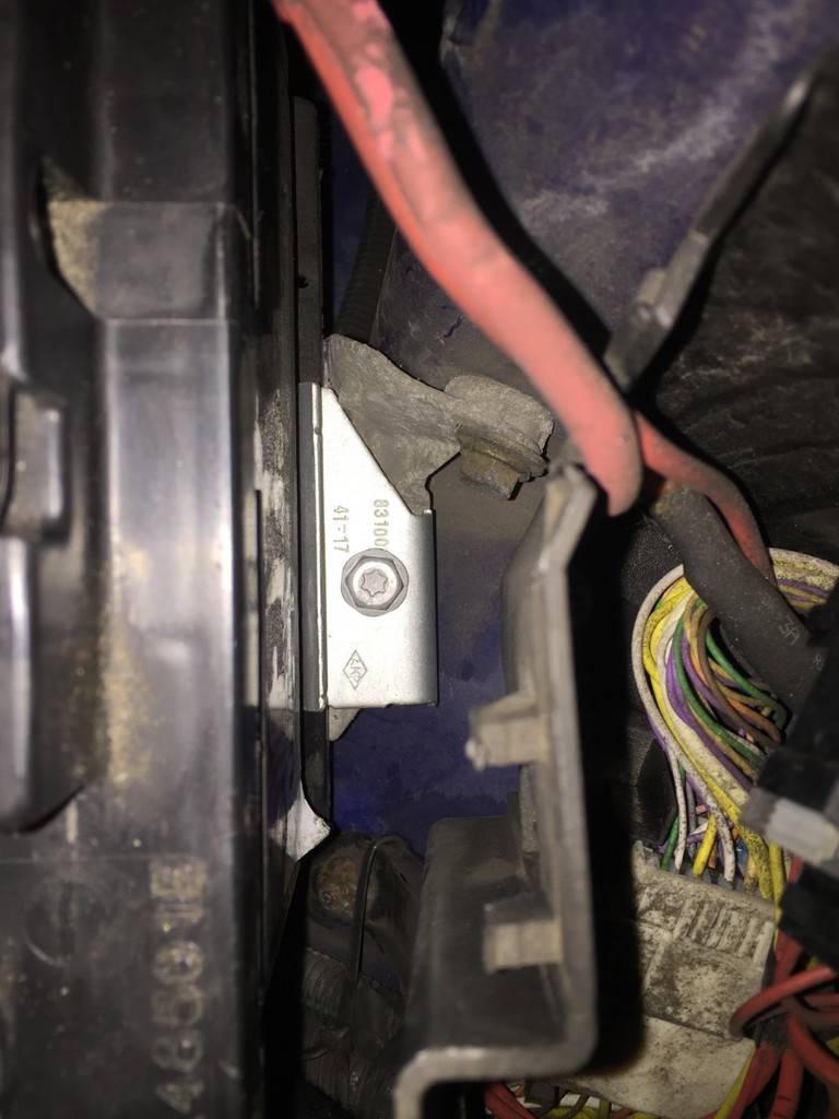

4. The ECU bracket that is bolted to strut tower is snapped just after the bolt it wobbles, can't go anywhere, can it be welded? Assume so, otherwise I guess nothing that some gorilla tape won't fix either.
5. I think engine mount upper left is shot, I can move engine back and forth a few mm with my hands, no knocks, but there is movement but maybe there is meant to be some, not an issue as I ordered new mount today.

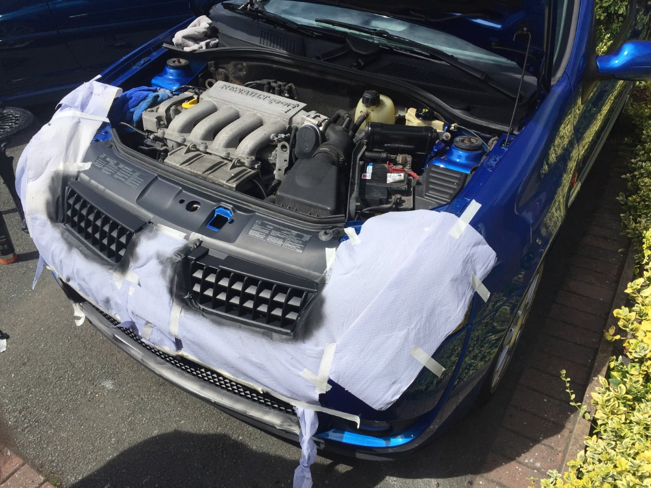

6. The front plastic grill / shroud is faded, I've put some trim restorer on to good effect, but they are not permanent. Same for lower plastic grill and foglight surrounds, do these all remove easily as probably best to just give them a coat of matt or satin black paint.
7. Scuttle panel and wipers are heavily faded, again easy to remove as can just paint too?
That is it, they are all minor little niggles, power steering fluid been void is an issue as it seems dry but steering sounds fine, so see what score is there, no doubt pipe leaking at rack end.

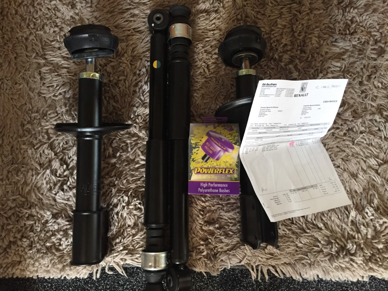

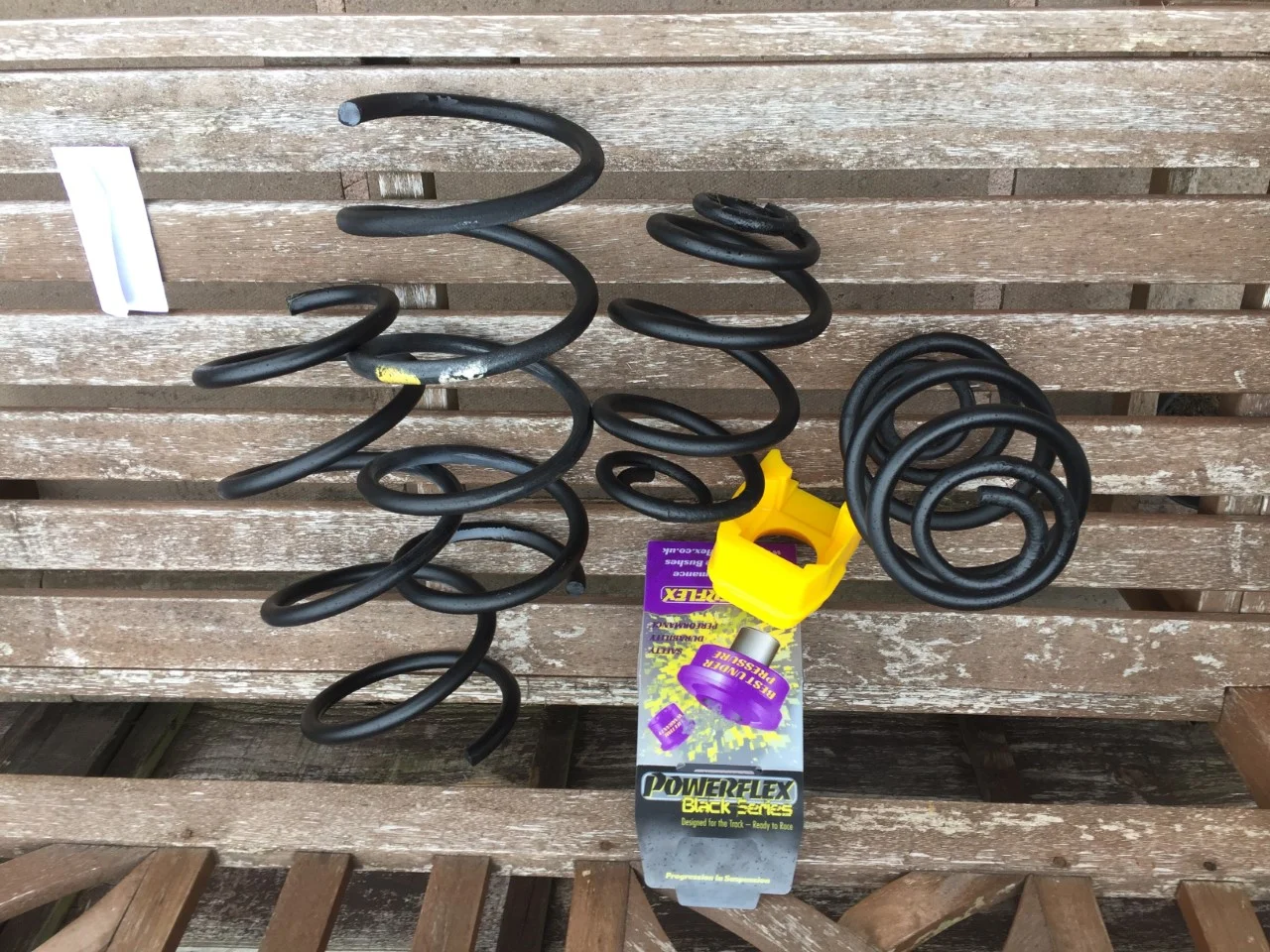

In better news the brand new original dampers, top mounts and powerflex rear beam bushes arrived today. :)

•It is a pretty grey drab interior to be honest!
•Yes there should be a clamp on the right side between the battery and the fuse box: https://www.ebay.co.uk/itm/GENUINE-...enic-Espace-Trafic-Modus-Kangoo-/261187050664
• Not good! It uses ATF, Dexon 2 is what Renault recommend.
•A leak on the PAS isn't ideal as the high pressure PAS pipe is expensive (I found this out last week).
•Common areas to look, just near the alternator there is a PAS pipe that heads directly down andthere is a PAS pressure switch (grey) on the pipe, if you're lucky they fail at the switch.
•Unless its the pump itself, it will be the high pressure pipe like mine (circa £200 pipe), its the the pipe that heads directly down after the pressure switch, goes over to the gearbox, then over the gearbox, back down and into the rack. Nightmare to change and the Cups have a specific pipe.

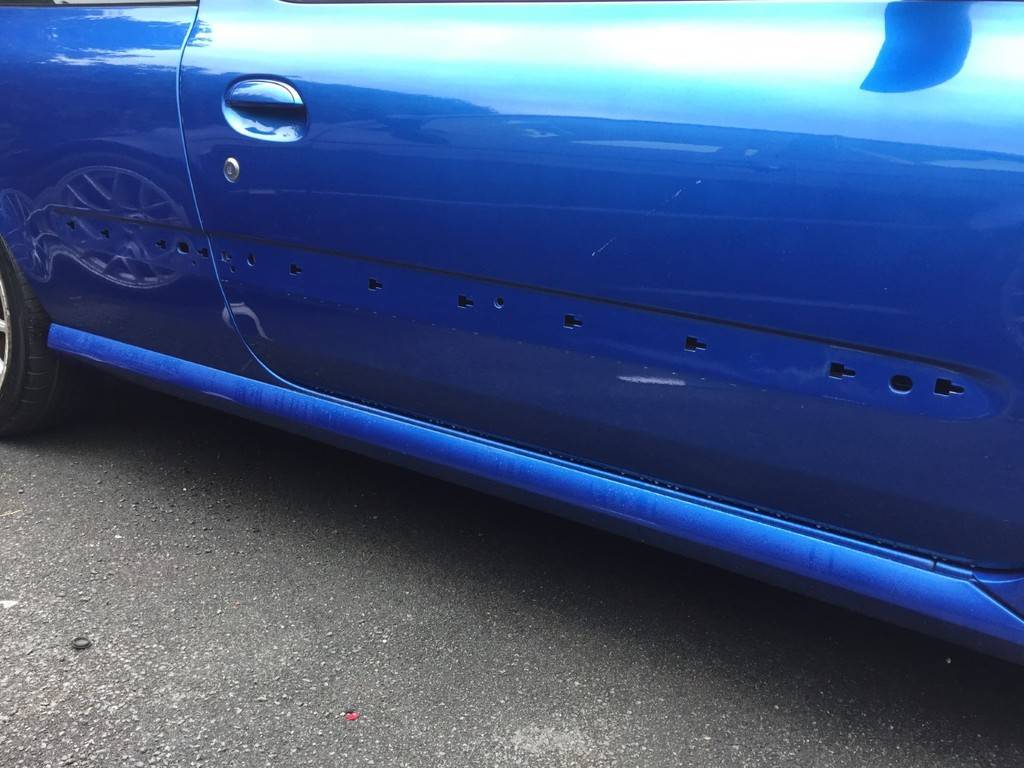

Standard feature. Simplest fix is to sandwich the remaining bit of metal between two oversize washers and bolt it down.
Easiest if you take the bumper off, but its all simple push clips.
Pretty easy to remove - remove the rubber seal and there are some pop clips on each side. The drivers one is easy as there is no interference from the wipers. Passenger side you have to remove the wiper blades, normally one of the blades will be corroded to the spindle, so you will need a puller, something like this:
https://www.halfords.com/workshop-tools/tools/hand-tools/laser-ball-joint-separator-cup
Just don't drive it empty, I did half a lap at Snetterton (slow pace) after I noticed the smoke pouring at the back and the PAS pump has already died.
Thank you!
Battery clamp ordered!
Yes the majority of the oil is all on PS line near the alternator, further along to PS reservoir the pipes are dry. Maybe is the switch then.

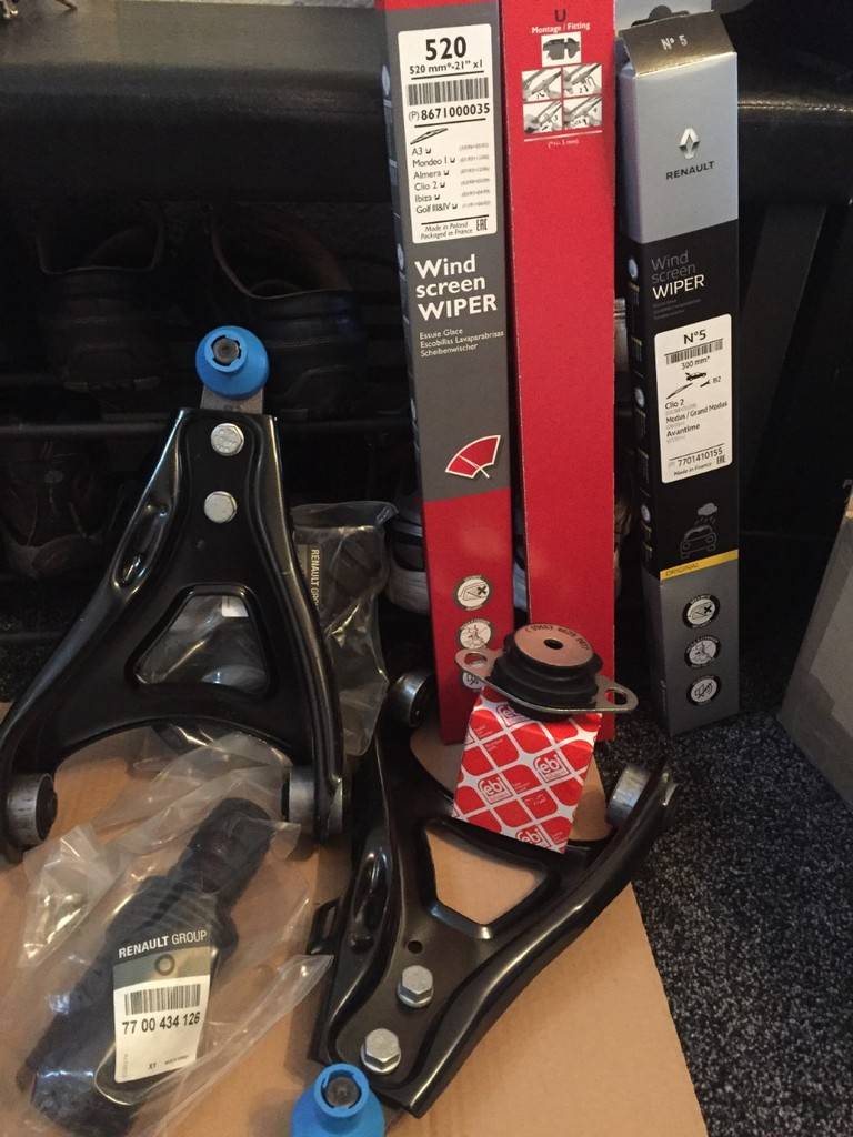

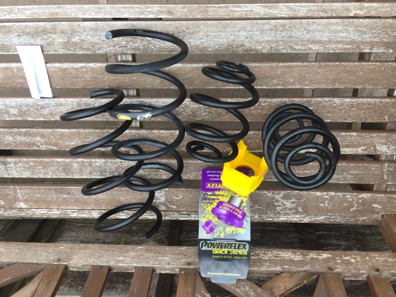

Got quite a collection of parts coming for it, as parts arrive I shall photo and post them up. The specialist says they can do it all in a day, hope so as its mounting up:
- Major service
- All belts including dephaser, accessory pulleys, crank bolt, water pump etc.
- Rocker cover re-seal
- Upper engine mount (probably fit this myself if it arrives soon enough) along with powerflex yellow insert
- Gearbox mount
- Dogbone mount
- Track rod ends both sides (inner and outer), as NSF inner rack end was advisory on MOT, so just refreshing the pair
- Fit new dampers all round along with fresher cup or cooks springs (got a set of 20k miles cup springs for £12) and bidding on a set of 5000 mile cooks at £70) along with new top mounts
- Powerflex rear beam bushes
- New reservoir header tank
- Fix power steering issue (for now I shall add some dexron 2 and some slick50 to get it to specialist)
- New HT leads (probably fit myself, not required but £25 from ECP with Summer35 code)
- Gearbox oil change
- New plates (fit myself)
- New upper brake light (fit myself)

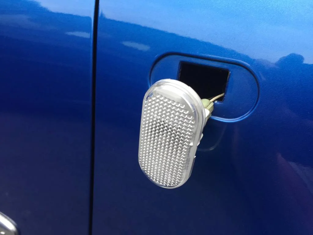

- New clear side repeaters (fit myself)

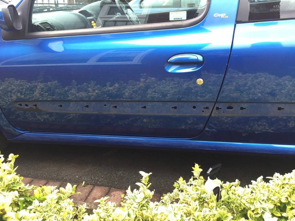

- New door strips and bullets as mine are scratch (found a set for £20)
- Fuel filter
The above should freshen the car up nicely and in theory will remedy all and any engine bay issues the car maybe has along with a good percentage of the suspension/bushes refreshed.
Anything the specialist finds on top shall be done on the day or at a later date.

This weekend I plan to remove inlet manifold, air box, battery and give that area of the engine bay a good cleaning and check over. I shall then spray the inlet manifold in silver along with tidying everything else up and re-fitting. May also spray the front grills and fog surrounds in satin black or with black plastidip.

Quick picture of how the front grill and fog surrounds came up after an external trim restorer, before then after:
BEFORE:
AFTER:

Looks great! Those headlights need more though mate, you can get them crystal clear
Yes I only had upto 1200 or 1500 grit, then moved onto compound, polish then wax.
I shall get some 2000, 2500 and 3000 grit in my stocks, then give them another go, will probably grab the Meguiars headlight restorer kit too simply for the fact it comes with a proper spray to sell and UV protect them so they last a few years and not weeks/months. :)
Think I went as low as 800 on mine.
Don't bother with a meg kit imho. I machine polished mine ages ago and they've stayed clear since. Just get a nice wax to put on them after using a polishing compound
Yeah I did a very quick 400 dry, then 800 wet and finished with a 1200 wet.
So to perfect them need to give them a 1500, 2000 and 2500 wet also, then compound, polish and wax.

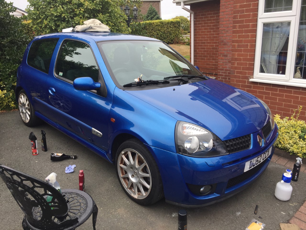

Hi there

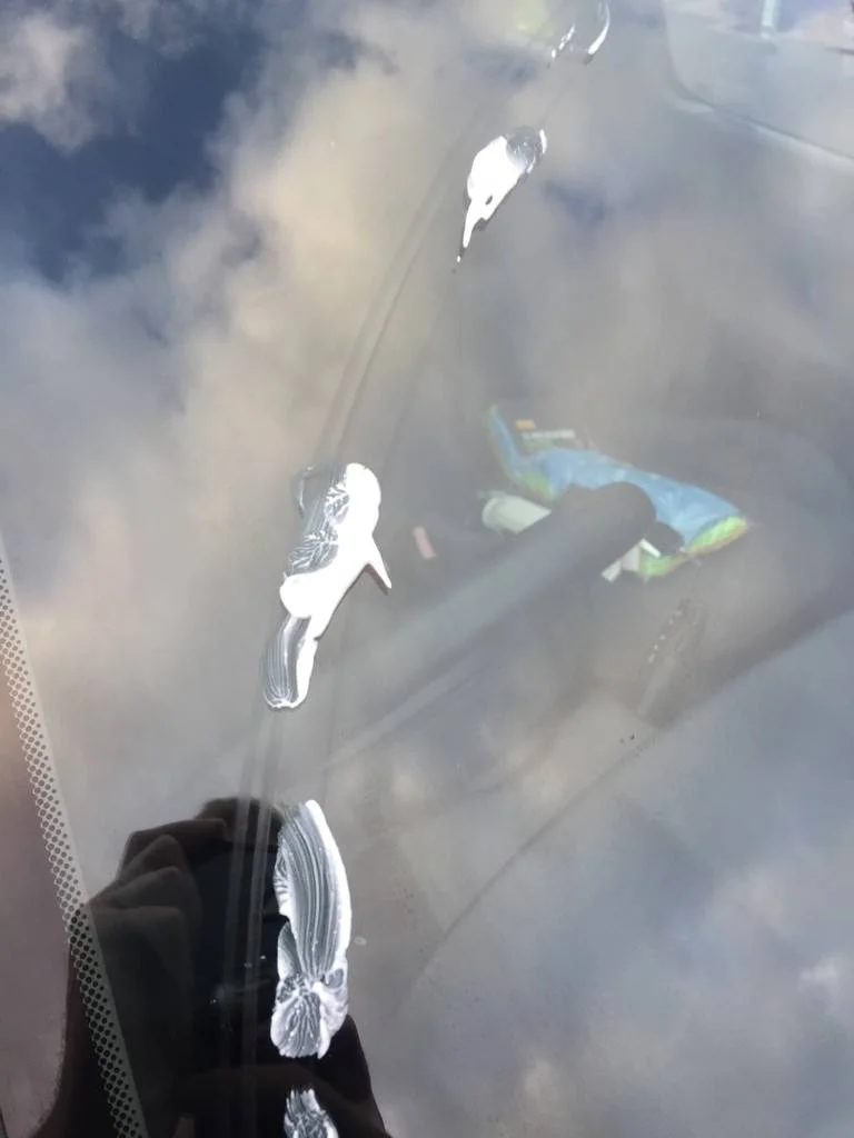

Went Halfords today to get supplies to further restoring the car, grabbed a Meguiars clay bar as a lot of contaminants on the paint so might get round to claying the car tomorrow. will then give a compound, polish and wax by hand when I get round to that, priority first is the mechanical stuff.
I also grabbed some 1500, 2000 and 2500 sand paper, also the meguiars headlight restoration kit G2000 was on offer at £1800, so grabbed that long with some engine degreaser, dexron 2, silver VHT paint, matt black, so tomorrows plan is paint front grill, degrease engine bay, paint inlet manifold etc.
Also added the Dexron 2 seems the reservoir was just very low but not empty, the leak is near the alternator so maybe pressure valve, specialist can sort.
So I had another go at headlights first with Meguiars pad and cleaner, then 1500 grit wet, 2000 grit wet and finally 2500 grit wet. Then a spray over with Meguiars UV protectant. WOW have they come up amazing, will grab better photos tomorrow once grill is painted but even in the dark you can see the extra depth, its another transformation:
Also polished up the rear lights as well, though those were pretty fine, but some compound, polish and wax later, still an improvement, no pictures I am afraid.

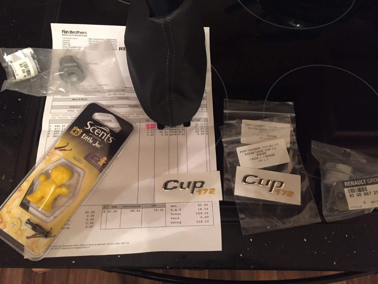

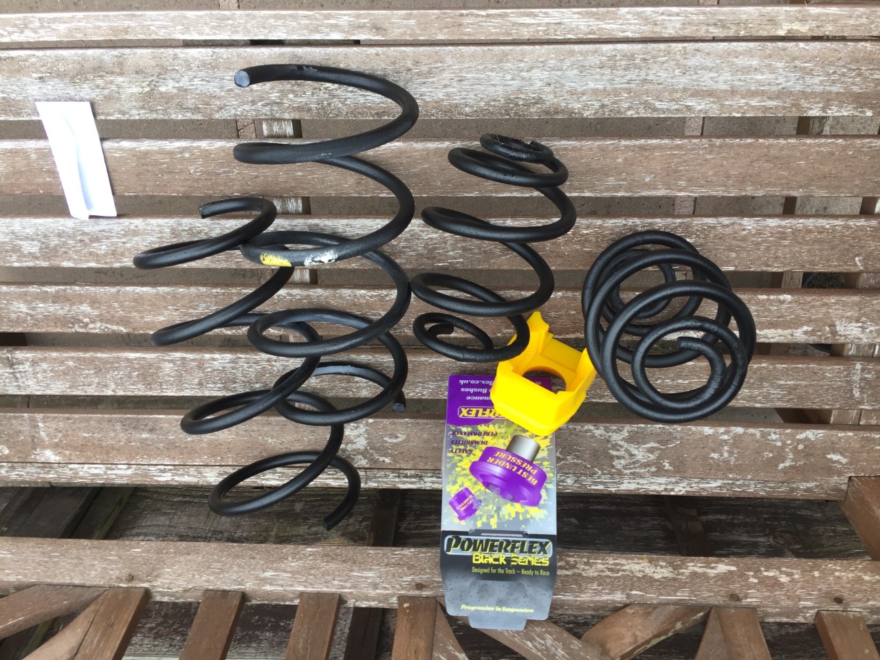

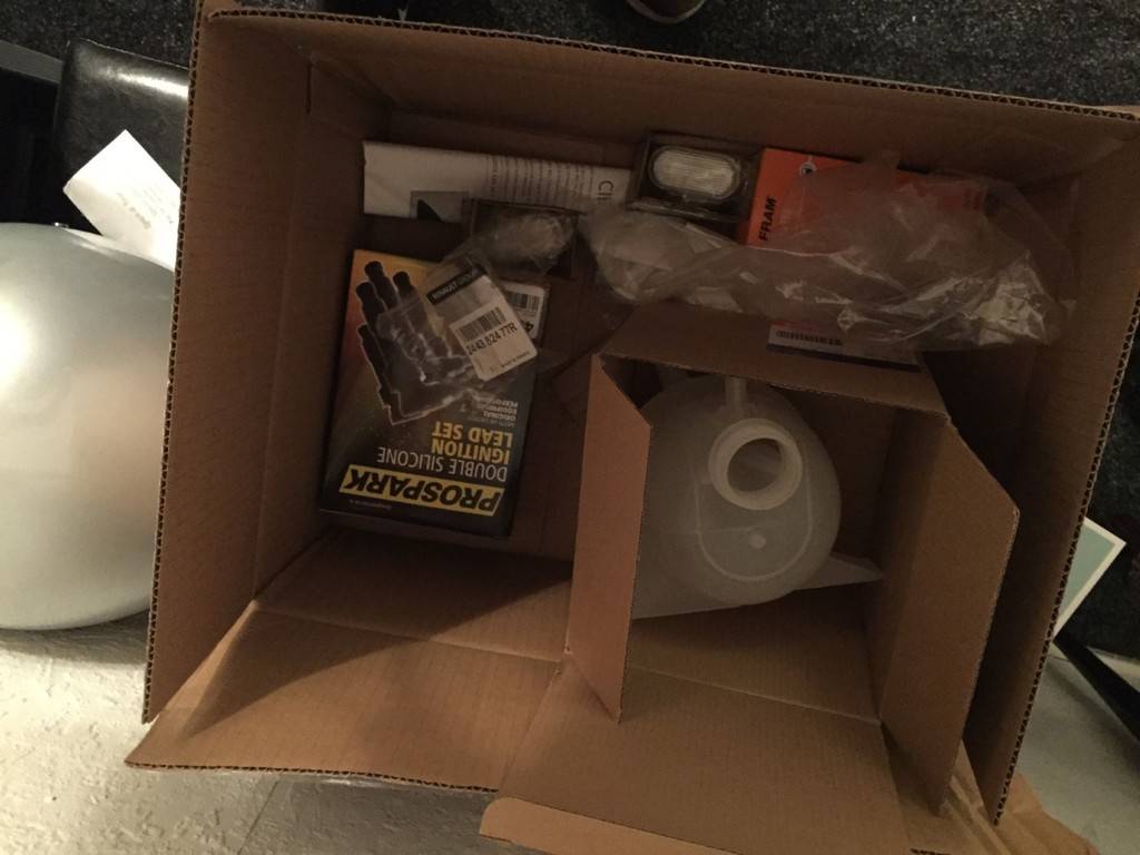

Another parts delivery today, just a small one:
- Yellow smelly bloke, got one in M3 too, suits colour scheme.

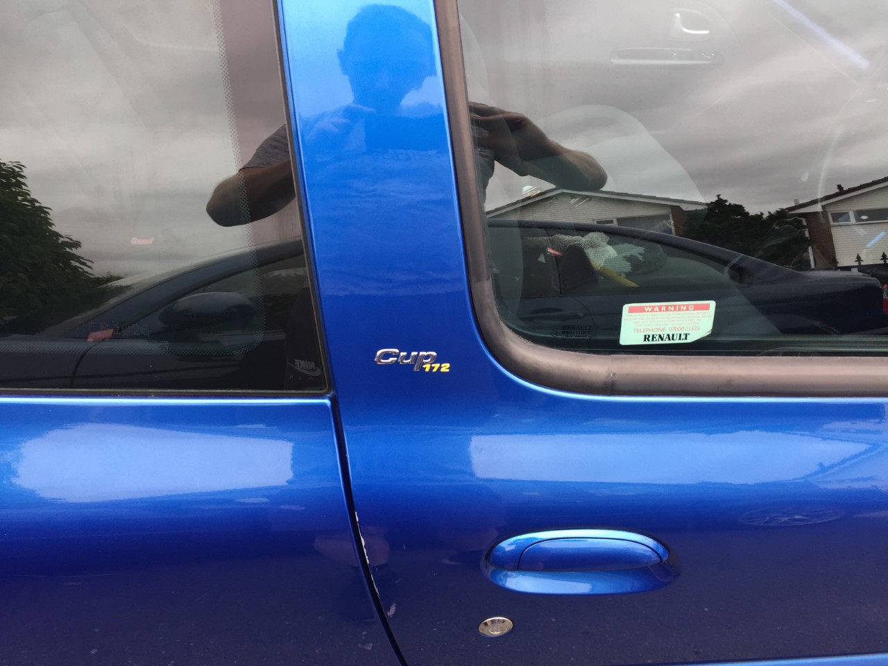

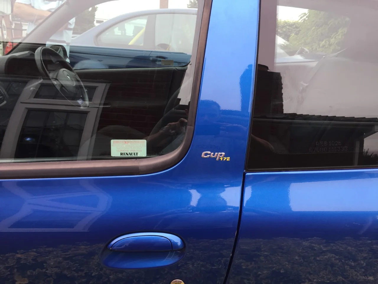

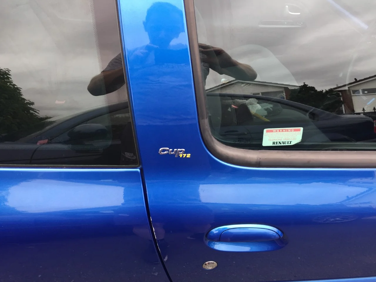

- Official 172 cup badges that go on the door pillars
- New gear surround as current one is ripped
- Updated top mount nuts, to go with new dampers, top mounts that arrived yesterday
- Got a rear upper brake light, but as previously mentioned its wrong one.
So plenty to crack on with tomorrow. :)

- Front upper and lower grills painted with plastiip to freshen them up
- Further cleaning on engine bay, decided not to paint inlet manifold but instead gave it some elbow grease and a real good cleaning.
- Carpets fully cleaned, seats all wiped down and then the interior trim all gone over with Meguiars interior detailor
- All the glass cleaned inside and out with Autofinesse glass cleaner
- New plates fitted
- Cup 172 badges fitted
- New gear gator fitted
Some pictures:
Still lots to do but the car is really starting to look better, also the car still has all the original glass which with a Cup 172 is very important as they featured thinner lighter glass to save additional weight. Only downside is the front windscreen is scratched from where previous owners must allowed wipers to become so deteriorated they scratched the glass whilst wiping on passenger side. Got the inside cleaned up, looking much better now and managed to remove all the residue from the tax disc holder.
The interior does not need so much now it comes up really nice and been a one owner car with low mileage it really does show as the seats and steering wheel show very little wear whereas these cars soon show wear to the seats and thumb grips on steering wheel.
All I want to do on the interior is get the gear number H pattern back on top of the gear stick as its faded.
The exterior still needs a lot of work, next step is to remove the side strips and bullets to give a real good clean behind those, along with cleaning the bullets and strips themselves, wax behind and refit. Then get a touch up kit and fix the loss of paint on door edges, thankfully only down to primer so no corrosion or rust, so get all that fixed. Then see if I can polish out the minor scratches around the car, followed by a clay, polish and sealant.
Also the fresher original cup springs arrived today and the Powerflex engine mount, just waiting on upper mount to arrive now so I can remove the old, clean that area up and refit new mount:
So brand new original dampers with much fresher springs, powerflex rear beam limiters/bushes will perfect the handling.
More updates to come. :)

Would recommend eibach sportlines or cook sports springs as standard they sit far too high.

So some more work on the car today, started by removing the door trims and yep quite a bit of dirt behind them:
All cleaned and waxed, then re-fitted:
Then decided to prepare the cars paint for correction and polishing which will come in a few weeks, as such washed it and then gave the car some clay bar action, oh my was it covered in crap and remember I have washed the car a couple of times now including treatment with fall out remover, goes to show how effective a clay bar is:
Car was then washed again and I gave it a very quick going over with Aqua Wax simply as its so easy to apply, spray on wet car, wipe down and buff, literally five minutes and gives protection for a few weeks, car is starting to look really good now:
Of course then it rained, but now the car actually beads even with a basic wax coating:
Next step on the bodywork will be putting the Chipex kit to work to see how well it can deal with the deep scratches and paint chips, I will also remove the sills at somepoint soon as well to clean behind those. :)

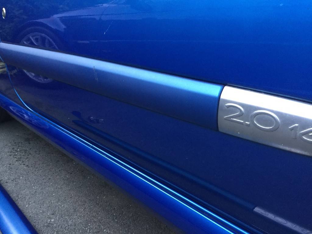

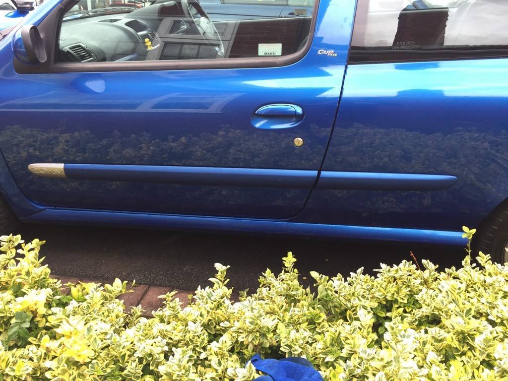

So the original door strips were damaged (deep scratches which been plastic be hard to repair, plus they were heavily faded. So I came across a used set on ebay for £20, but in better condition, they arrived today and were like new, the bullets were also cleaner as well, so got those fitted and compared old with new:
New ones fitted:
I did the other side as well, much fresher. :)
Also a box of goodies from ECP:
- Coolant bottle
- New wheel bolts
- Clear side repeaters
- New HT leads
- Rear number plate lense
- Battery clamp
- Probably some stuff I forgot!
So as the battery was not secure, I got that sorted:
Before:
After:
Just small jobs today but bit by bit it all adds up. :)

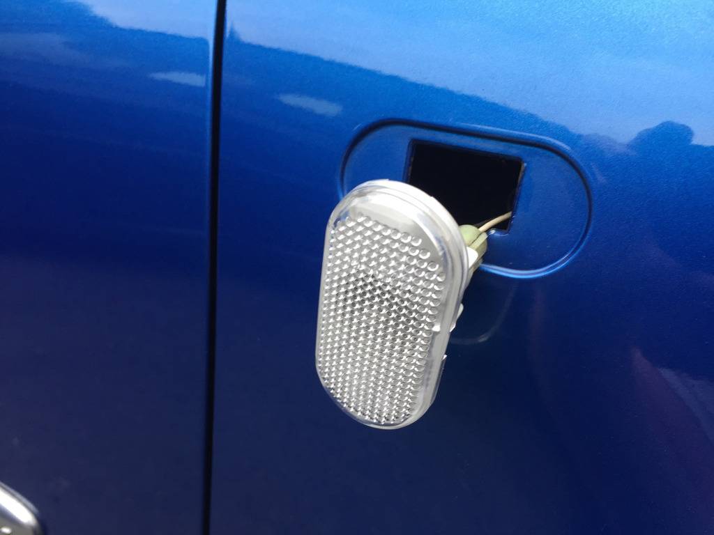

So a quick job this morning, as it required no tools, well you need you driving licence or anything that is a similar size, credit card etc.
Popped out the old grotty amber side repeaters and fitted some white/clear ones, also fully cleaned them up before fitting:
It is one of those cheap (£10) and easy modifications to do which really freshens up an old car. :)
More deliveries for the project:

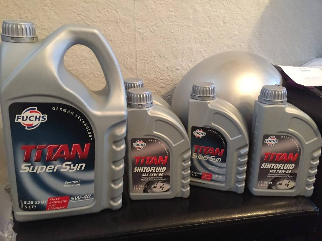

Full synthetic Renault approved engine and gearbox oil. :)
New latest revision wishbones which have additional camber, new ball balljoints, now engine mount (more mounts too arrive), fresh wipers all round, new dust boots for new front dampers. :)

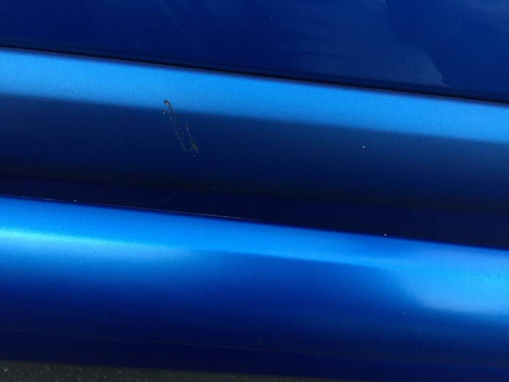

So the previous owner at some point must of allowed the wipers to fail resulting in bear metal wipers scraping the glass and thus the glass is deeply scratched. I've attempted to polish out with zero success they are just too deep. Then I tried what I watched on youtube which is use Fast Orange hand wash with pumice mixed with some compound or polish, about 70% fast orange and 30% compound, then use with a 3M polishing pad on a rotary. Well I only have a sponge on a drill end so not proper polishing pad but better than trying to do by hand.
Before on drivers side:
After on drivers side:
A vast improvement for sure, it is still there but it is about 65% gone, this was around an hour of constant polishing, another hour will probably improve it a lot or get the proper 3M polishing pad and a rotary.
Passenger side was even worse, really deep scratches and a lot more off them, not just on the outer radius:
After on passenger side:
An improvement, about 50% reduced, but needs a lot more effort but after constant polishing for a couple of hours I had enough and now want to get some dinner. Shall try to get proper 3M pads compatible with my drill and see if that helps makes progress faster.
So a question for the Renault experts, I want the car to handle, steer, grip like it would of new, so far I have:
- new cup dampers
- new top mounts
- revised upper top mount nuts
- new grams springs
- new wishbones
- new balljoints
- new anti roll bar bushes and drop links
- new engine & gearbox mounts
- Powerflex upper engine mount insert
- Powerflex rear beam inserts
- new AD08R tyres
Have I missed any bushes that are key, any items I should be replacing on steering, rack etc. to make sure its all tight?
I would add new genuine Renault inner tie rods (cup specific length) and tie rod ends (genuine Renault or lemforder) to the list whilst your there.
Ah knew I forgot something, I do have the following:
- Starline inner track rods
- Starline outer track rods
- Starling track rods boots
They are ready for me to collect from ECP, are you saying these won't actually fit? If that is the case do you have a link for the ones which will fit my 172 cup please?
Most motorfactors supply inner tie rods that are the wrong length. Get genuine inners and lemforder ends.
Last bit off that list is steering rack bushes. Powerflex is the cheaper option, I've just changed mine.
