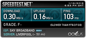

Welcome to Sky...
According to them we are getting up to 8mb/s
Hmmm Now I can understand a drop down to say 4mb/s but under a mb your having a laugh? Sh*t imho
So is the coax that feeds to your house, from that fibre in the cabinet![]()
99% chance that something in your home is causing that. Things to consider:
First off try putting your computer into the router with an Ethernet cable. If the speed is fine then you know it's a wireless issue and in that case just try changing the channel on the router. If that fails then consider these things;
How many telephone sockets? Are they all filtered? Is the router in the master socket?
I would also recommend removing your faceplate from your master socket and plugging the router directly into the test socket with an alternative micro filter.
I can't stress enough to try an alternative micro filter, the amount of BB issues that are just down to a faulty micro filter are insane!
Suppose I could try a new filter on the socket in the dining room, the master socket (by the front door) is unfiltered the only thing plugged into there is the house phone

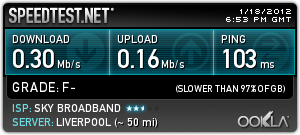

Welcome to Sky...
