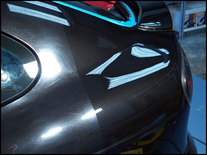

PO106FA applied by PC on a renault Megane :cool:
Thats how my 182 looks nearly!!! I hope i can achieve something like that!!!! Was that just the PO106FA on its own? How long does it take to get that level of finish?
That shizzle is awsome!! Is this Mezerna (never heard of it by the way) product only for BLACK? Are there Silver codes I should be using?
