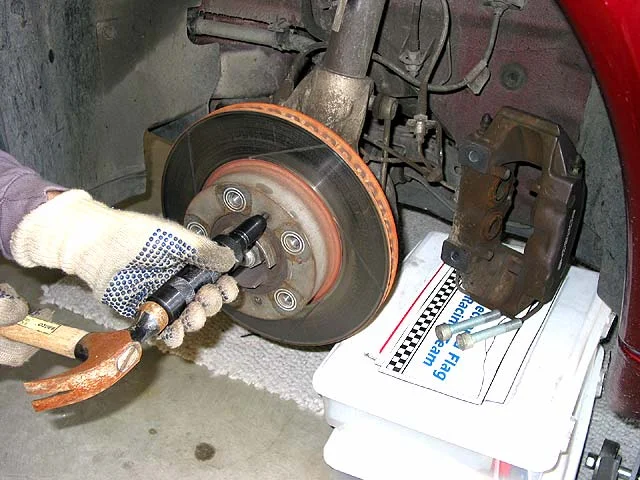

Well got it off in the end, took about an hour as I only had one of these to use PIC & a lump hammer lol.
