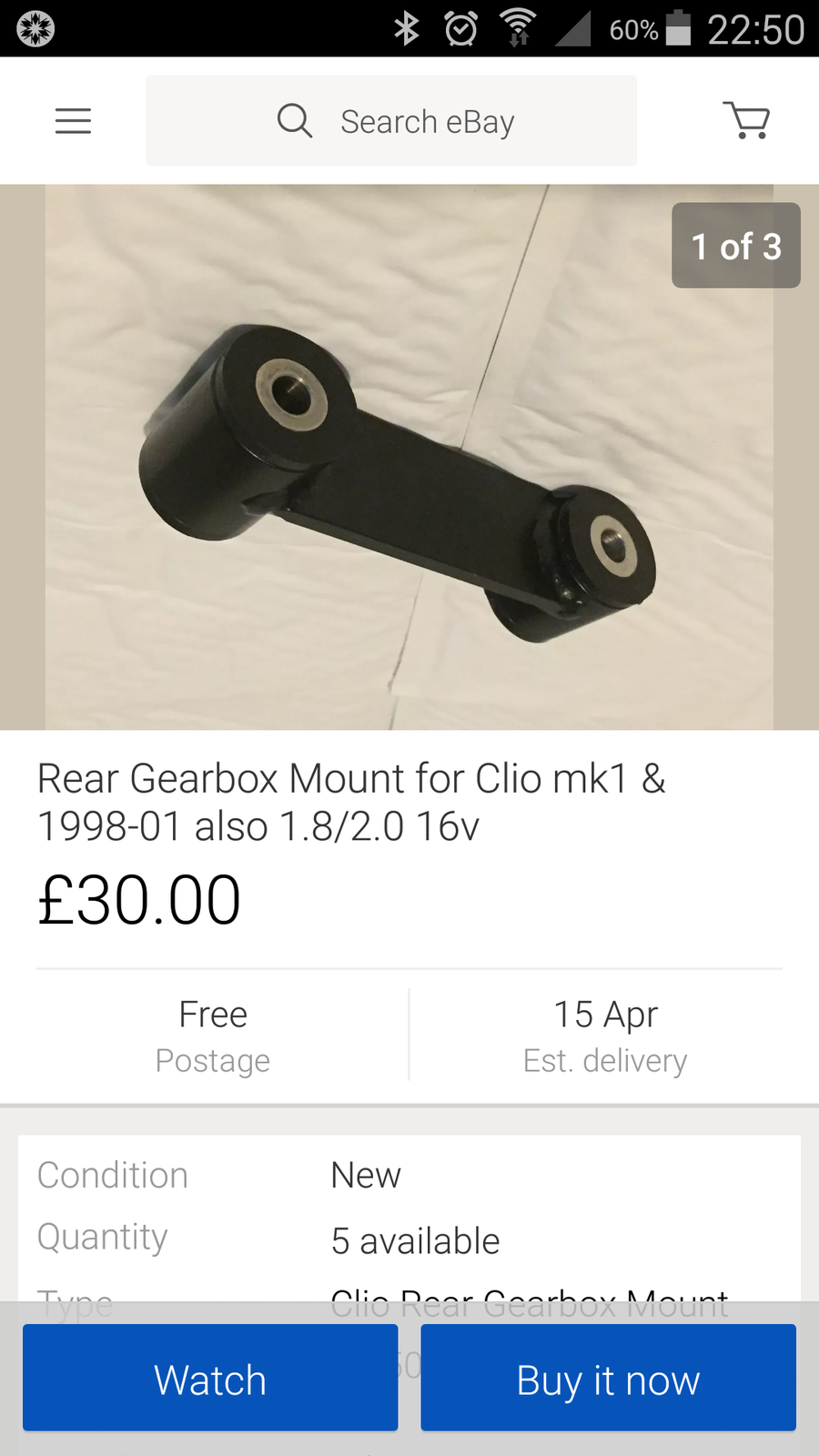

I knew knew I should have done it last week as the my are not £25 any more! And I can't find an option for the stiffer one, not fussed about the vibrations as its a track car. I will have to see f I can buy direct from here.
Noooo, car is more important! Haha. Mine only knocks when pulling off or low speed manoeuvres, I also don't want to damage my new exhaust!
If your looking on eBay, the one shown with black bushes is the stiffest they do.
The one with the blue or yellow one is the standard uprated one I believe.
Cheers
I had the black Ph1 saved in my eBay and it's now gone and can't find it anywhere. I can find the Ph2 but this is useless to me!
Is this not the one for yours?
