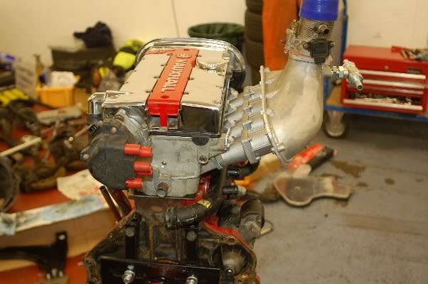

The ideal cams for a turbo motor are not the same as ideal cams for a N/A motor, so they wouldnt be the same cams that people normally fit with ITBs, but yes of course, and typically you find most turbo motors will run a single throttle body as it keeps the mapping so much simpler.
What I did on one of the engines I built was basically build a touring car spec N/A engine on steel internals and solid lifters etc, and then instead of touring car spec cams, use milder ones, and instead of touring car spec high comp pistons, used forged low comp instead.
Then the ITBs I used as a manifold essentially, with a shared plenum before them and a large single throttle (like on the S2000 cars).
Made for a very efficient turbo engine indeed.
Looked like this on the intake side:
that is epic!!!
