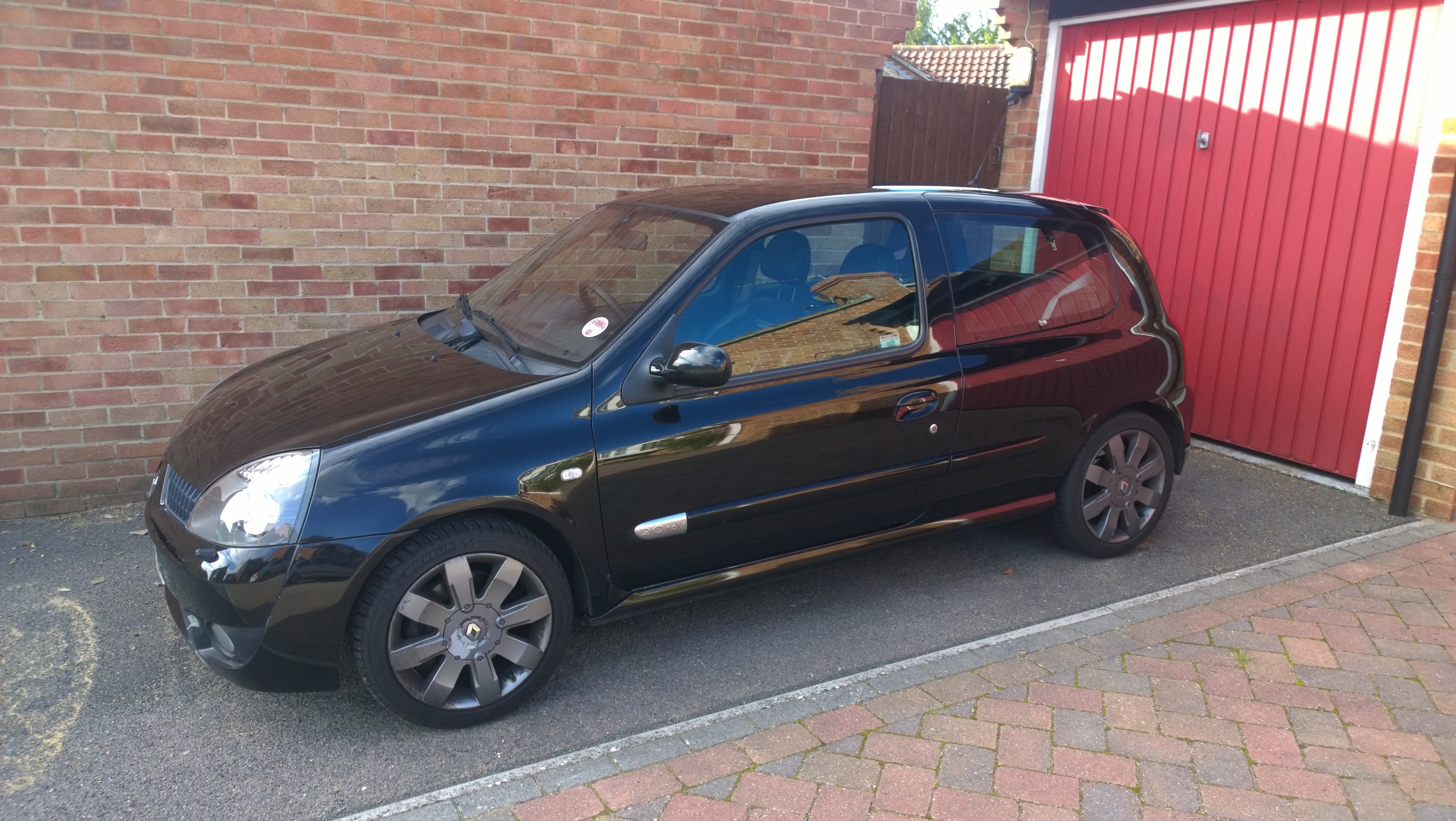

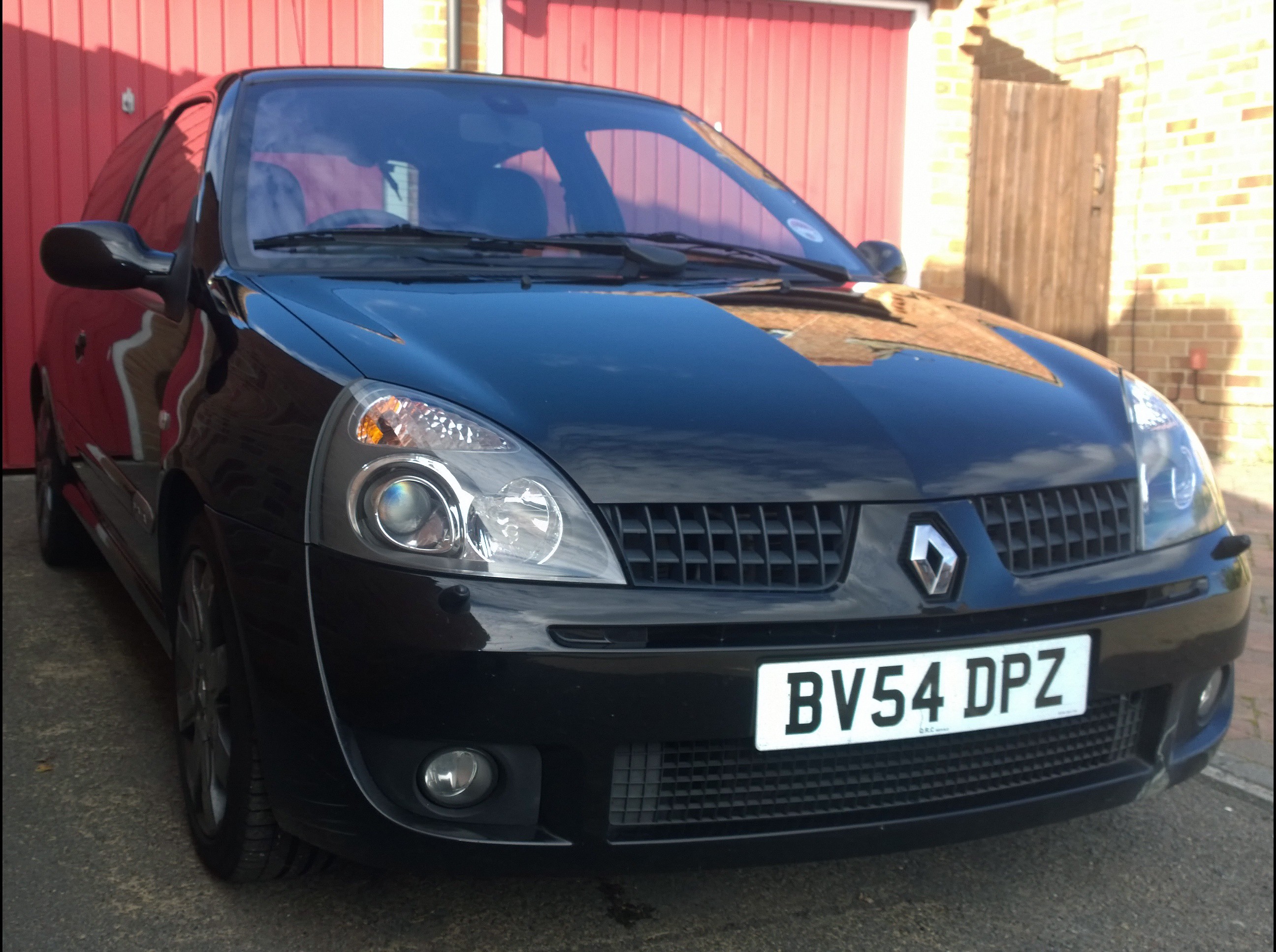

So here she is when I first got her home:
The front bumper had been cracked and filled but not painted. I thought I'd probably get that sorted out at some point (still haven't :wink: ) but before the car arrived I'd bought all the bits to give it a full service, a retrimmed Snappy steering wheel and a new instrument cluster as the temperature gauge wasn't working.

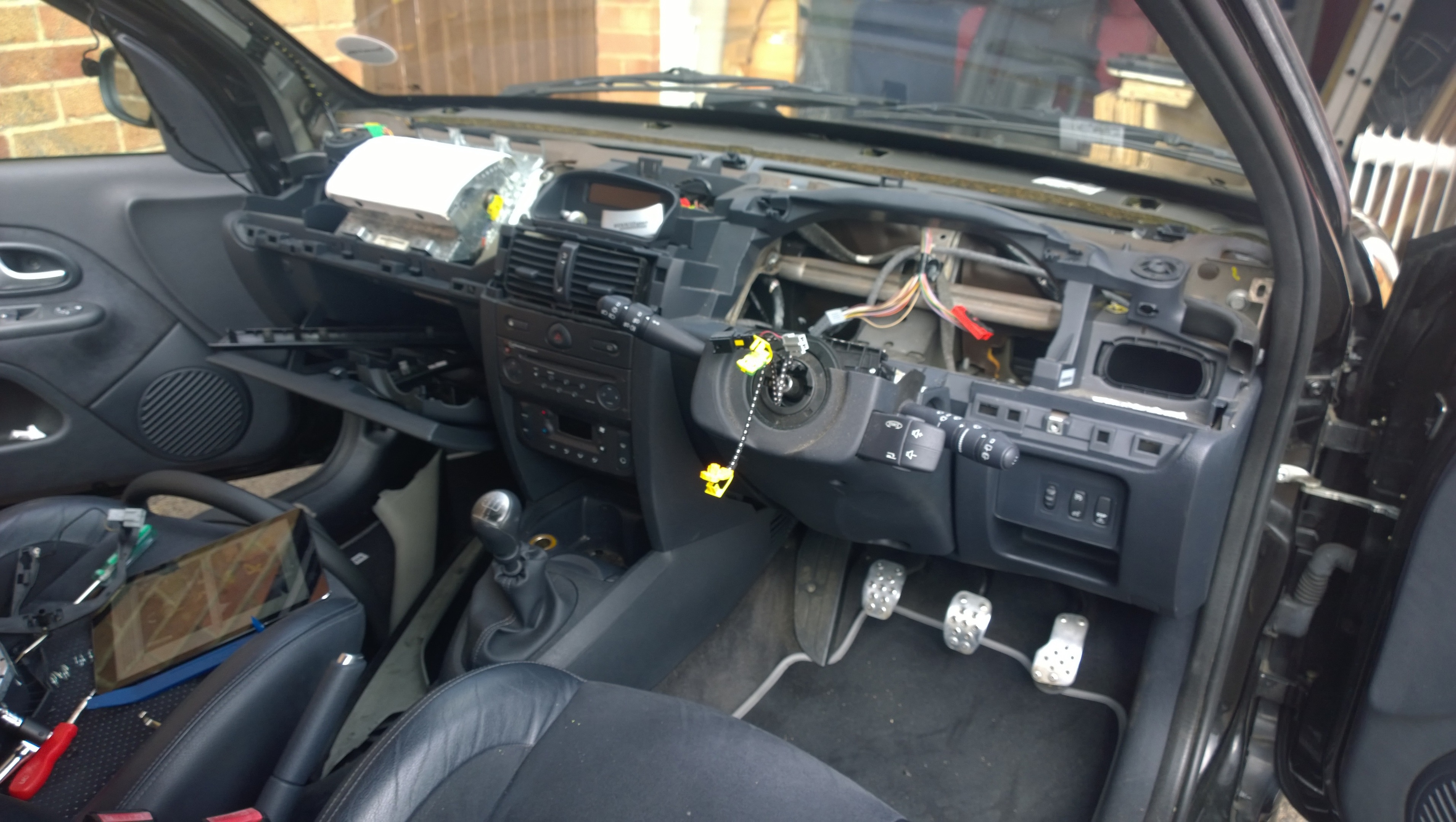

A week or two after taking ownership I took the dash apart for the first time, now I reckon I can probably strip and refit a dash in about an hour but it took me a hell of a lot longer the first time!
What a mess:

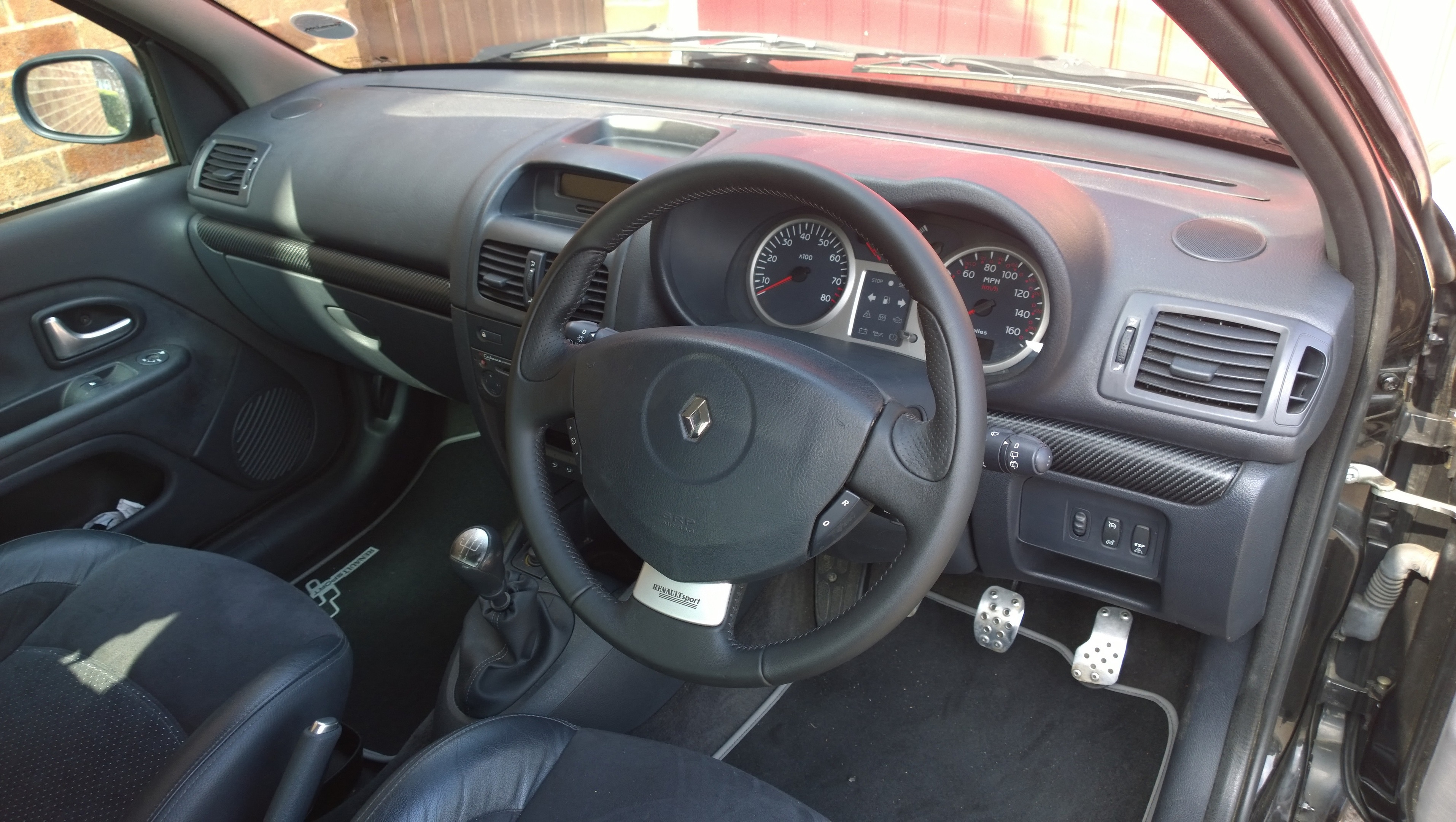

Still, it went back together easily enough and the new steering wheel looked the absolute nuts:
It looked the absolute nuts, but the driving position just wasn't right and the steering wheel was still too big. I really wanted to keep the OE look at this point, so decided to go for one of the GS wheel spacer kits from here but that didn't really work for me either. It improved things hugely in terms of reach but the wheel was just too big. I went off in a sulk to have a bit of a think and got the 182 booked in with a local mechanic to find out why it idled like a pig and to get some track day prep done........

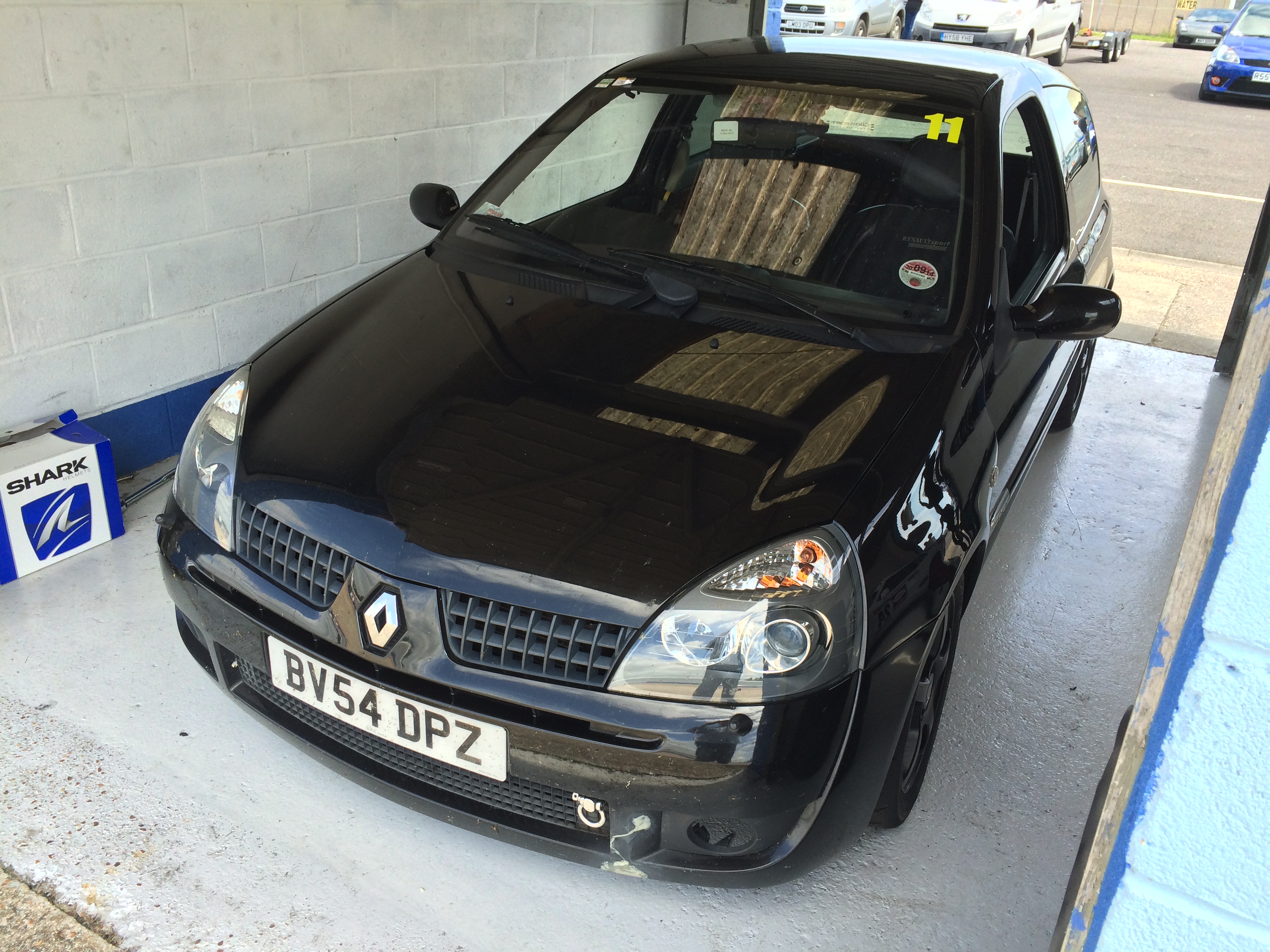

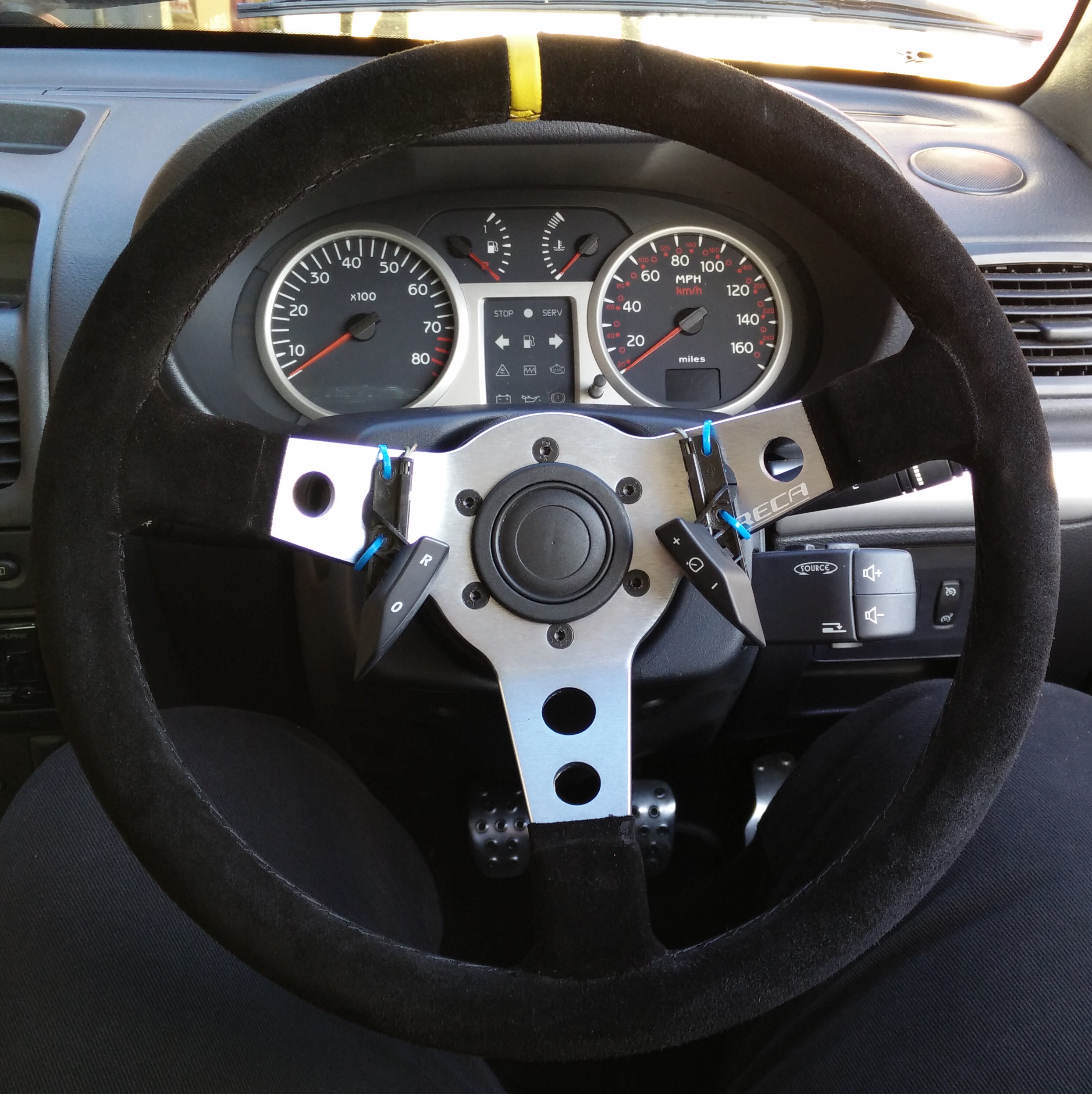

I was booked to do my first track day at Bedford and at the last minute decided it just wasn't going to work with the "bus" steering wheel so made a few frantic phone calls and bought an Oreca wheel from K-Tech. The night before setting out for Bedford I was fitting the new wheel, not ideal! Still, it turned out to be exactly the right thing to do.

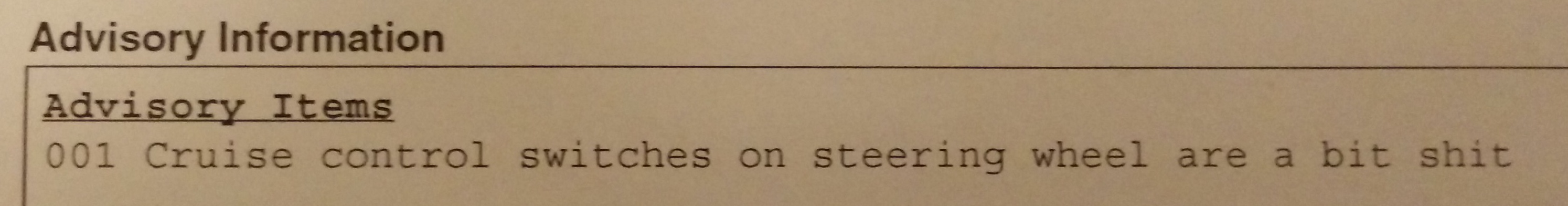

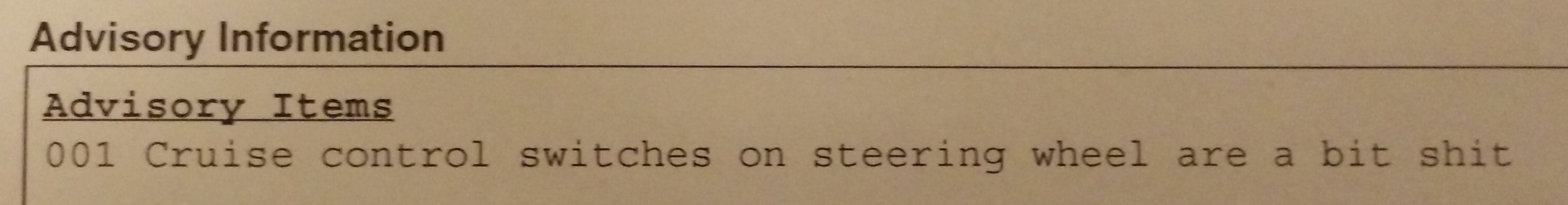

I couldn't do without my cruise control though :)
I got a fair bit of stick over that, not least when it was MoT'd. Best MoT advisory ever? :D

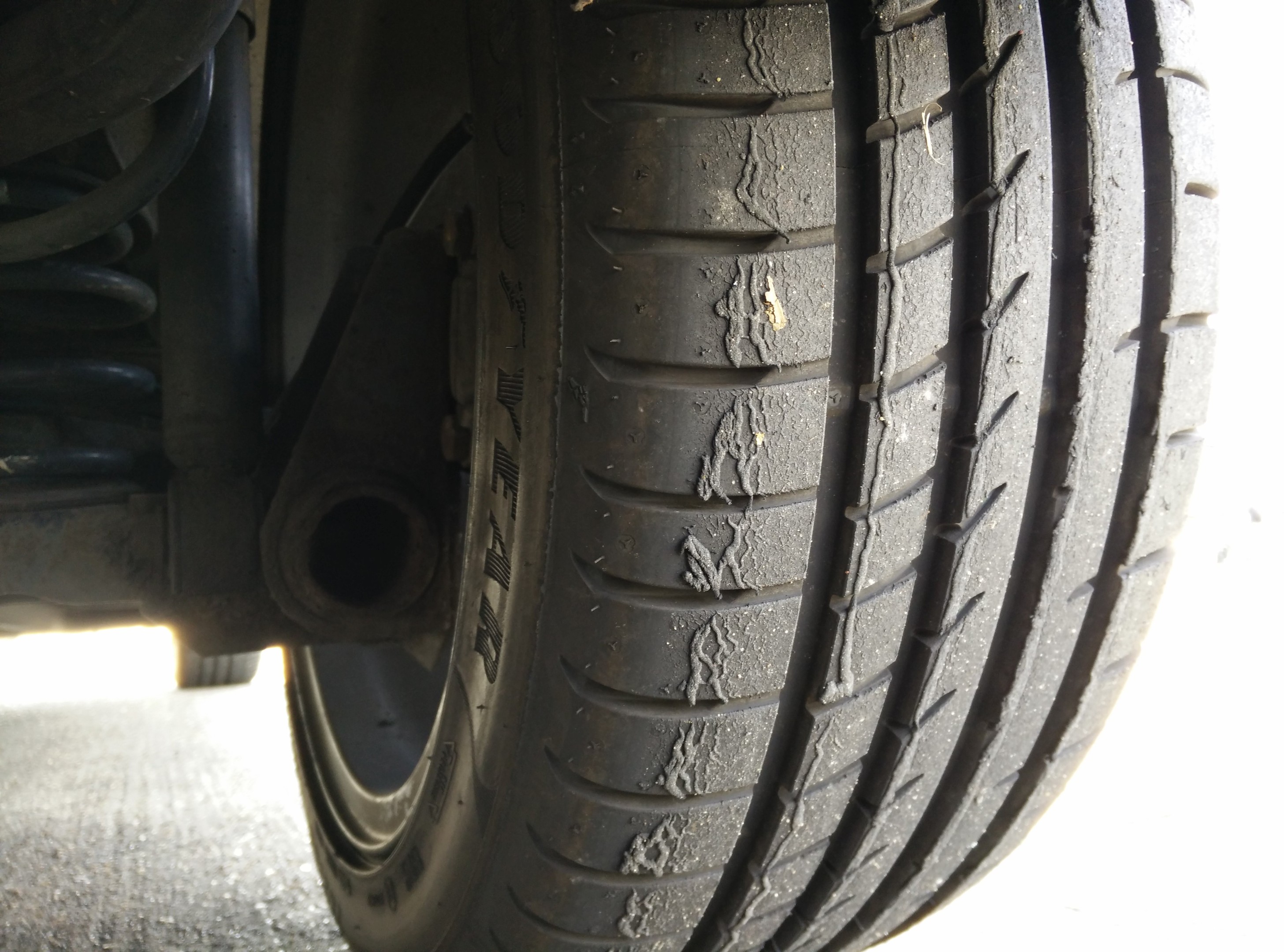

Had a great time at Bedford. Unfortunately it turned out my newly fitted rear tyres really weren't up to track work, I got four or five laps at most on the short SEN layout before this would happen:
It was like driving on fudge. Eagle F1's, great for the road, useless on track....

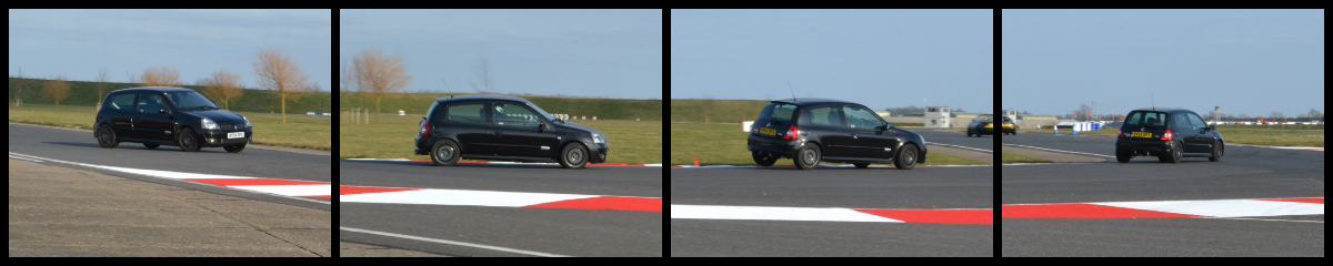

Still, I had a *lot* of fun:

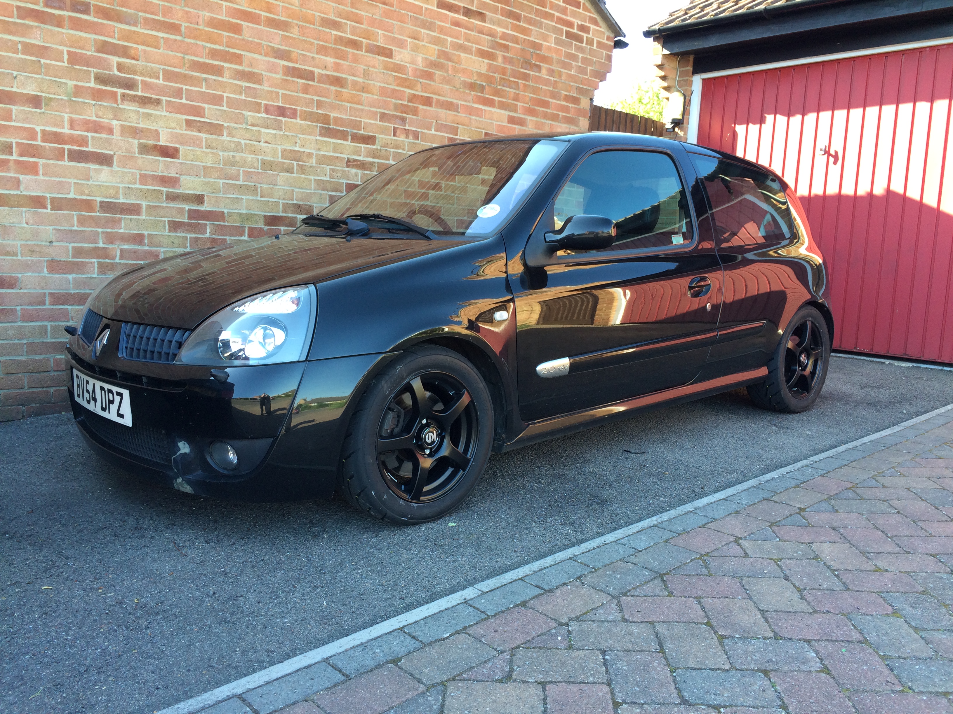

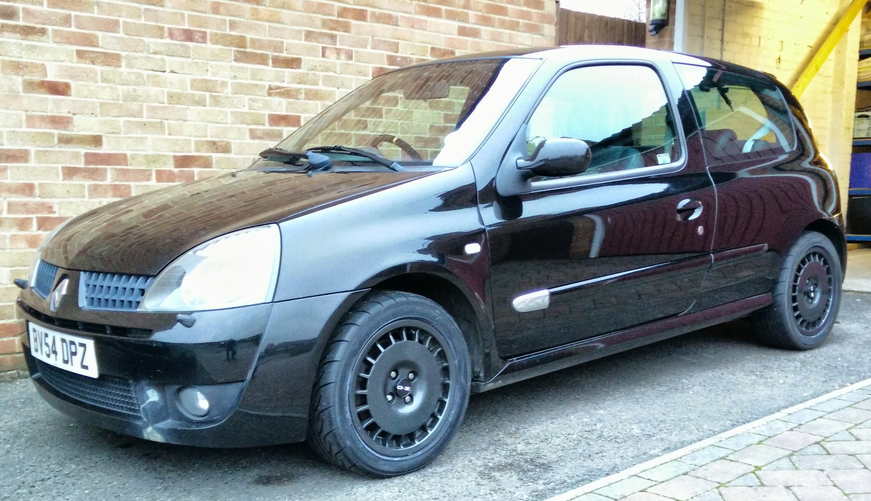

Here's the car as she stood after those changes:
The ungrateful little thing then decided to reward me for all my care and attention. See those dark spots just under the front of the car? Yeah, the radiator had popped. Back to my friendly mechanic and luckily it wasn't too expensive a job.

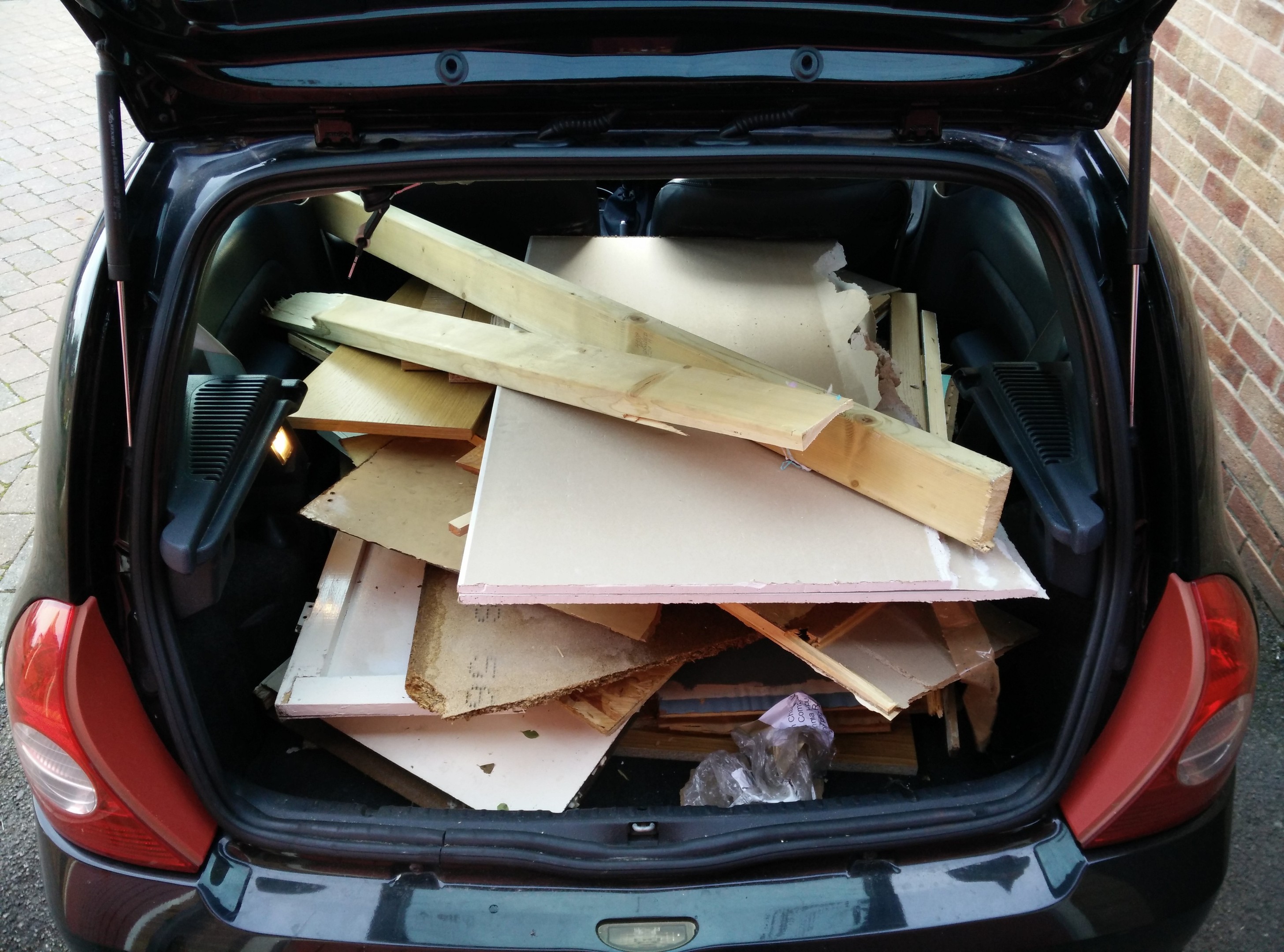

It also turns out that a Clio which has been semi-stripped for track use makes a very useful mini-van:

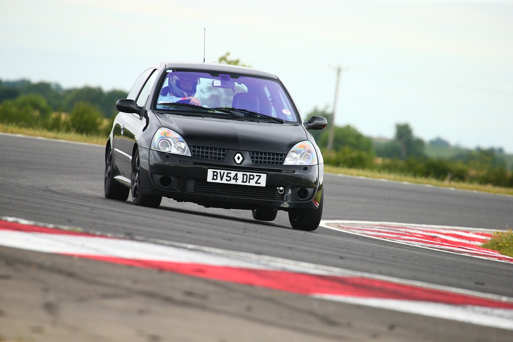

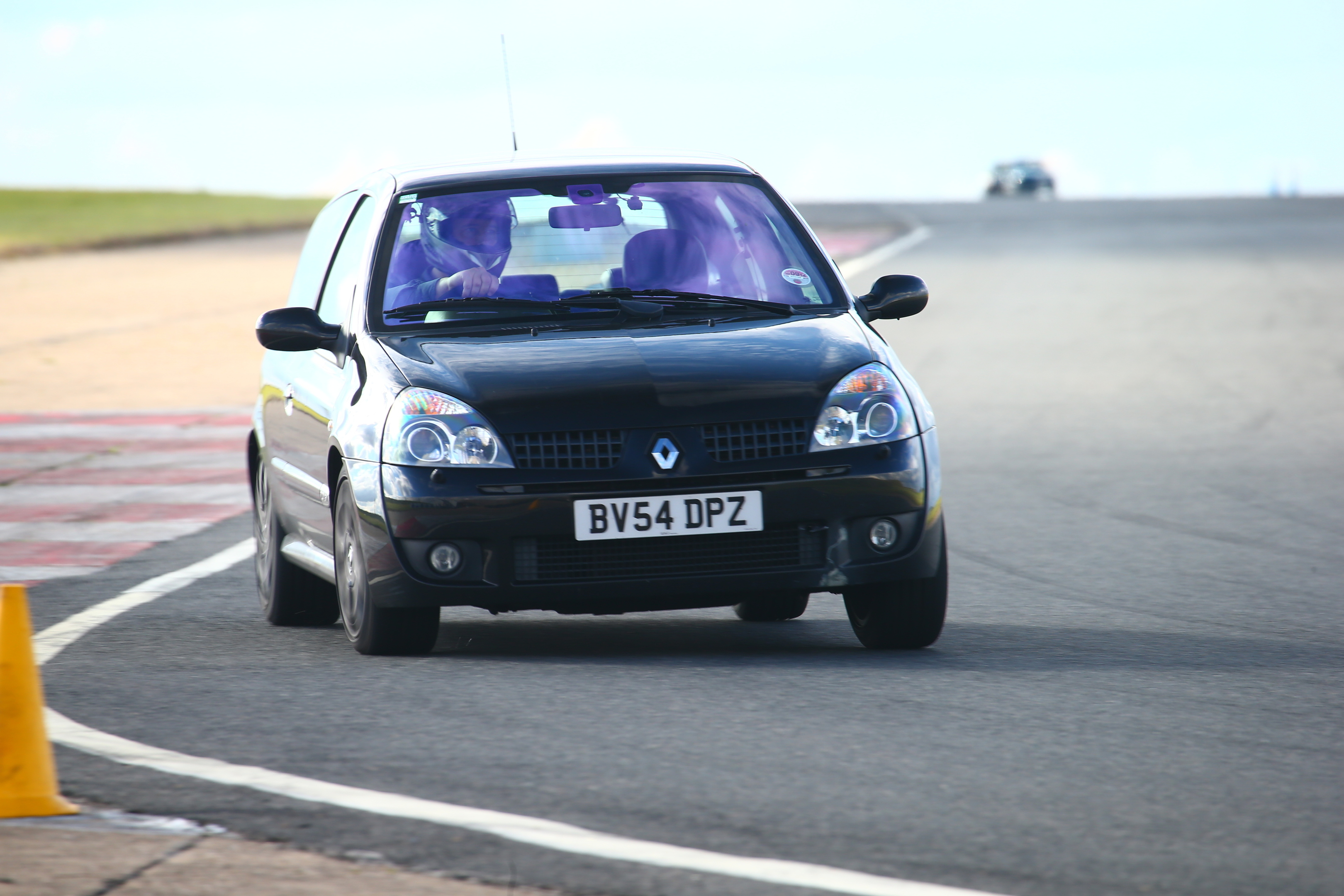

I then got to give the car a proper tryout at Bedford, this time on the GT layout. Now we're talking, it was mostly dry and the car performed really well. I was still running standard pads so was a bit limited by fade when really working the brakes but it was an absolutely great day.

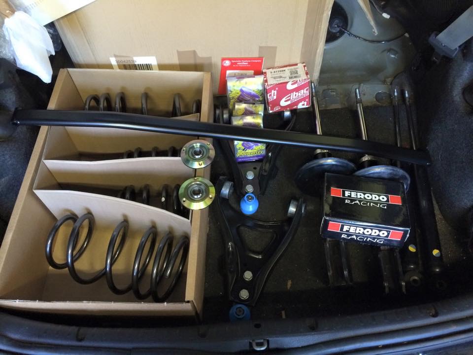

I may have got a touch carried away.
New front and rear shocks, wishbones, DS2500 pads, CookSport springs, PMS solid top mounts and a strut brace (still not entirely sure why, other than I love a good strut brace), camber bolts, polybushes for the ARB, rear beam and rear shock mounts.
Enough to be going on with? Yeah, you'd think so.

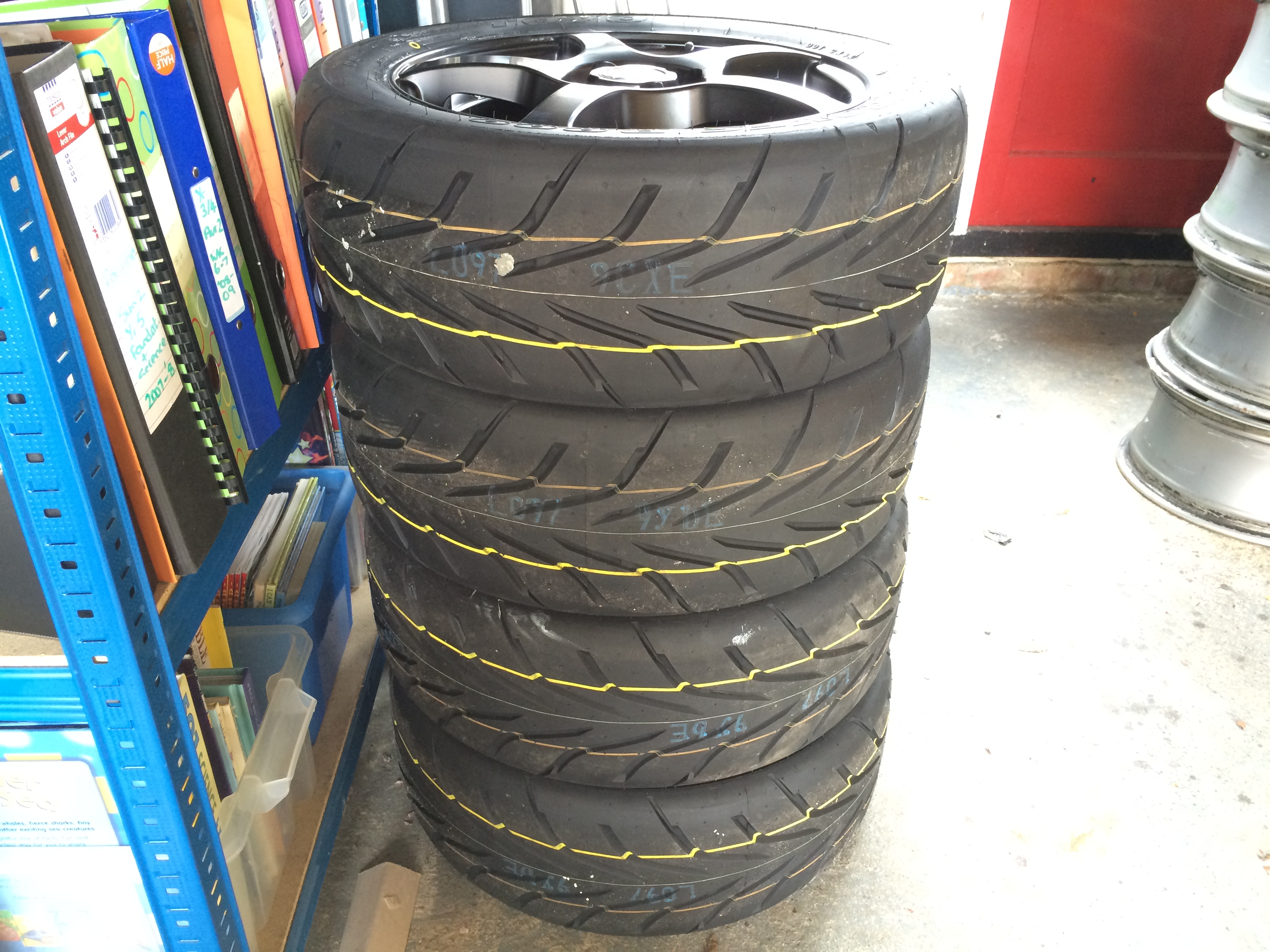

Mmmmm R888's on new wheels. Again, not really sure why, I just wanted them.
Still not entirely sure how I'm paying for all that! Anyway....... Another visit to my mechanic, an oil change, a full geo setup and she's looking pretty damn good.

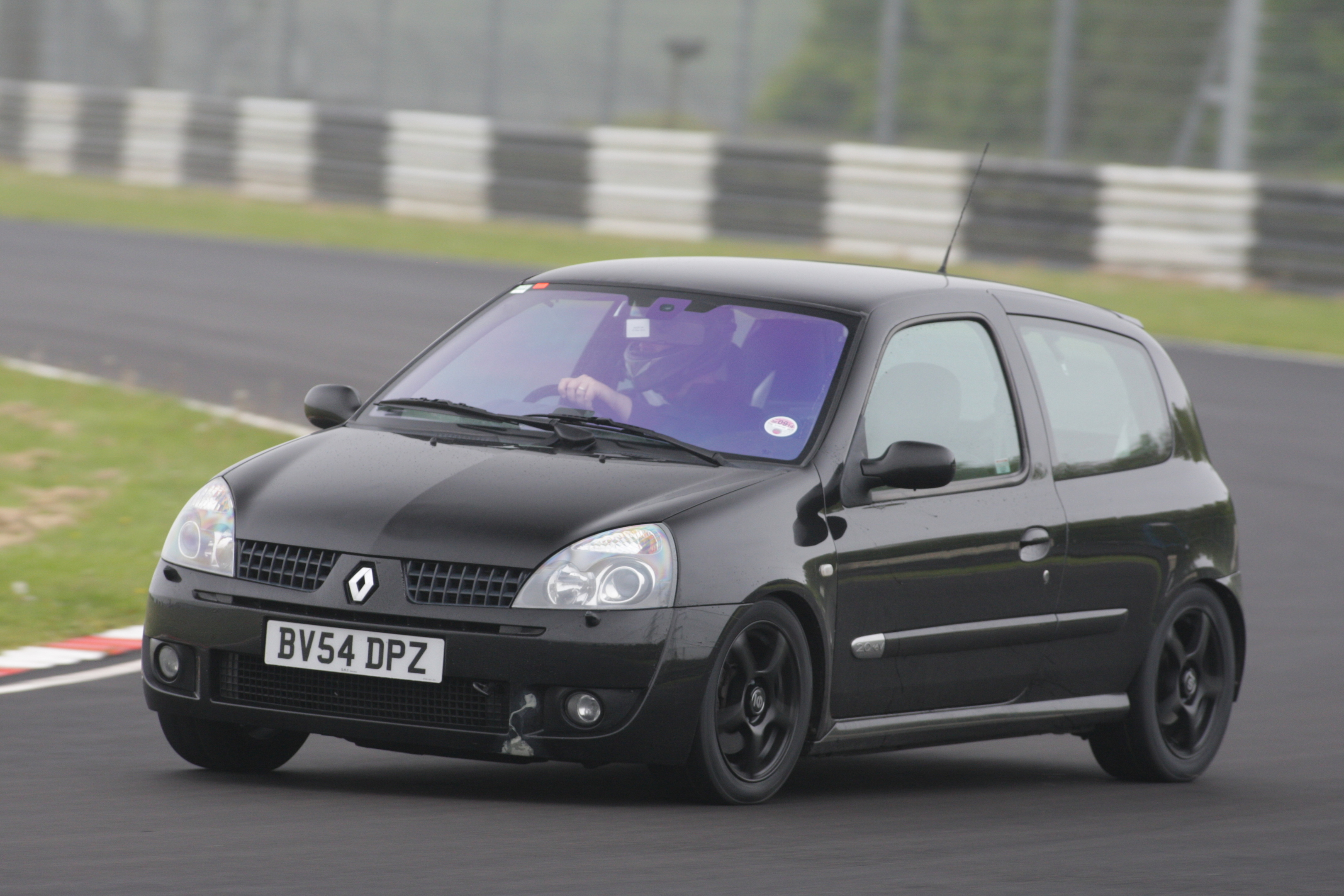

Next stop was Castle Combe and the car was nothing short of brilliant, so, so much better to drive at the limit.

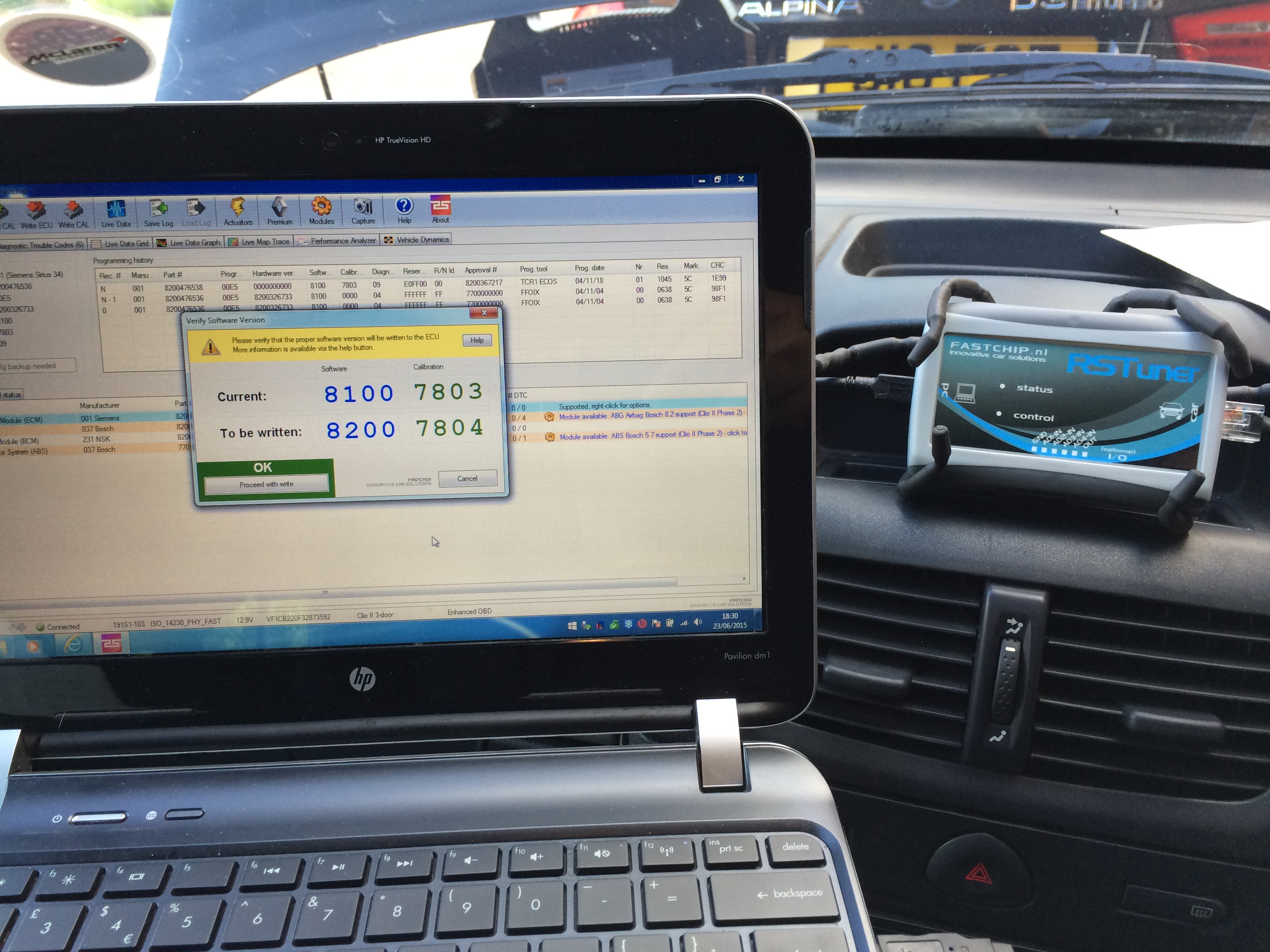

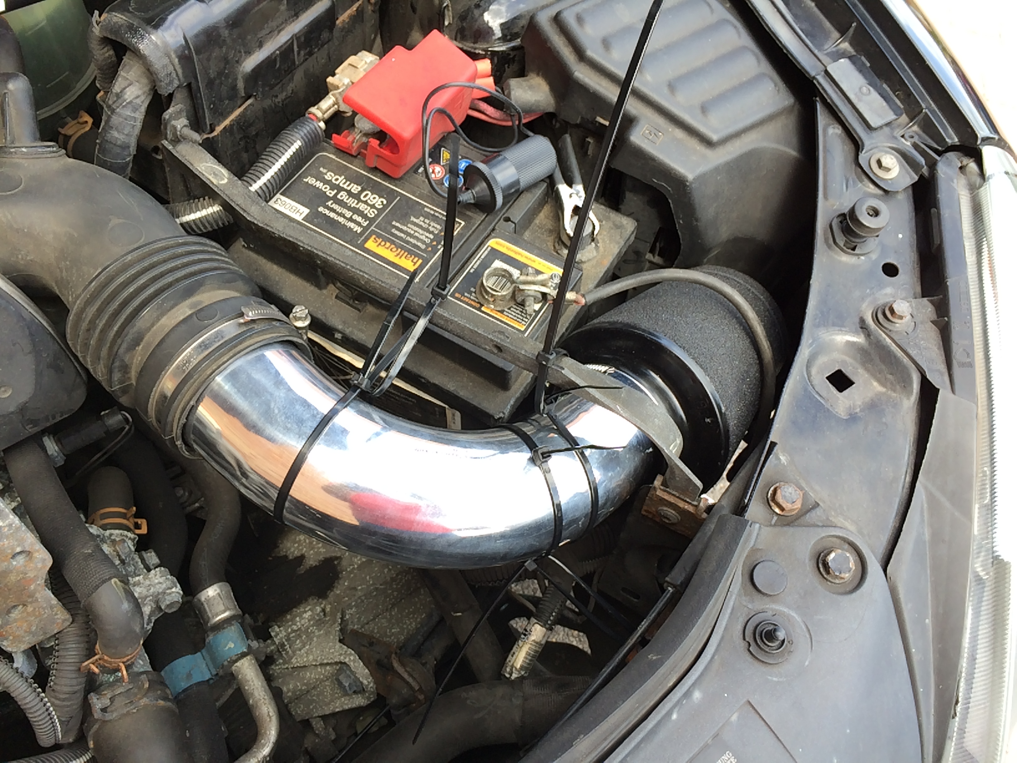

So the last bits to buy were the Fatty's induction kit, which is just awesome value for money, and the RSTuner remap. I also decided I wanted to strip out a little bit of weight and improve the brake cooling, not because I'd had a problem since the DS2500's went on but just because every little helps and to be honest it was a bit of a project to fill another on-call weekend with.
Induction kit fitted:

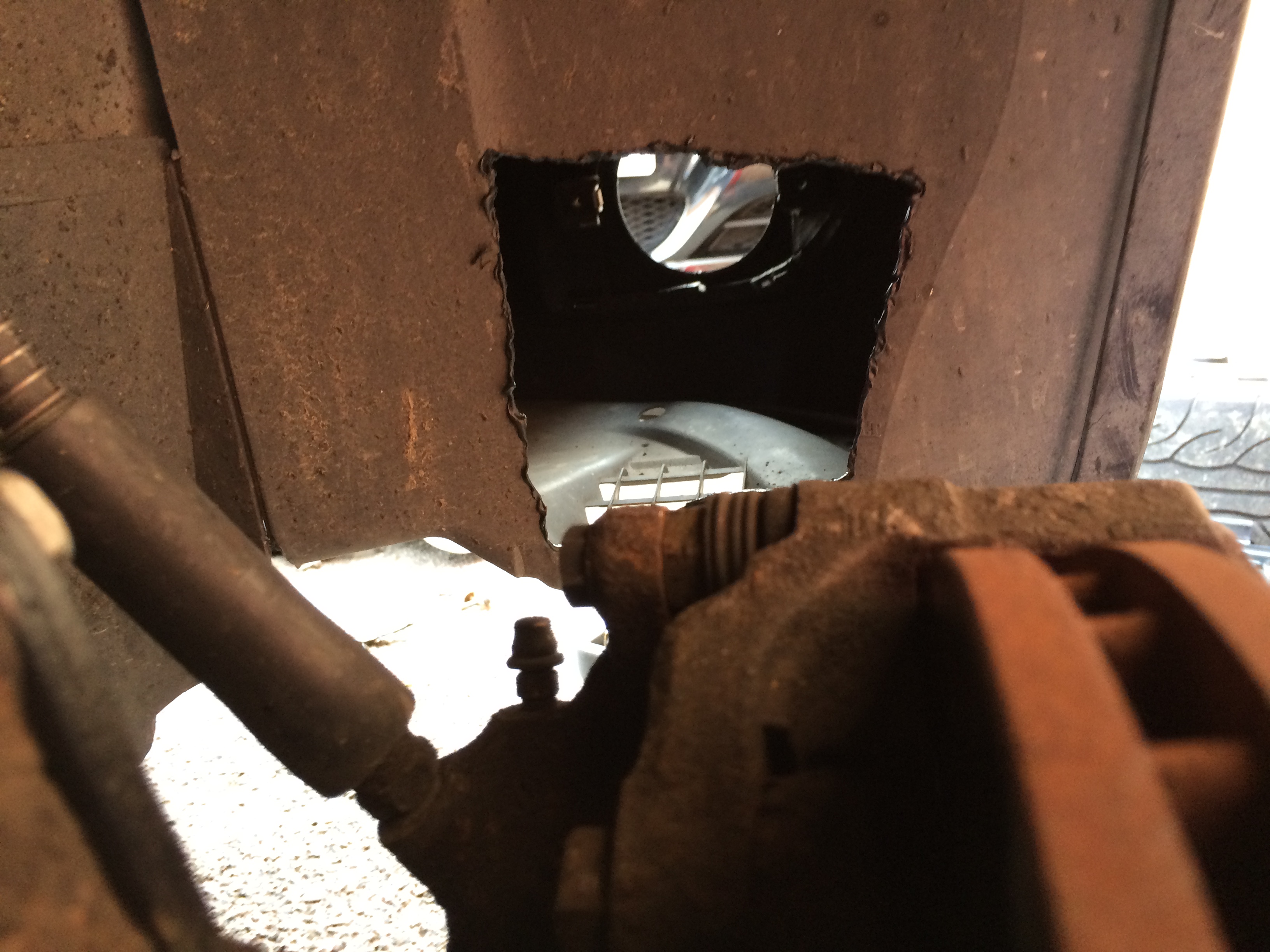

Wheel arch liners modified, carbon canister and original intake pipework both removed, foglights removed, horn relocated, all to give better airflow to the brakes:
I know it's not as good as proper ducts with deflector plates, but it's not like I'm actually competing in the car so hopefully this will be more than sufficient.

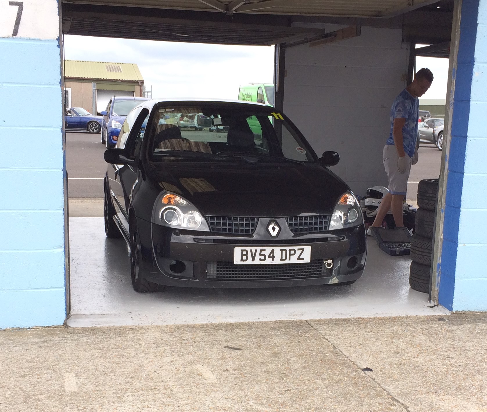

Then off to Thruxton!
Definitely not as good looking as before I took the foglights out, which is a shame, but hopefully the improved brake cooling makes up for it.
Thruxton is definitely not an ideal track for the 182 because it's so quick, but I still had a great time. The intention now (and, yeah, I know I've said it before ;) ) is to run the car as-is for the next year or so and then decide what to do.

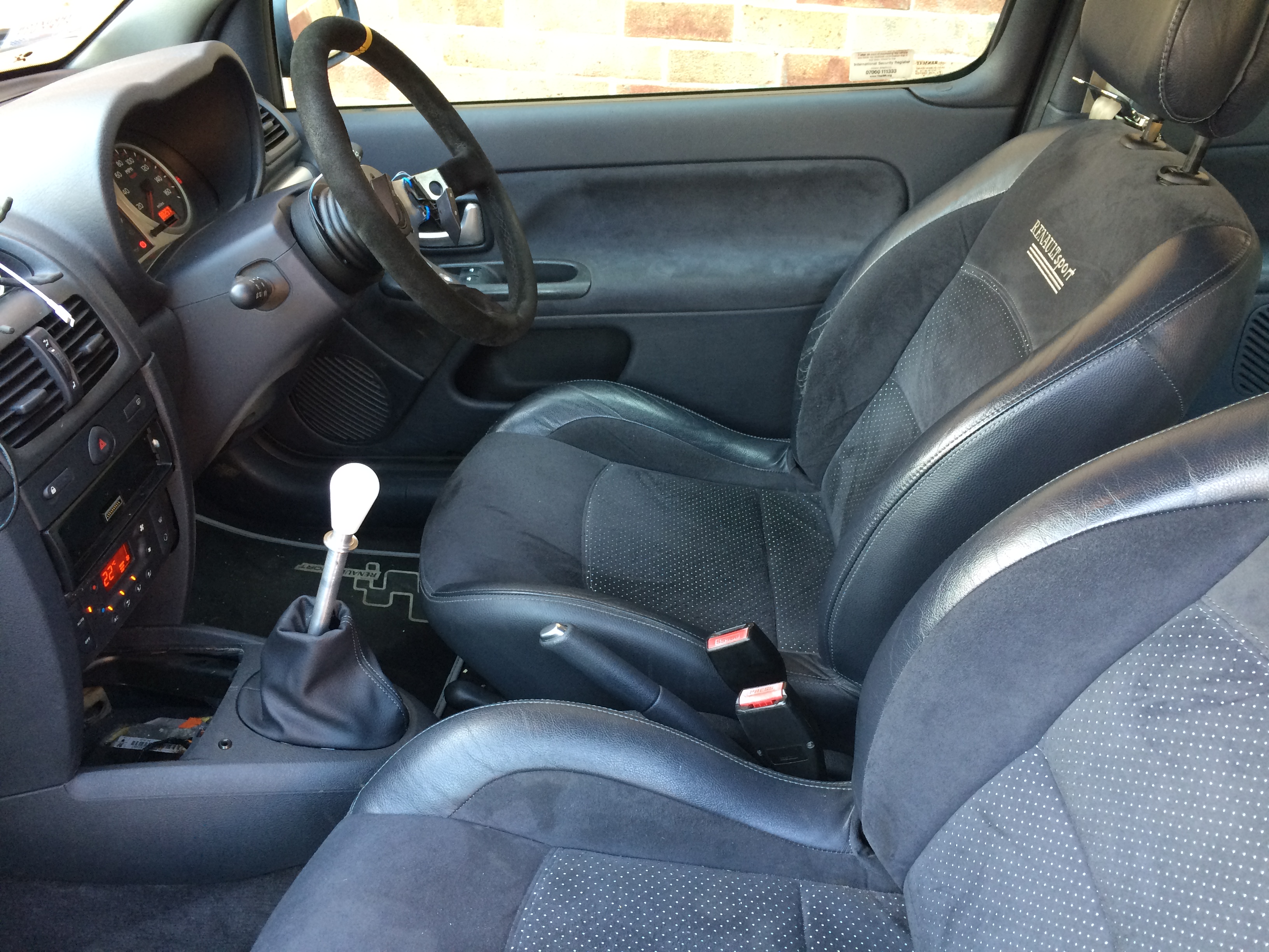

Which is one way of leading into the latest mod, got my modified Scenic shifter from Ash fitted today. I've only had a very short drive with it on the car but it's great, the lever falls to hand much better than the original one and the shift is hugely improved. Looking forward to trying it out properly at Bedford on the 20th.
I've also fitted a CG Lock which even on the road I've been very impressed with, keeps you held in the seat much better than the belt without one fitted. Will be interesting to see how much difference it actually makes on track.
