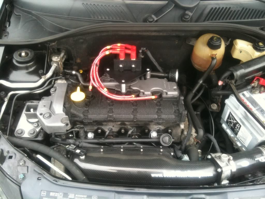

That falls under the same "it costs as much as the car" grouping as getting a set of cams supplied fitted and mapped, but I really like them, its transformed out one fitting an RS2 :)
Looks good too :)
This is our one that my mrs fitted a couple of months ago:

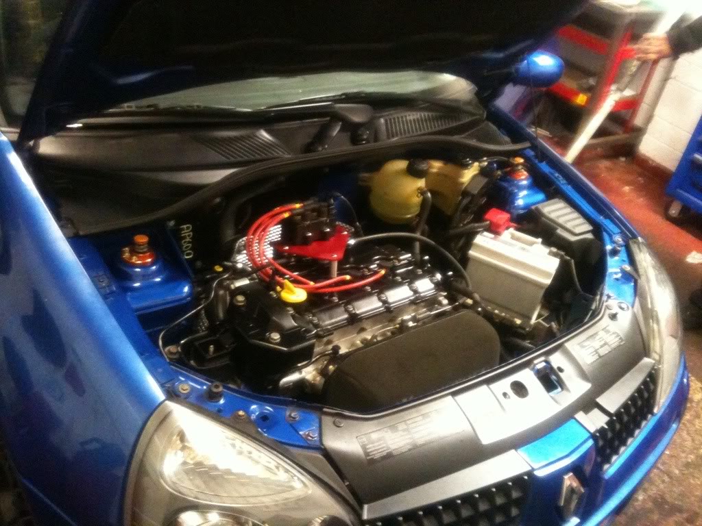

Chip, that bay looks lovely!
Yeah man, she has done a great job.
This was it when she first fitted the RS2:

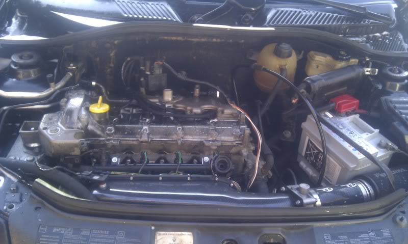

pictures below.
thats gagging for a new coolant bottle! would make all the diffrence

pictures below.
