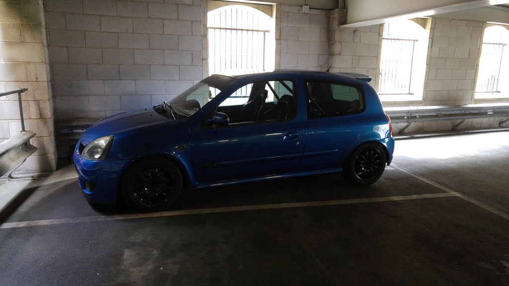

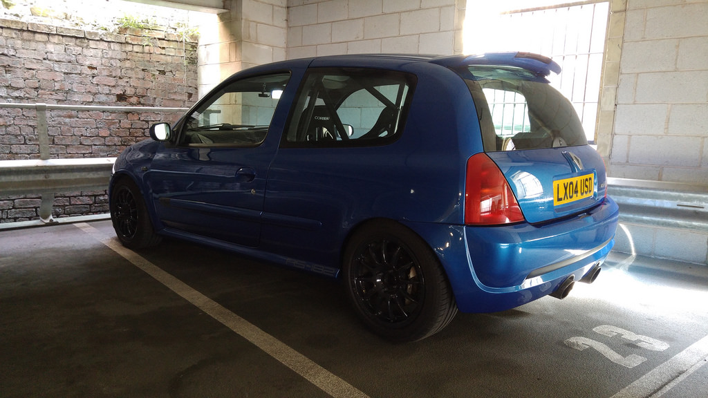

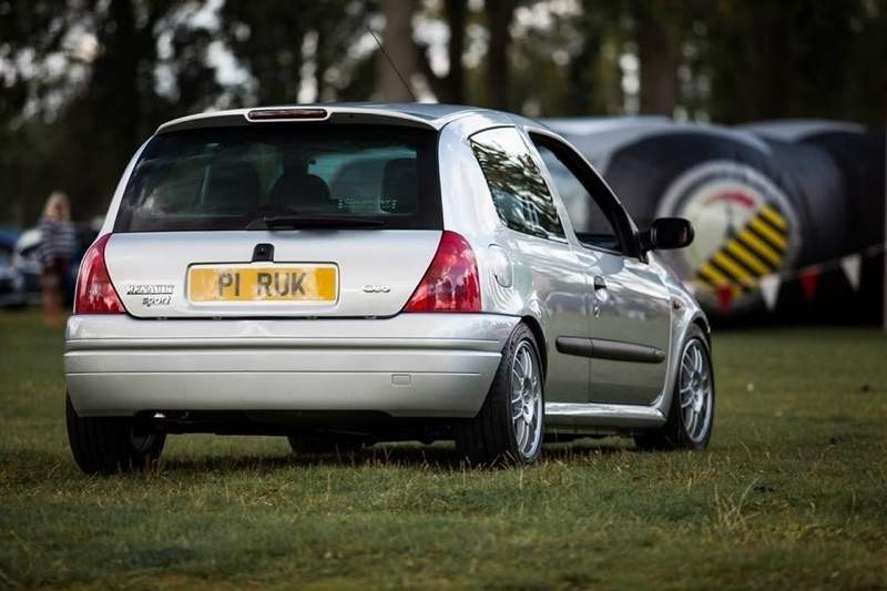

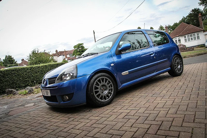

This is B14's with the adjuster rings and rubber pads removed.
I have since fitted the adjusting collars and raised the car about 20mm rear and 10mm front and feels much better for it. If you want to go any lower than B14's allow then sell your Clio and buy a VW lol.
Thanks for that, that looks a good height actually! Definitely looks lower than my Cooksports
Just be nice to have the choice to go that low, not saying I will, but at least I can have the choice
mikekean
  996 C4S, 135i, E30x2
No problem, i think i was pulling away in that photo so probably sits around 10mm higher in the rear static but its a decent height for aesthetics without being slammed.

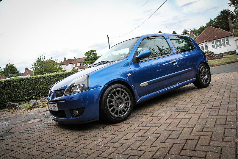

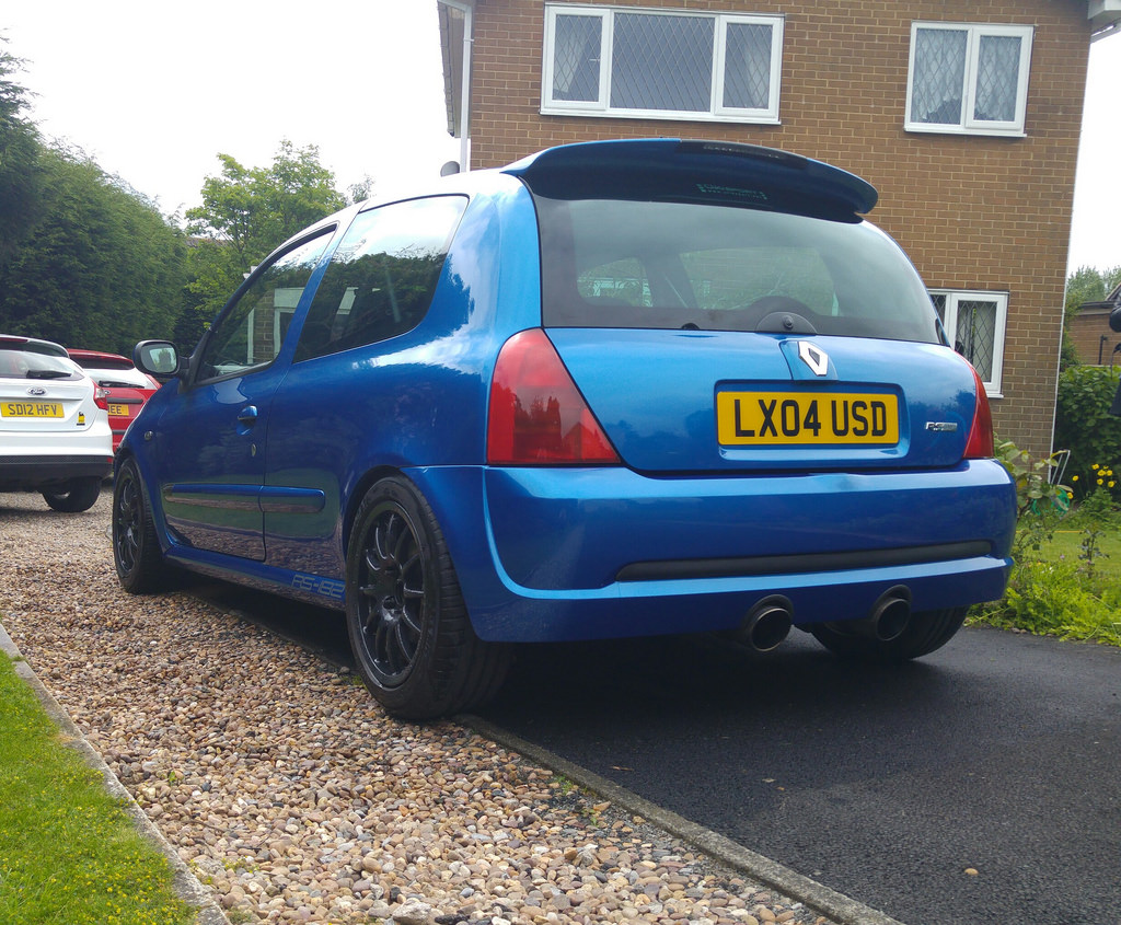

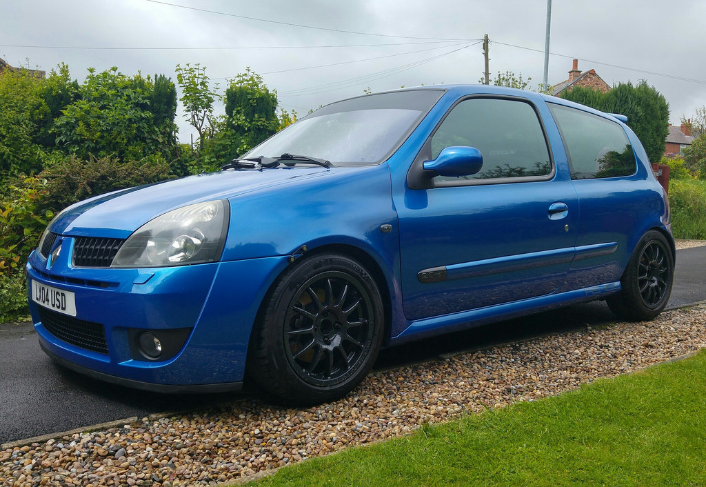

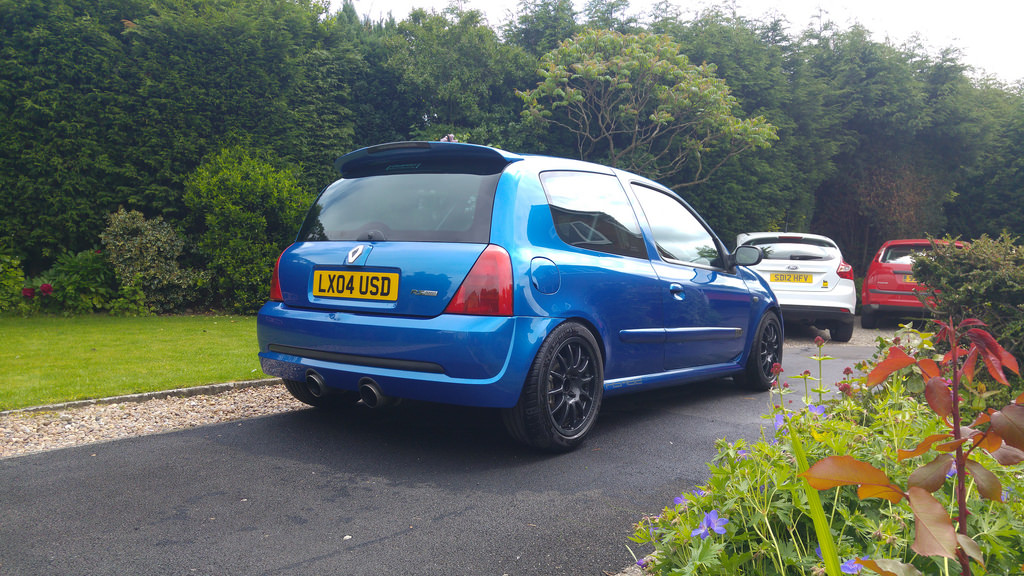

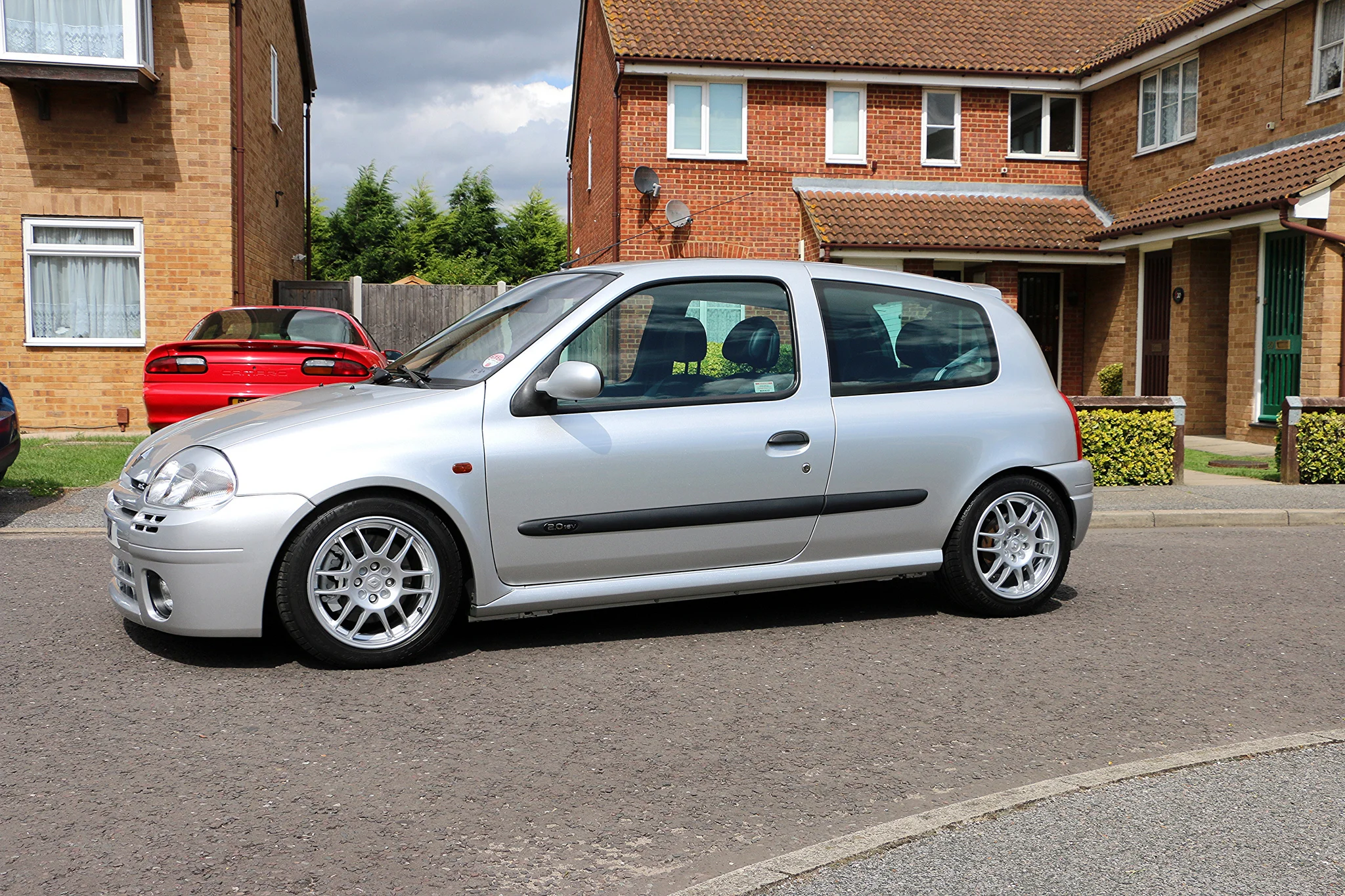

Anybody else got photos of a B14's and how low they go on the back?
this is without the adjusters in
20160530_173538 by dann2707, on Flickr
20160530_173603 by dann2707, on Flickr
20160530_132149_HDR-1-1 by dann2707, on Flickr
20160530_132102-1 by dann2707, on Flickr
20160530_132043 by dann2707, on Flickr
10mm spacers on the rear too if that helps at all, ET of wheels is 40.

Cheers Dan, your a star!
Would there be more or less arch gap if I'm running 16's (45 profile tyre)? Don't know if they would sit lower on your 15's, or how it works quite
Although there is an inch difference in the rim diameter the side walls of 15 inch tyres above is 55mm compared to 45 on 16 inch wheels. There isnt any difference in the real world but technically yes the 15 inch wheels setup is 2.5mm lower.
Cheers buddy, was getting far too complicated for my to think about haha
