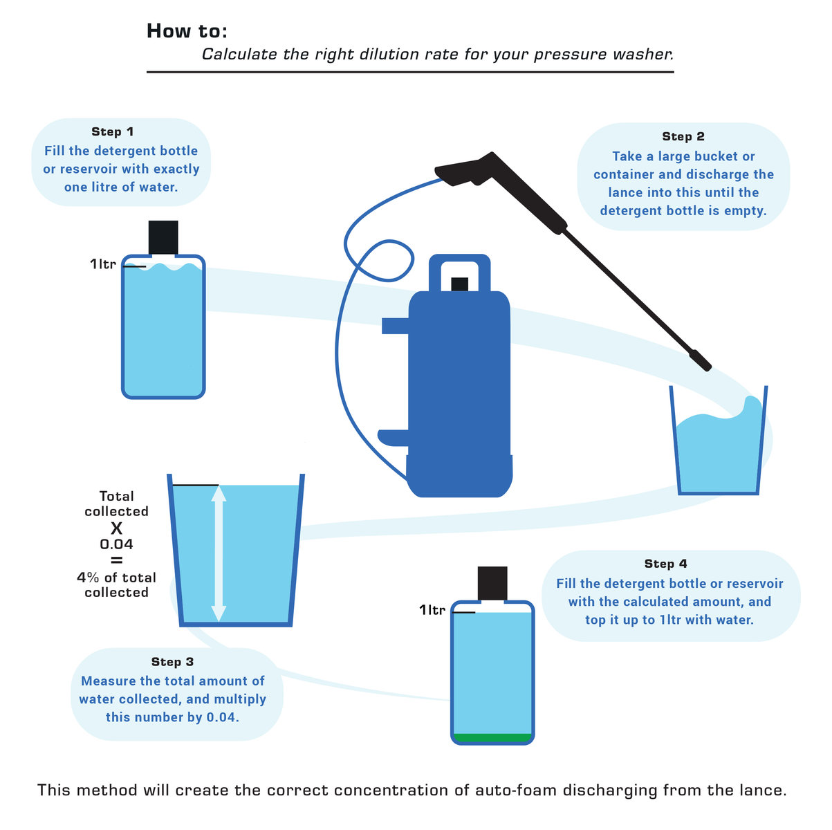

I seem to remember the dilution was 4% of product on impact so you'd have to use your specific pressure washer/foam bottle, empty a full bottle (filled with water) and then measure how much total water is in the bucket to calculate how much autofoam you'd need in your foam bottle.
Did the test a while back and think I needed something insane like 650ml in a 1 liter foam bottle to get to 4%.
Pricey but if it actually works might be worth it?

Actually found the picture with the correct method, think I got this from the Bilt Hamber website a while ago.
This method has been discussed on here before but was largely discredited. I didn’t really follow why though.
You’re not going to be using that whole 1L in the 1 application though, no? I only use about 300ml of mixed product per use. That covers the whole car and wheel arches. I don’t see any point in using more.
MLB
Ah don't think I've read that thread, I'd think just diluting it further will still work, just not as effectively. But if you don't need the full cleaning power I guess it would be a waste to use it at full strength. Dilute to suit?
Reading an in depth review on detailingworld does give the impression that auto foam in the advised dilution works even when only just getting the car wet, then actually becoming quite economical.
As you said, you don't need to use a whole 1 liter bottle for one car.
You should be able to use it sparingly at 4% PIR and therefore get multiple applications from the 1L bottle.
