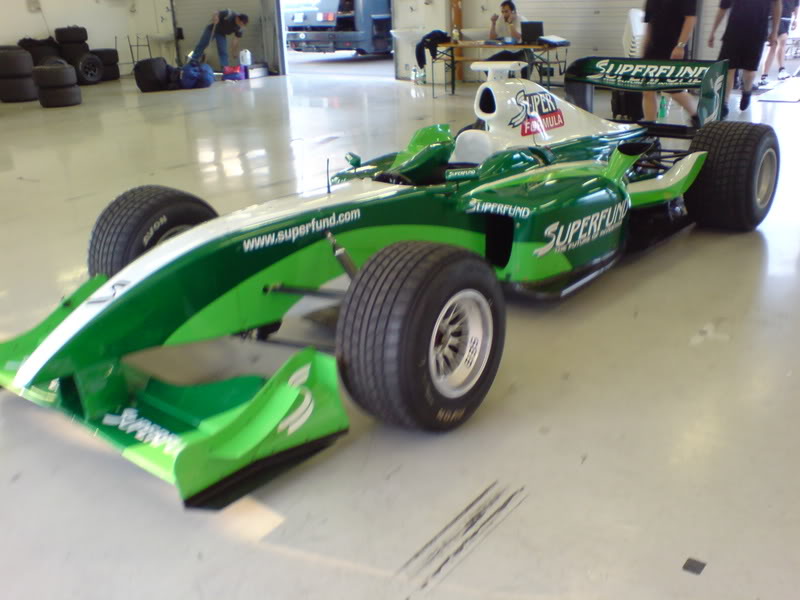

what do you want to know? we ran this old girl on E100
your injectors are too small for starters, the car isn't mapped for it
you would have to test it on the rubbers and plastics first
but it would "run" on it as is yes
The fact it is 105ron means very little.
It has a calorific value about 30% less than petrol, I doubt it would run on a map set-up for petrol.
its certainly the future IMO, we were using just under 4L per lap round hungaroring!! had to keep flushing the bag tank and inspecting it
