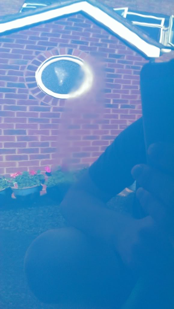

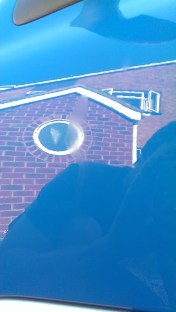

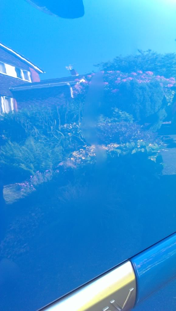

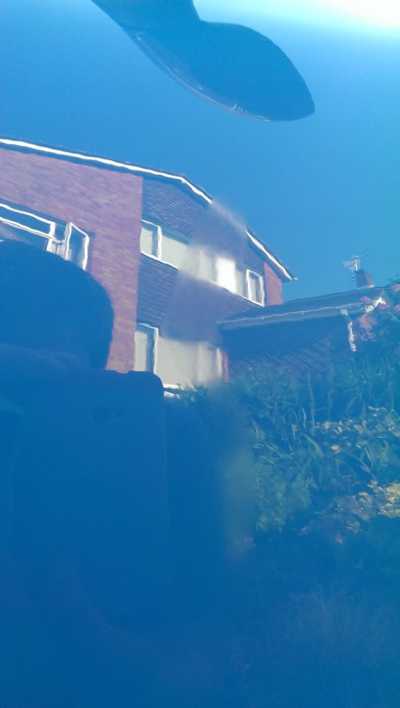

Came out this morning to find a nice bit of bird s**t down the drivers side door.. so i took it down the garage and blasted it off with the pressure washer and gave it a wipe with some QD.. but i could still see the outline of it, I can't feel it with my finger but its like the clear coat has cracked/really bad orange peel. Ive just been out with some AG SRP as that's all I have and it won't even touch it. I've tried to get some photos but its hard. Advice please, worth getting an abrasive polish? Or going down local bodyshop with a DA?

Get some polish.
Gtechniq P1 is available in small bottles form various places. German applicator pad and a microfobre cloth.
Cant really tell how deep thats gone from the photos.
Yup bird crap is so bad for paint it eats in to clear coat fast , I came back from 2 weeks away to find my ds door covered in bird sh1t had to buff it with a cutting pad and compound to remove it

Ive tried auto glym super resin polish but guessing its not harsh enough.
You can hardly feel it on the paint.
  Not a 320d
SRp wont do much mate. You need a compound or polish. SRP only has very light abrasives in it.

Pop to the local bodyshop see if they'll give it a polish for you.
It might also come back if it's sat in the heat. Lacquer has a memory so to speak.
You left the birdpoop in the sun/on the car too long. Can't be helped sometimes. The lime just eats into lacquer.
