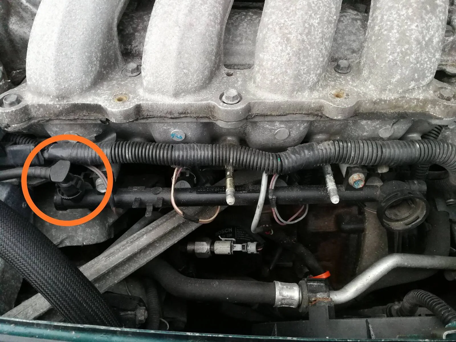

After a minute or 2, noticed a pin hole leak in the pvc/rubber feed hose to the fuel rail- couple inches to the left, of the left hand side of the orange circle. (Pinched photo from another thread)
First- would a pin hole leak cause that much lumpiness? It was jetting out a couple inches. so assume pressure must drop a bit
Secondly- rather than replace the whole hose which looks a bugger to do, could i just seal the pinhole leak somehow? Heatshrink, or fuel proof tape of some sort. some other sealant Even is its just to see that the leak was the cause of the lumpiness.
Any advice appreciated

Right- Ive tried several ways of repairing the pinhole leak: Heatshrink, ptfe tape Didnt work
but then ended up cutting out the leaking section first tried a 7mm internal joiner, and tried couple other joiners. Didnt work
Tried several sealants with the internal joiner pieces- didnt work
Even tried silicone to help seal- just turns into a gooey mess (Be aware that just turning on ignition causes a fair old spurt of fuel)
Have now got a "push union" plastic fitting on order, but dont think will last cos petroleum is soooo corrosive
Getting to the end game now (Prob where I shouldve started) and looking at replacing the whole pipe to the fuel rail feed section, where it runs down underside of engine and underneath somewhere, where i believe there is another style connector
Will keep thread update as it may help someone
Fuel pipe (Thin hard plastic under a rubber covering) is 8mm ED and 6mm ID as far as i can tell.

Have now replaced fuel line (Right bugger, had to cut off the connector with the 2 green press in tabs) as it was leaking, but hasnt cured the lumpy running problem, although not given it a good run.
As it wasnt running lumpy b4 the gearbox oil and engine oil/filter change, I will have to consider another possible issue
Feel free to add: Coil pack, leads, plugs, faulty injectors, dirty injectors, faulty connector, faulty sensor
Any other suggestion appreciated
Cannot vouch for the fitment question but had a issue where rats and nibbled both plastic pipes by the fuel tank and I had exactly the same running issue and jet of fuel . Of course one pipe is discontinued and the other is in France but most likely swiftly removed from a Ukrainian warehouse the contents of which could be anywhere in France according to the dealer and Renault …..it’s in French stock but no idea where . So I bought used ones from Clio man in Littlehampton.
As far as the running issue is concerned before you start looking at the amount of other possibilities you have come up with and no doubt others will too I would look at confirming your pipe does not have a minor leak that could let air in and then as with any other problem that has arisen following doing other work I would just go over the motions of what you did prior to the running fault making sure everything you previously removed is back in the right place and nothing in the working area was accidentally dislodged broken etc etc . Always start with the basics .
