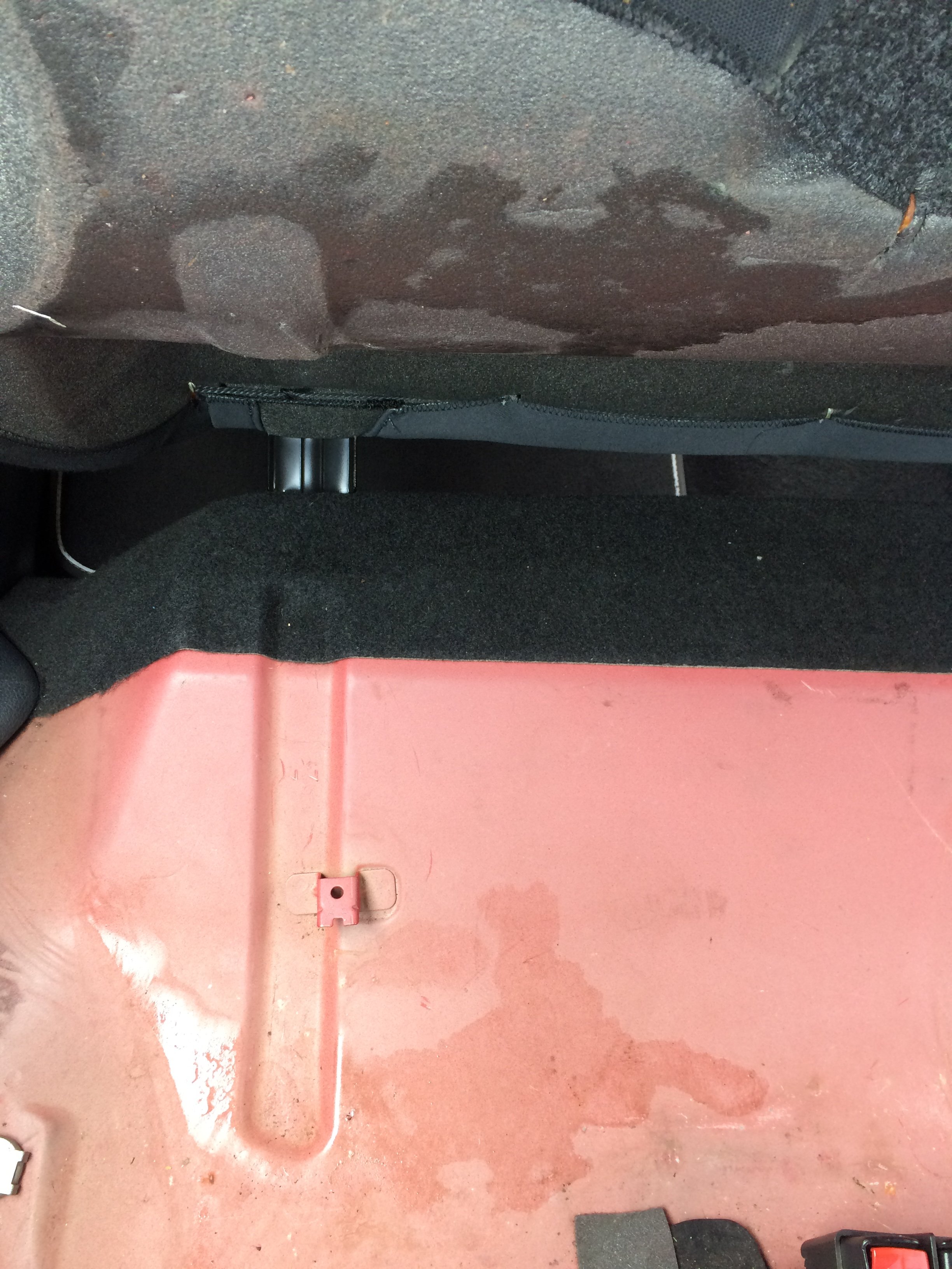

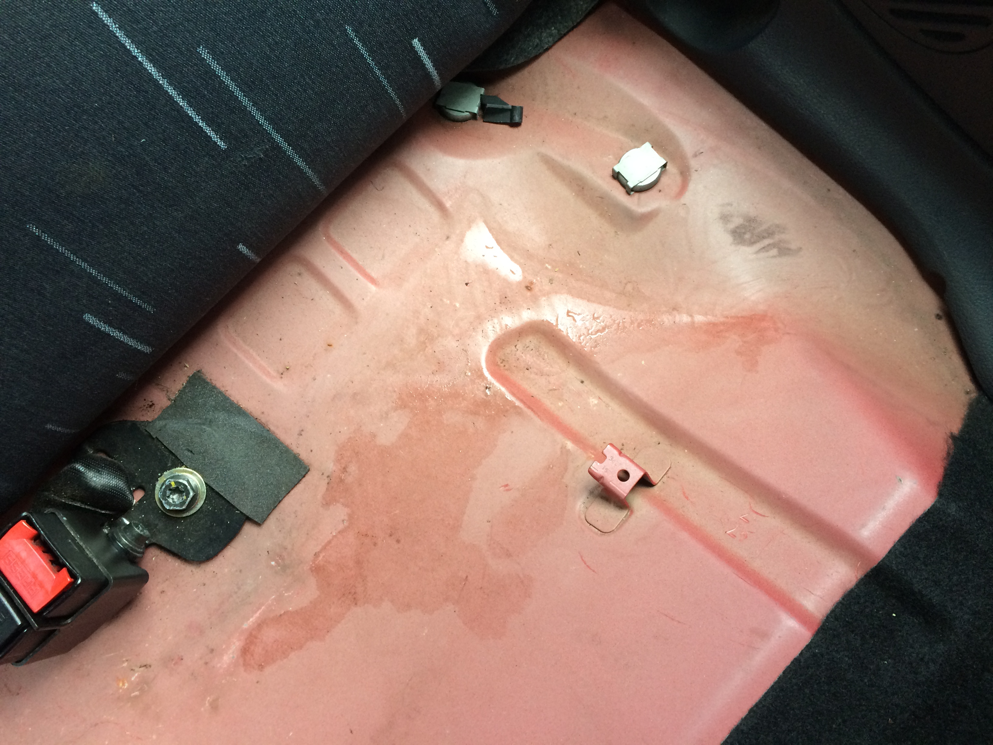

I noticed a bad smell when I put my front windows down and upon investigation found out that it's likely to be coming from this little wet patch underneath the rear bench. It's a small amount and I'm airing it out, and the bench, so that hopefully the smell disappears.
One question though - how would this bit have gotten wet? Is there a drain that could have been blocked maybe? Or a slight gap where water can get in from the arch or something?

It started in the boot... One good brake and its then in the rear seat. Builds up another good brake and its in the front.

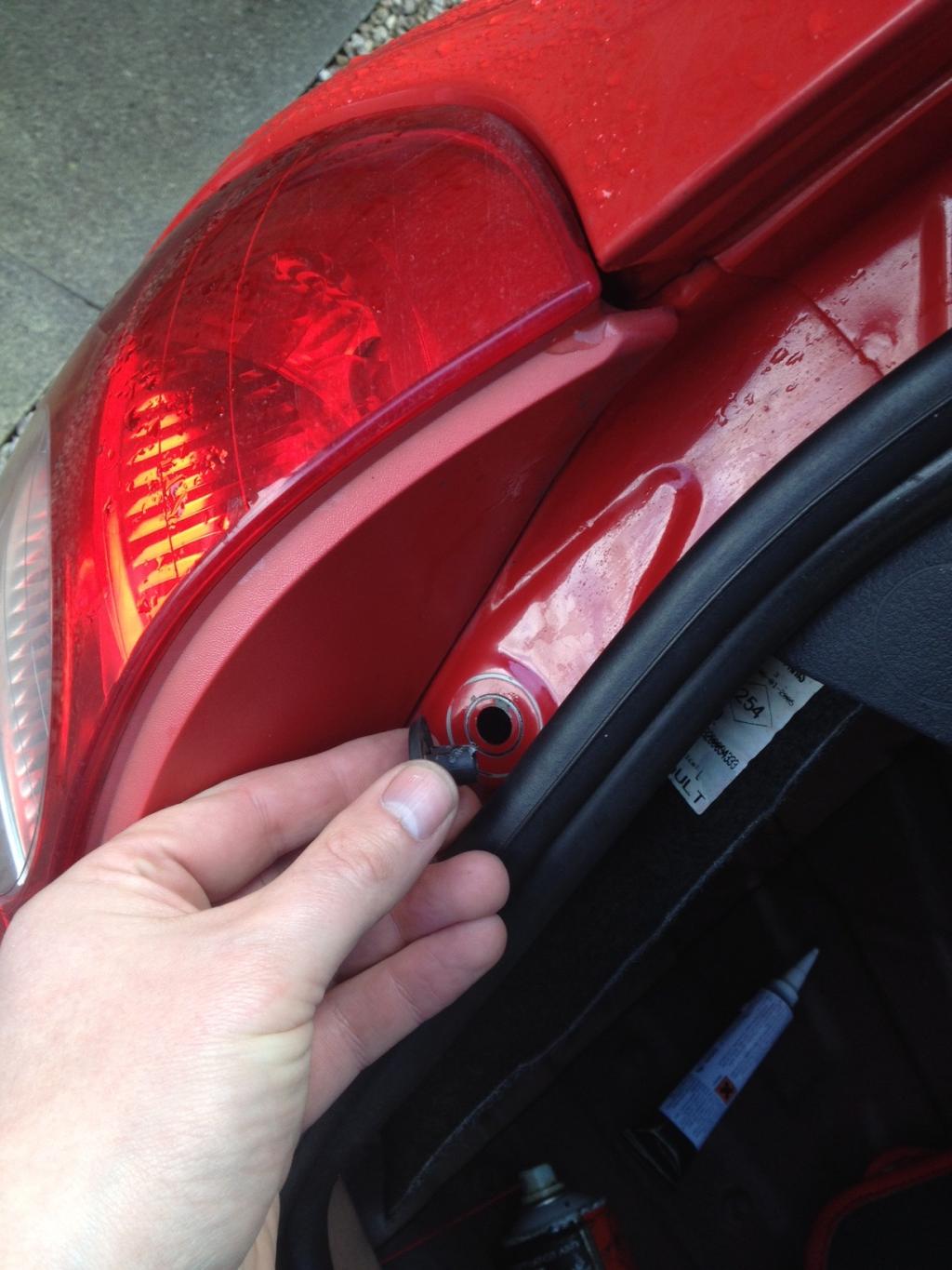

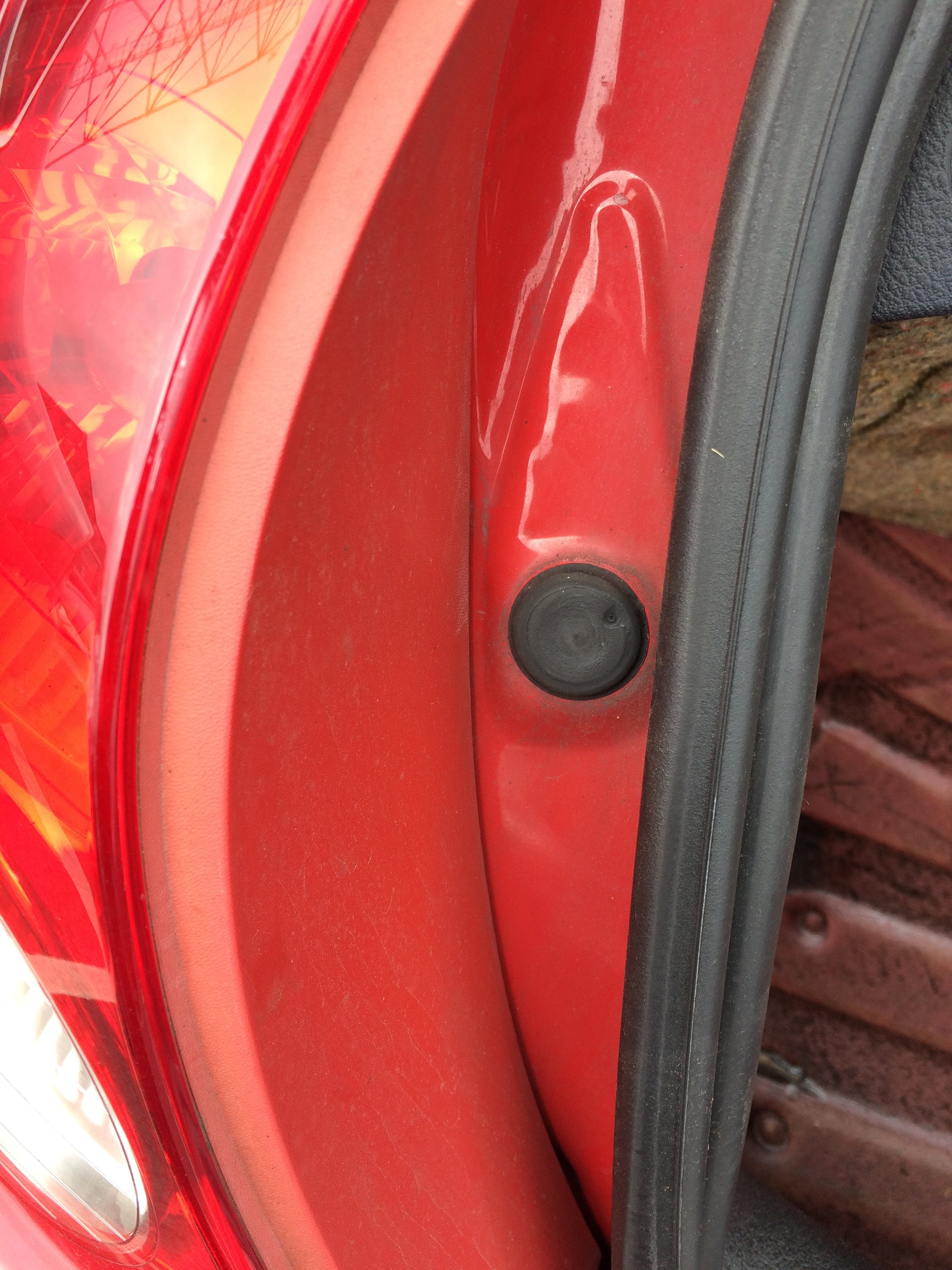

Do you mean the rubber 'strips' along the boot? Just had a look and there is now water in the boot. The stench is enough to make me want to scrap it and get something else!
Is it these bad boys that need siliconing? What's the best way, silicone around the hole and then refit these? Or just sack them off and seal the hole up.

57p each buy two new ones ;).. destroy the old ones pulling them out and silicon the back of them for added sealing.
57p each buy two new ones :wink:.. destroy the old ones pulling them out and silicon the back of them for added sealing.
Can't I silicone the existing ones or do they break on removal? I hate my local Renault dealer so I won't be using them.
  Ex 182 owner
I added extra to the underside of the stop. The problem i would say with removal is you will damage them a little bit so they wont sit tight on as they do when new. The silicon could over come that but for a quid. Is it really worth it?

Take them out, from the inside. Clean the outside surface .. Silicone/something similar all around the hole. Put the thing back in. Clean up any excess and shut the bootlid.
