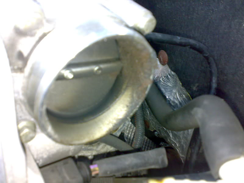

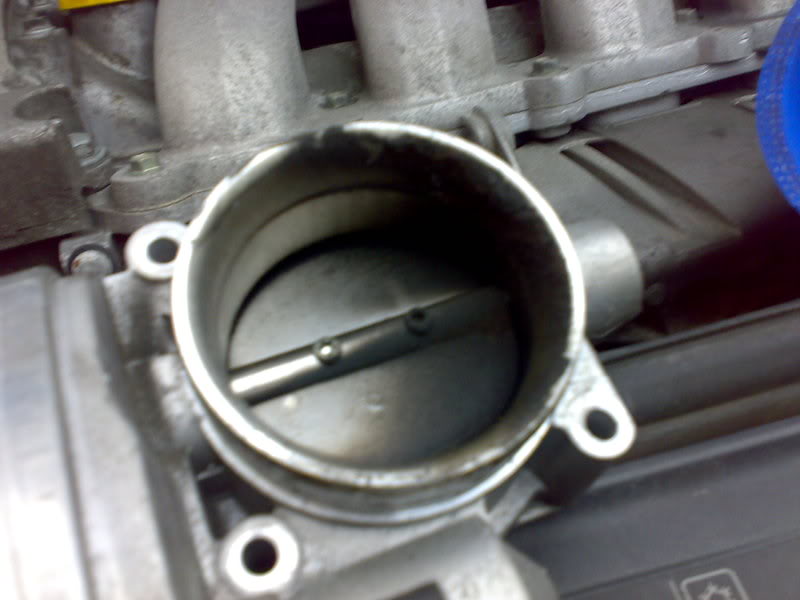

car started feeling abit under powered and very lumpy on idle so decided to change the plugs and give the throttle body a clean, this is what i was presented with: -

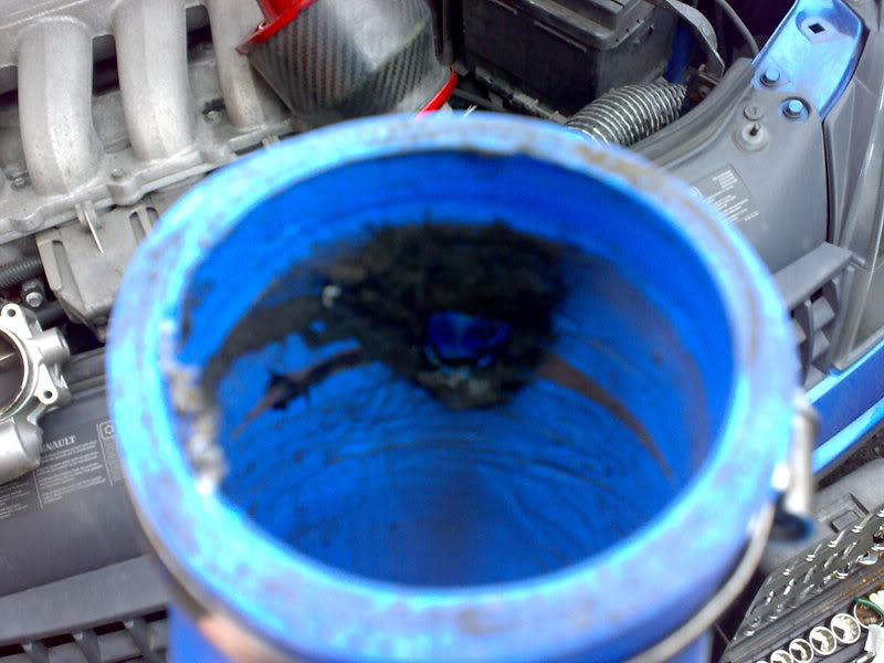

it was like fur and very thick, clearly coming in through the breather on the hillpower bend, so took them both off and gave them both a good soak in carb cleaner and a good scrub.

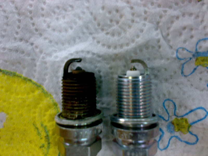

then I moved onto changing the plugs, I call No. 1 the one closest to gear box, plugs 1 and 2 both had eroded electrodes as can be seen in the pic, new one on the right (obviously). plugs had done 52k running standard map (now got rstuner map) with viper and cat back, not always ran on 97+ (since rstuner map always run on 97+)
with the tb clean and new plugs its like a completely different car, pulls alot stronger and sounds alot deeper on vvt
guess them hill power bends are cack then, my old throttle body did't have no fur in it, maybe its that viper cack. how long u been runnign the 2 together ?
Running lean as fook?

Whys it melted then? Rich just made my plugs look sooty as hell but never melt!
I'm just trying to see if it's co-incidental that it's started since the map....
looks like its running ok to me looks fairly normal wear wise too.
as for the crap in the breather keep it clear and clean every now and then.
i prefer my breathers to vent to air personally. would rather that then all the sh*t gumming up the inlet manifold.
ideal situation is a catch tank
my plugs and tb looked exactly the same at 52k. like u say different car when its all done
