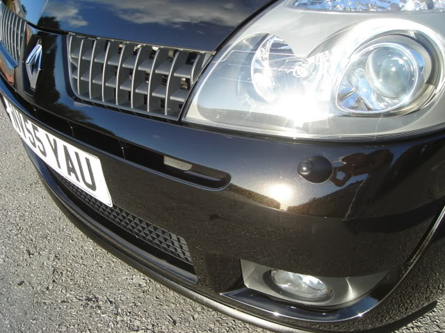

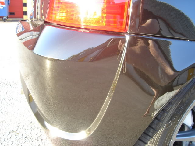

No pics of the rest of the process. The whole car was doen with Menz 85RD on a compounding pad - which removed the remaining marks.I would say the car was corrected between 90-95%. 2 Layers of Jetseal 109 were then applied followed by a layer of Raceglaze 55!
First time using Jetseal and was very impressed with the results - need some Zaino now :p
Sun would not play ball - but some finished pics -
Owner was over the moon! The day after finished the detail however the dent guy came out to work on the bonnet.....
and wiped the bonnet "clean" to rub off any dirt :(:( so bonnet needs done again! But a very enoyable detail nonetheless!

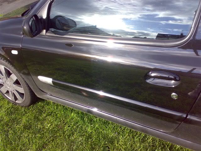

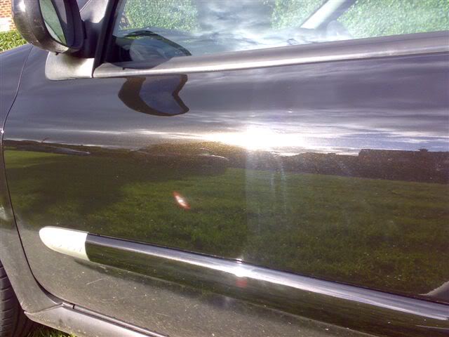

Quick wash down of my door last year and a play with the PC. Right side of the door was as good as i could get by hand, the left side was a few passes of Menzerna Intesive Polish, and Final Finish.
Then did the whole car a few weeks later,
