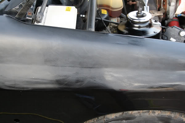

i followed that link and got this affect (bare in mind that this is my first time of using it and only going off Rich's help and other bits and pieces on here. . . )

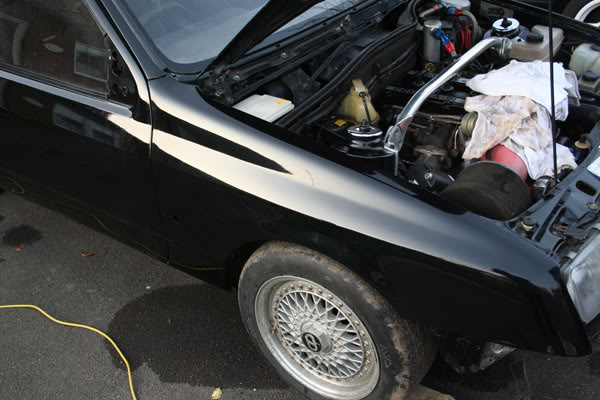

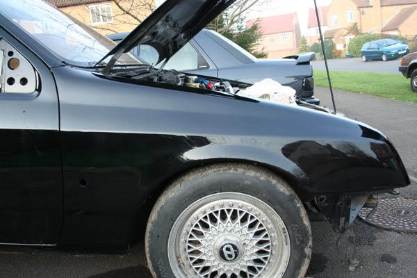

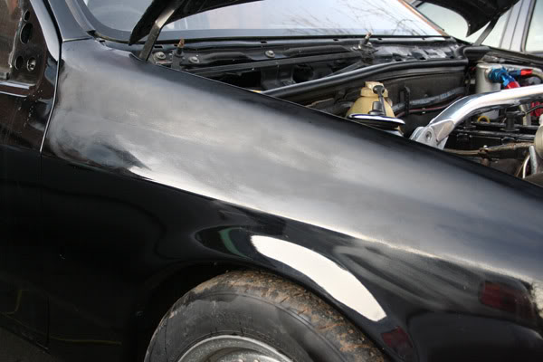

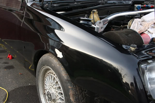

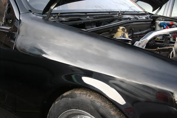

A few pics of mine then ;) - like I need asking!
Black cars tend to show off effects other colours can't. They also show up marks that a silver car wont though. So swings both ways.
http://www.richtreen.co.uk/images/winter182/
This was just after a paint clean and sealant by hand in October, had not been machine polished apart from a few odd marks since last Spring.

link above is the best thing to see what the PC can do, shows from a really scratched car surface to shiny shiny.

No I meant the resolution wasnt the best to show off the deepness of the shine.

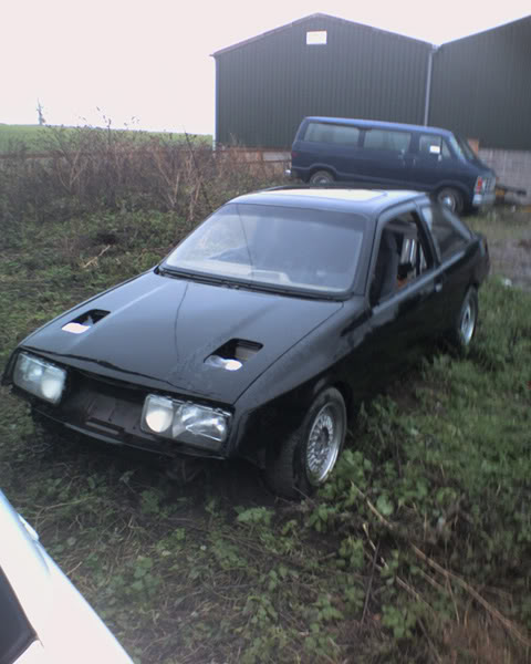

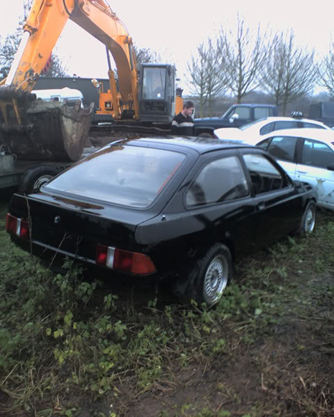

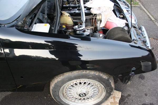

It had been sat in a muddy field for 2 years, half wet flatted as the painter could not be arsed to finish it so the first port of call was to get it polished and protected.
The wheels and arches where done when the wheels came off.
