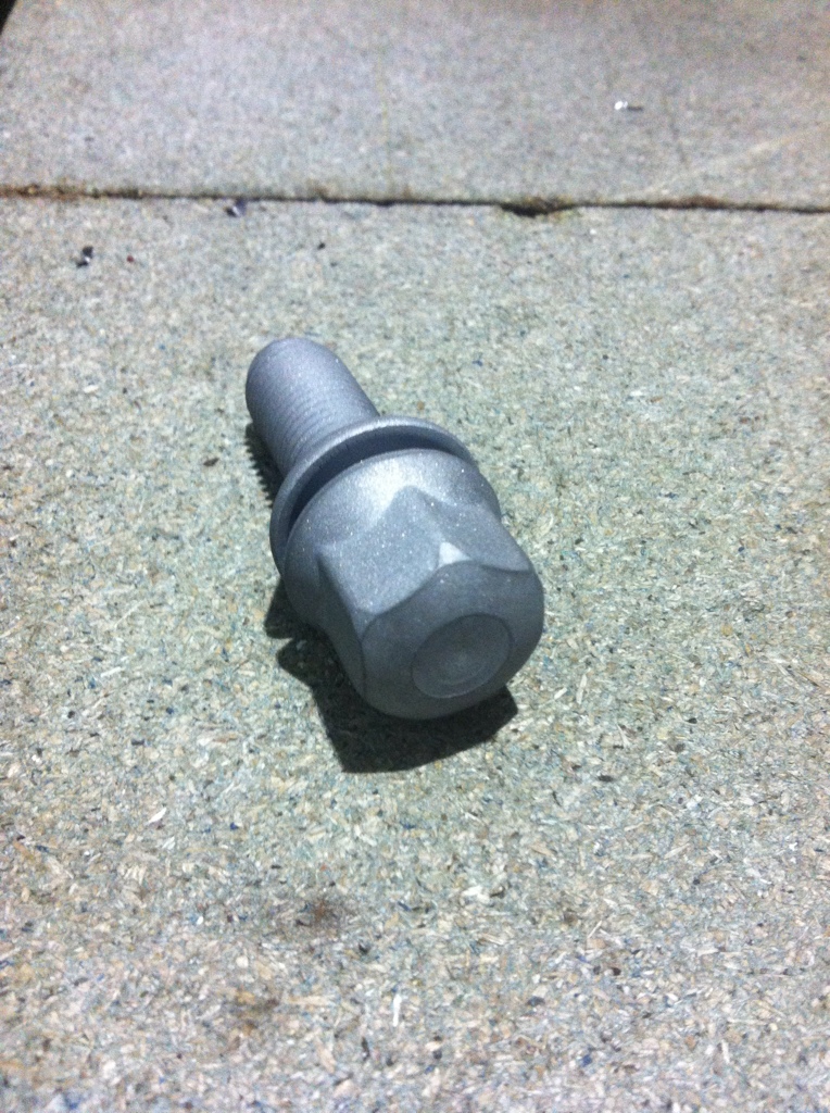

At work we've started a new process that adds a black protective coating to ferrous metals, and I got the idea to refresh my tired looking wheel bolts. I did one at first to see how it came out.

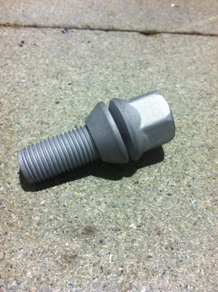

shot blasted and blacked;

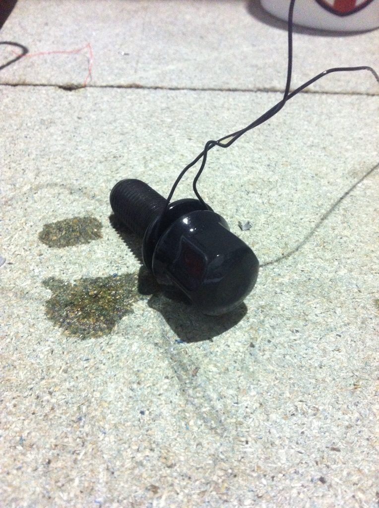

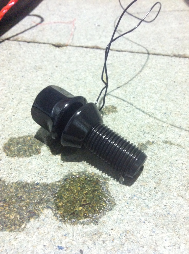

the gloss finish is it in the final stage, it's bathed in oil to 'seal' the coating. I put it in a bag with more oil for a couple of days and here it is finished;

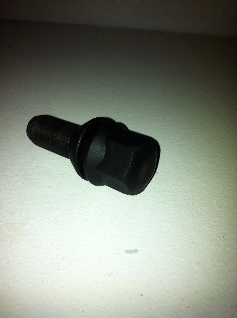

nice and satin :approve:

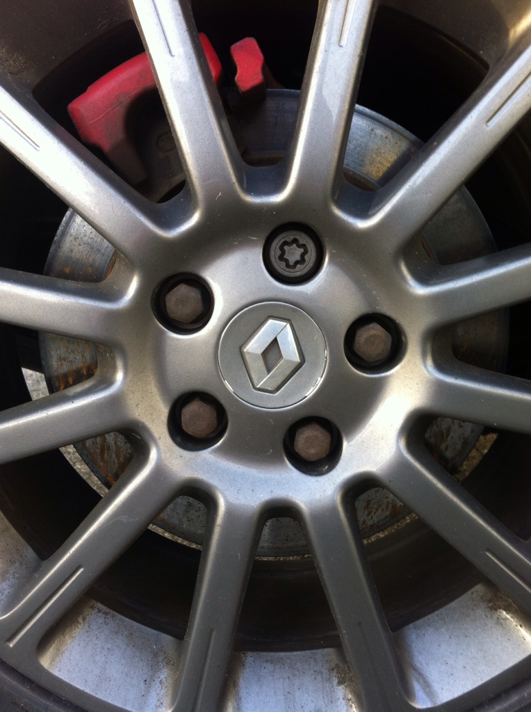

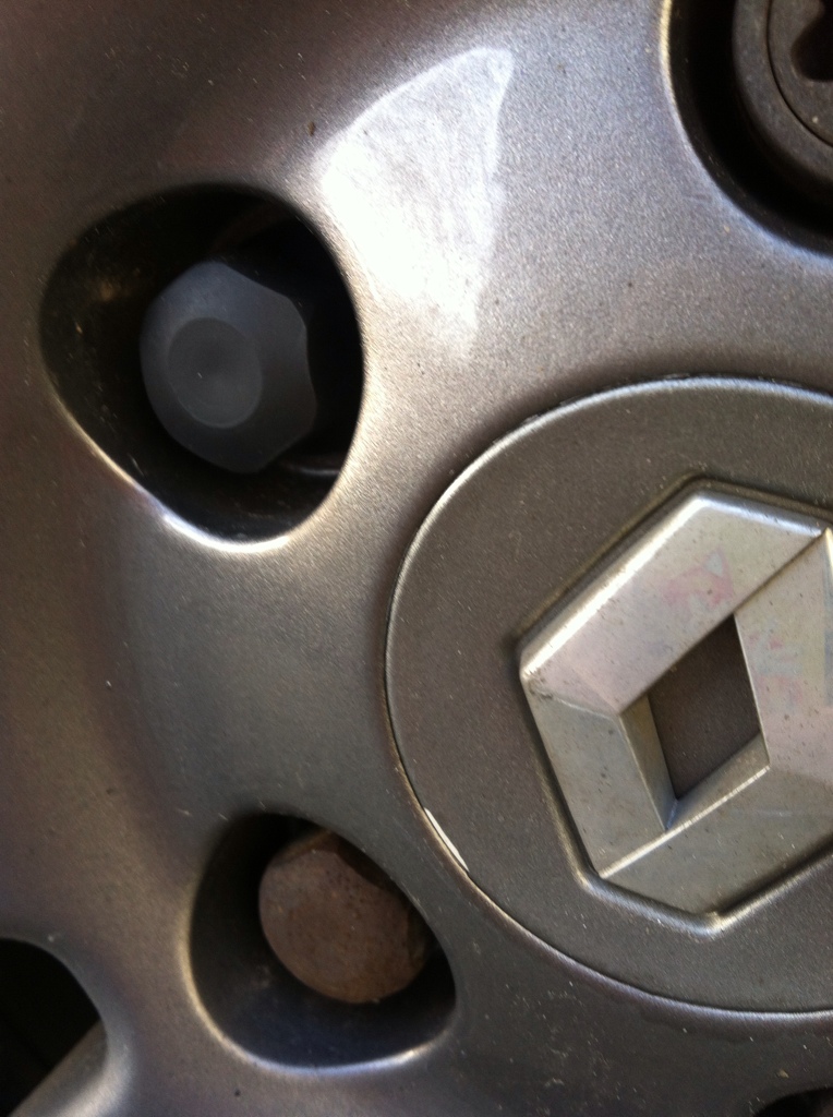

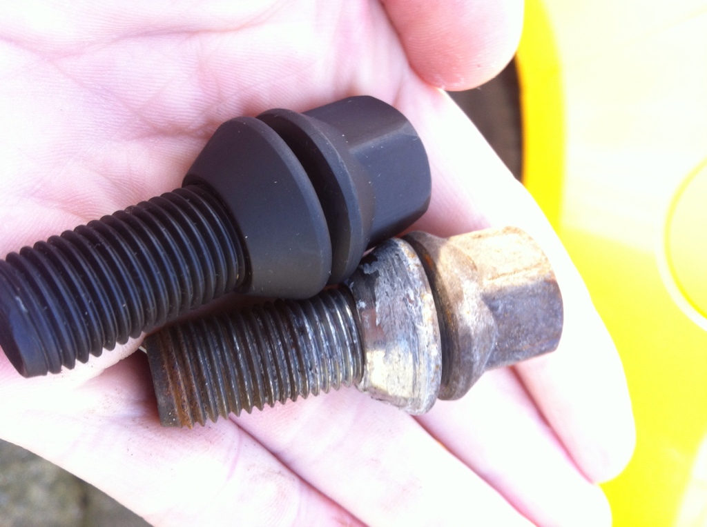

Before and after
old and new

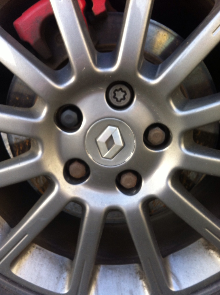

i think they'll look a lot better when the car is clean lol
i think ill do a set a week when I get back to work :approve:

its called chemi black, you degrease it, condition it, black it then oil it, all at room temperature. its a nifty little process lol
How resistant is it to being taken on and off?
no idea yet, after putting it on gently it seems to have 'polished' the black a little bit. may tighten it up properly to see how it reacts

Lol at sharpie :p
Dan, this process usually makes them glossy... But because I did them pretty much DIY theyve came out a bit satin, gonna see how resilient the coating is when I get home :)
plus, the finish of the coating is usually based on the base metal, since I shot blasted it, it was matt anyway, if I polished it up first itd probably come out glossy
