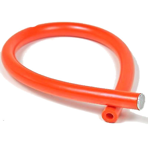

You don't even need an ezi bleed kit, just get a jar with a hole in the lid, length of tube to fit snug over the nipple and just make sure there's enough brake fluid in the jar to start with so the end of the tube is always submerged, works a treat and much more effective over the cheap bleeding kits. If the tube is a little lose just cable tie it onto the nipple.
+1 . That's all I've ever used . One man operartion . I use one of these , cut in half with some tubing in the middle to extend it . One end on the bleed nipple , the end with the rivet into an old jar with a bit of old brake fluid in . Pump the pedal half a dozen times or so , top up the brake fluid reservoir , pump again half a dozen times and that should be enough to remove any air .
http://www.ebay.co.uk/itm/300mm-Sol...014236?hash=item2ea57e4fdc:g:FTMAAOSwMjNTzSw4
The ebay link is just an example . You can usually buy these from any car accessory shop for a quid or so.
