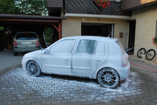

Hello,
new to the forum so i would like to say hi to everyone. I lurke around forum a lot but until now i was to poor to do any mods to my car exception was buying 16 inch canasta alloys that i got cheep. Problem is that with 16 alloys the car is way to high and don't handle very well so it is time to put it on its ass. After all the info i decided i will go with coilovers. I narroved it down to KW v1 which i know will fit 100%, the others are Blistein B14 but i am not sure they make them for my car, the only one i found was for clio mk2 sport 2.0 engine.
So my question is do they make b14 for 1.2 engine and what would happen if i use the kit for 2.0 engine( i think i know the answer to this one but would still like to know from experts).
Thank you.

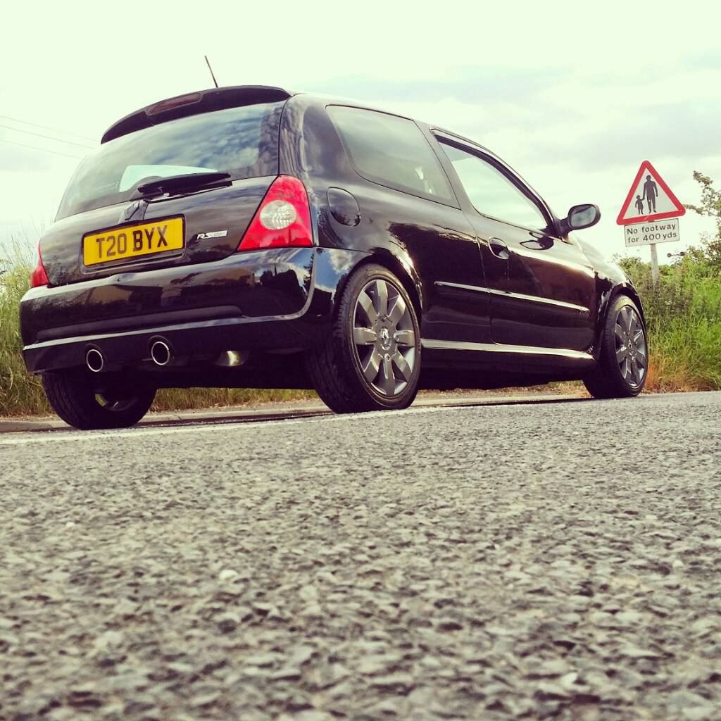

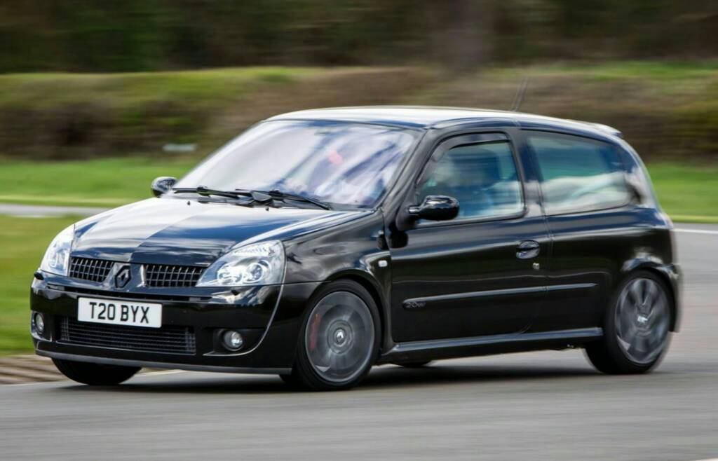

My car on cooksports. You wouldn't want it any lower!
That looks superb:hearteyes:, very nice car you have. I am guessing cooksports springs are only for cup not the normal 1.2 16v?
Cooksport springs are a decent drop. They go on all sport dampers. I'm presuming if you put sport dampers on your car you would fit these no issues and get similar fitment.
