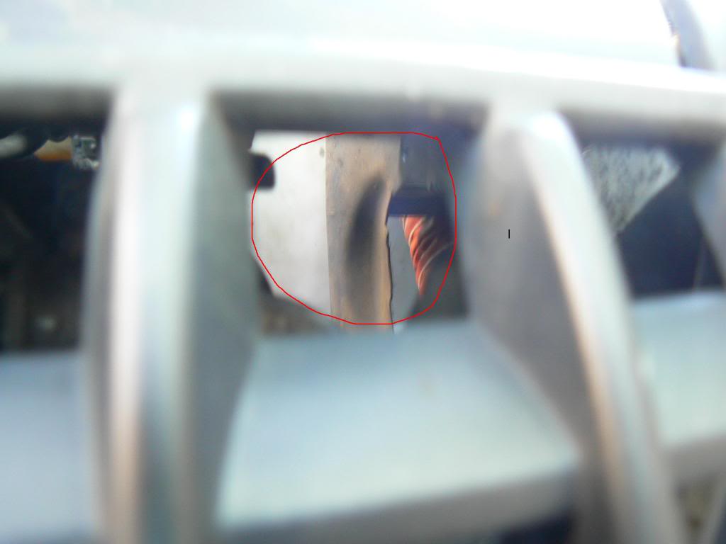

went outside and took some pics. removed the airbox and placed a 76 mm caf just to see how it fits.
this is the the place the caf ends, and the red arrows point to the nearby air sources:

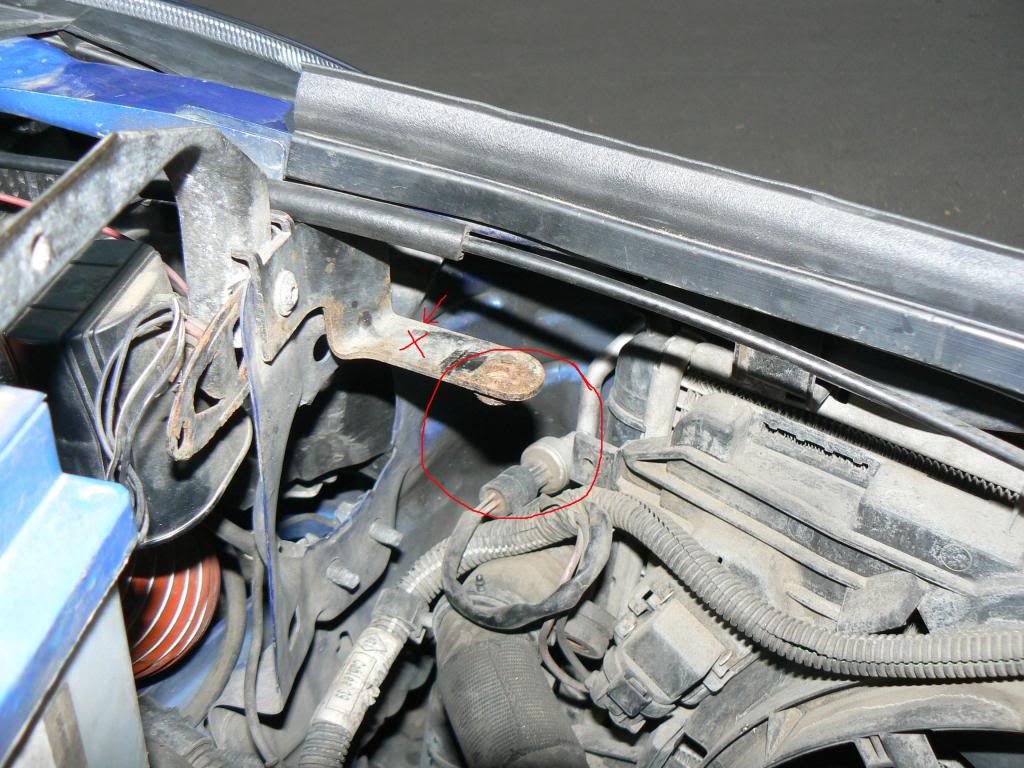

again the spot where the caf ends, and the OE airbox bracket which will be removed:

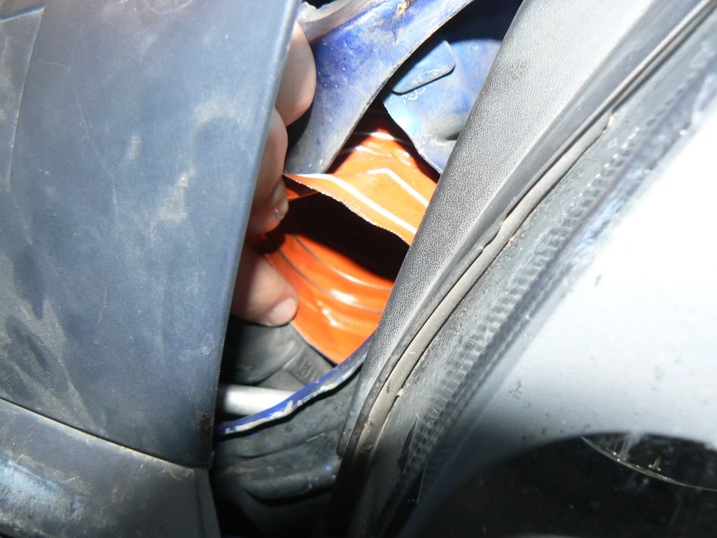

view from the front-left of the caf opening towards the grille:

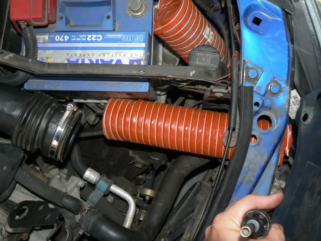

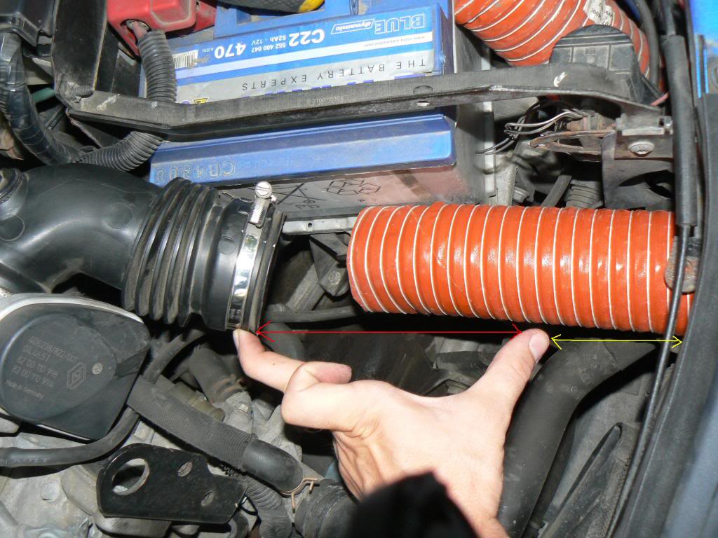

this is the aprox length of the CDA (160 mm- CDASP-08) and the space left in front of it, for the caf to go straight ahead as above:

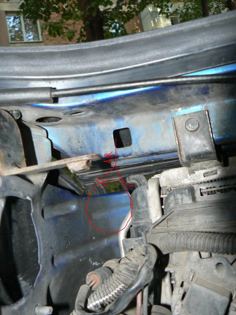

this is the space for the air to come into the caf, it's not that much, but when on the move I'd imagine there won't be any lack of air:
the caf from the CDA is 70 mm, so it won't be that squeezed like the 76 mm one in the pics. I'm also thinking to place some heat insulation between the upper corner of the radiator and the caf, maybe the whole caf even.
Does the above setup seem ok or should I just go behind the headlight for the air source (like the maxogen does)?

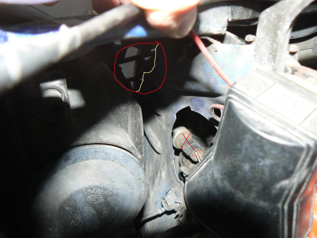

you can see here the curved metal plate in which the second air feed from the OE airbox fits to, and the fact that it guides some air from the grill (yellow line is the limit of the plate in this pic)
so there should be a decent cold air source behind the headlight also.
