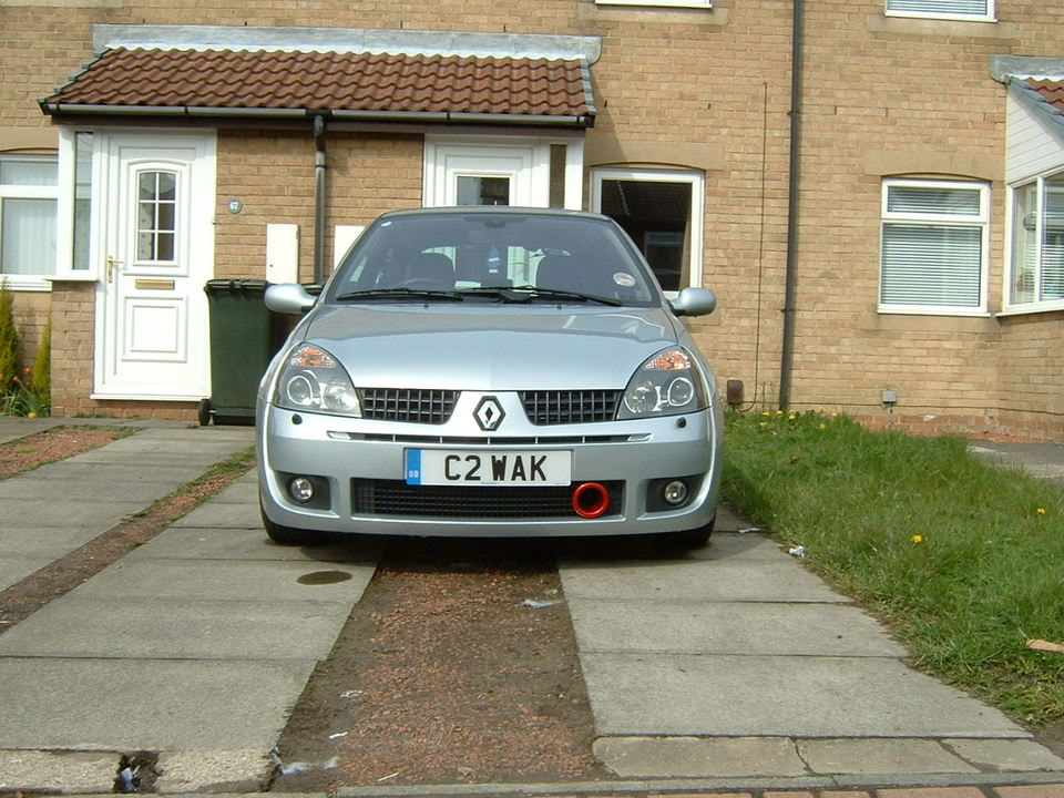

Sounds like a plan, Russ - Do the PiperCross CAF's come with the red end or end to come out of the grill. Do they look something like this that i had on my old 172?

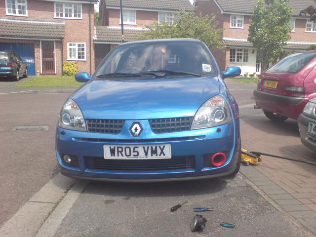

C2WAK Looks cool mate i put mine in fog light surround.
Cheers mate, Unfortunately that was my old clio which i sold a few years back after having a baby. Well my Fiance!. Im planning on putting mine back in the same place on my current RS 172... Just need the CAF Russ is talking about.
