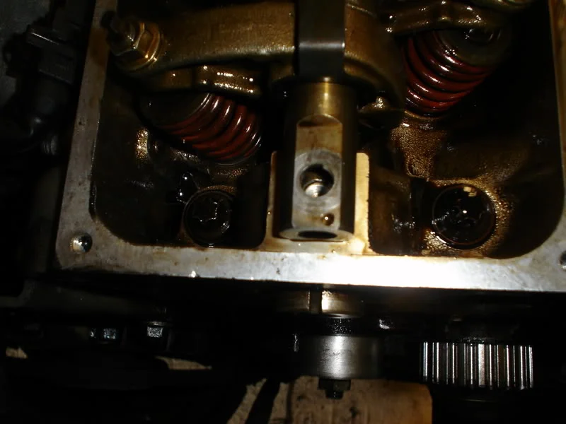

Ok forgive me because im not a mechanic or technical! my dad is fixing my car as it had a bit of a oil leak, took the rocker cover off and discovered that a bolt had broken off!
its one of the bolts that secure the rod thats in the middle of the engine? so hes gone off to get a bolt from the dealer im just wondering what difference this will have to my car - it will be quieter i hope its was a bit ratty before!

if thats what it is yes there are about 5 bolts and its the one on the end (driver side) we've never had it open before,,,
Also what car 1.4 ph1 or ph2, aren't the 8v's single cam? So it would be in the middle of the engine
bolts out my dad did that before he left, what problems will that have caused - i previously suffered from noisy engine, bad economy, loss of power, oil leak. the car is well looked after interms of regular maintinence and check ups.

the rocker shaft! from memory its held on by 4 bolts and 2 of them are oilways but i think thats the middle two.
if it is one of the bolts that carrys oil to the rockershaft then it may be noisy due to oil starvation
yes spoke to my dad - it was an oilway! hopefully fixed tomorrow! all my spark plugs were in a bad way!
