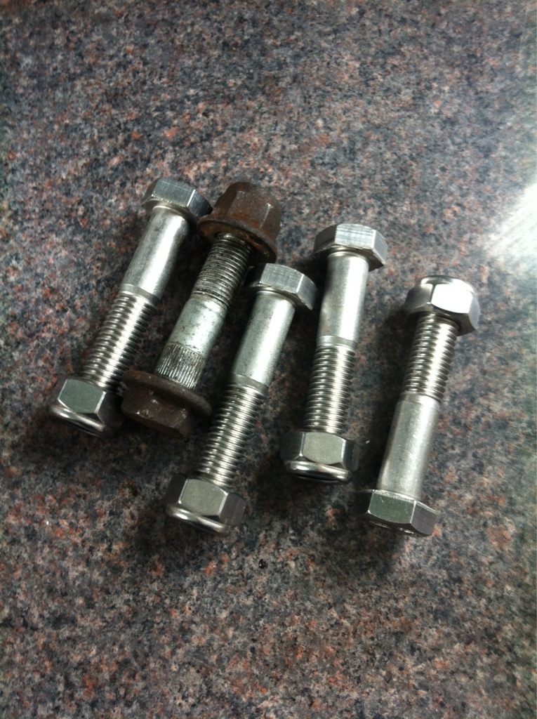

Now I'm no good at reading bolt sizes but the ones I've taken off are 14mm in diameter which i presume is m14 and the length is 60mm half threaded so I'm a little bit confused by what the size is above?
  172
Sorted. Now renault wanted £5 a bolt and couldn't get them for at least 2 days. A local fastening place sorted me out 4 for £5 with nylon locking nut.
For any one that is interested any m14 hex bolt with 60mm length (only half of this is thread.) will do
I am sure they will do just fine. The only difference with the originals is they have a splined section at the end which helps them not spin when you tighten them up. Providing you have two 21mm sockets/spanners you're laughing. :)
Yep got some m14 washers as well. Your correct no splined bit and to be honest makes absolutely no difference once they've been in a while I'm certain they will seize up like the old ones had leaving me with five broken 21mm sockets. Plenty of heat was the only way to get those little buggers out!
