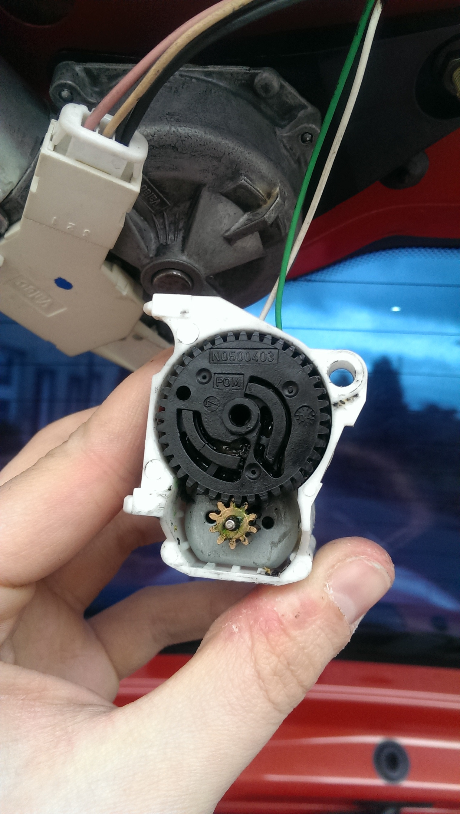

Hi. My gfs clio boot has not been opening for a while. Well, without me climbing through the back with a screwdriver!
Ive done a bit of searching and thought the motor might've burnt out. I removed the boot panel, took the motor off and it looks like the little plastic bit that's flicked by the large black cog is broken.
My problem is I'm not sure what the part is called or where to get a replacement. Also the lock makes a horrible grinding noise when the car is locked or unlocked. I'm not sure what I've done to it! The boot is permanently unlocked too but that's not a massive problem.
Thanks for any help!

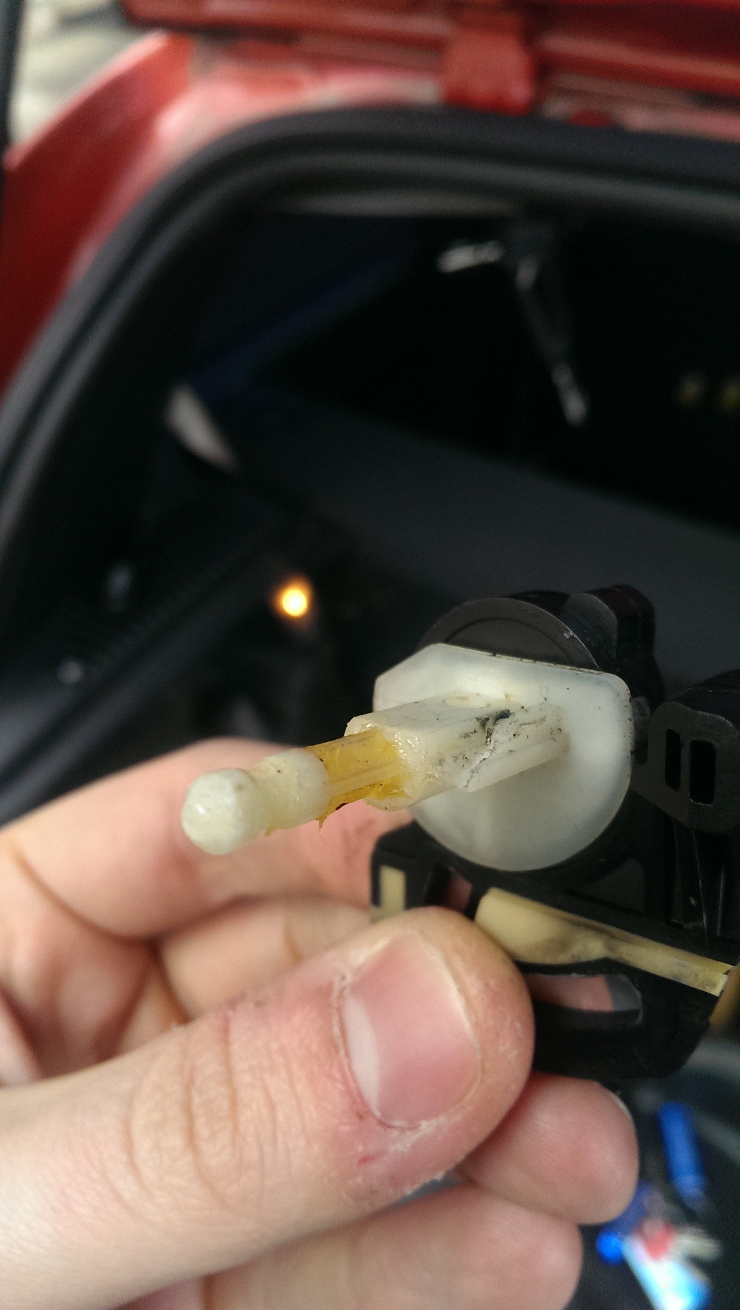

It's the white bit here I need:
You can see where it's broke.
Is that the bit you've got mate?
Also, does anyone have a clue why It's making the horrible noise since I took the cog out?
I took a crappy video
Maybe something fell out? Should there be something in between the cog and the hole?
