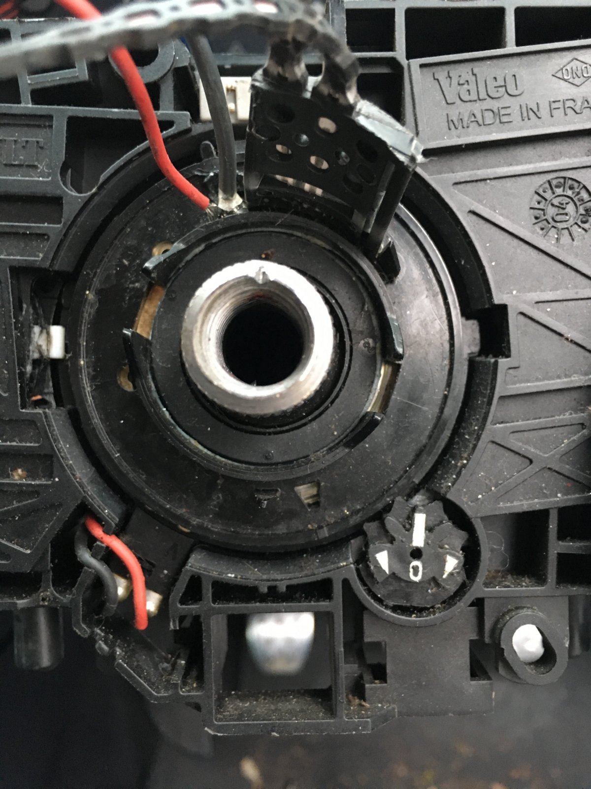

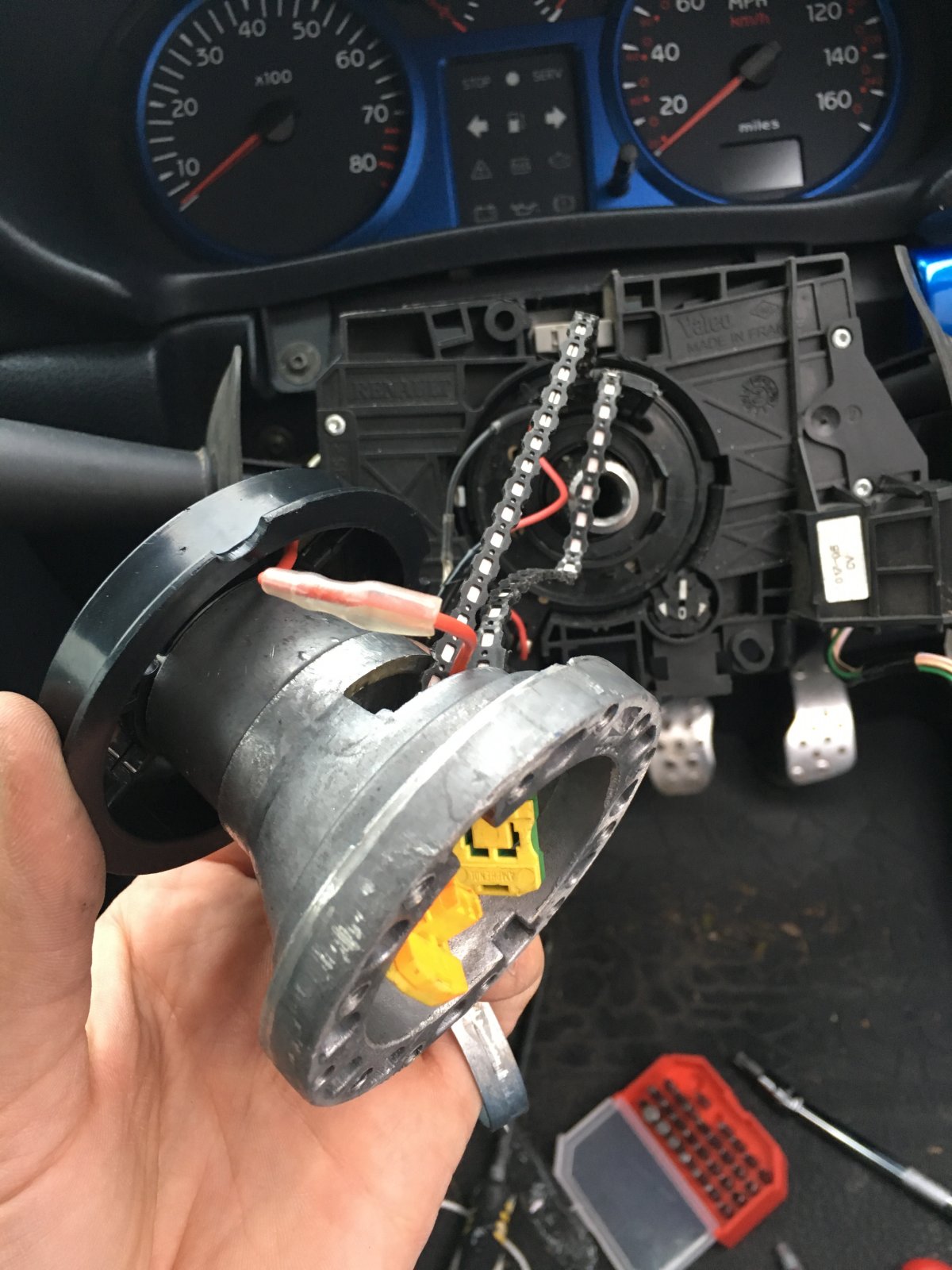

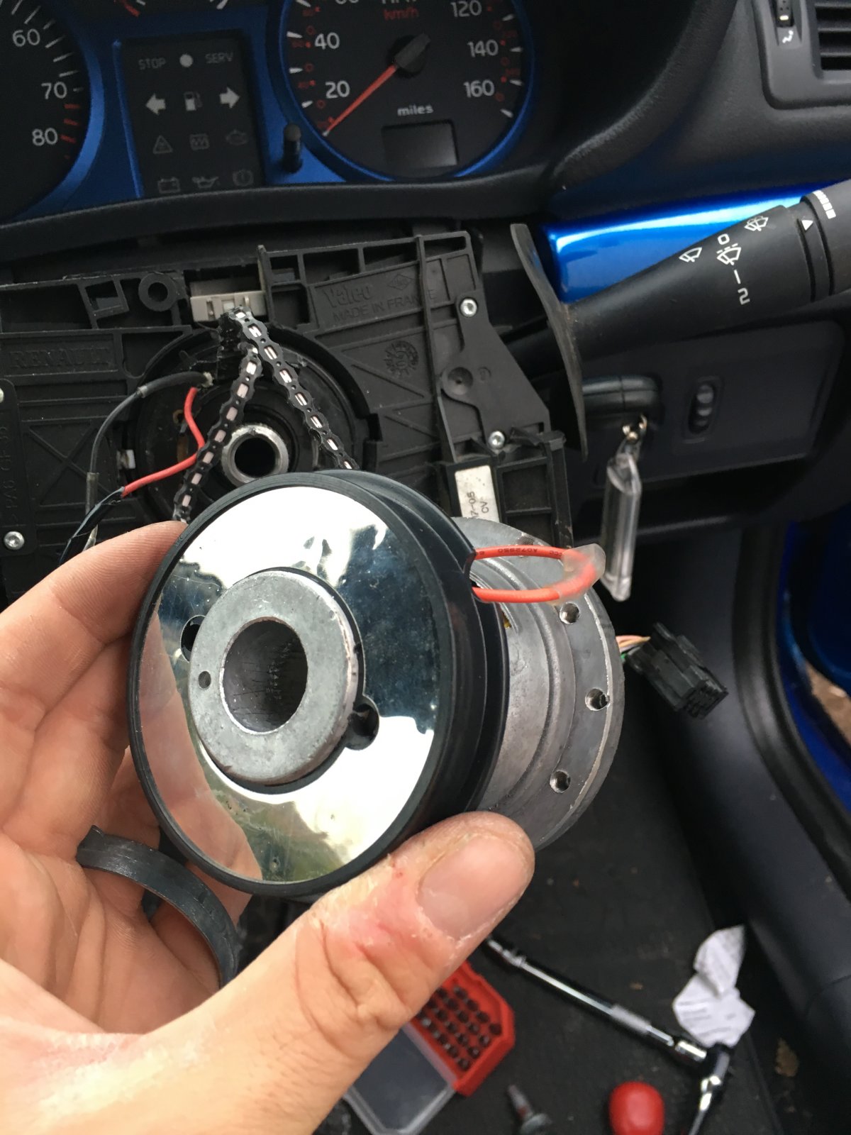

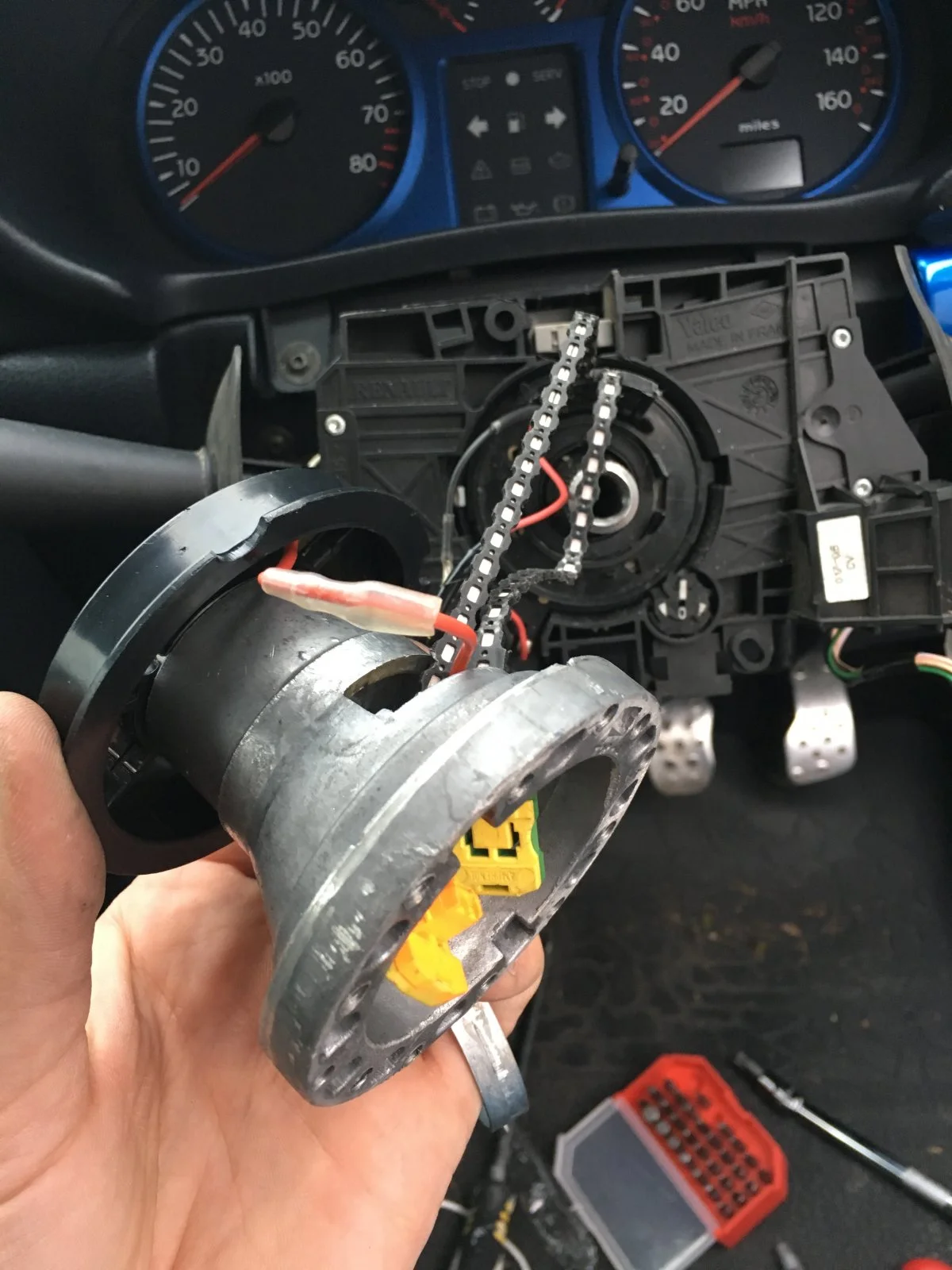

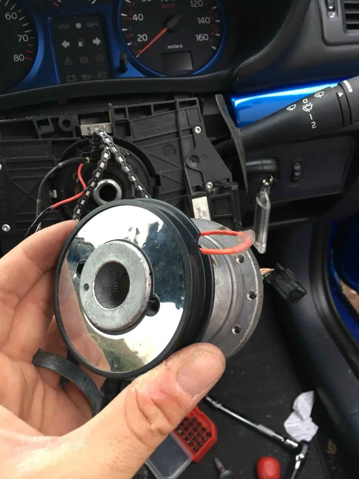

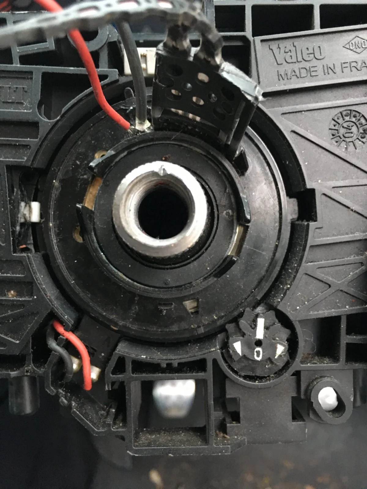

Bought a steering wheel boss off eBay, I don't see how this can fit onto my car with the airbag connector.. any suggestions how or if I can get round this?

I managed to make it work in the end, i removed the plastic with the silver reflective sheet and it went straight on. Just need to wire up the horn, has anyone completed this?
Awaits the broken squib. The horn is known for shorting when swapping from a oem wheel so a ph1 push horn is advised
The wiring for the horn looks like two wires, the horn I have for the new steering wheel is two wires, is this not going to be ok, I assume this is the horn cable I have identified.. unlike the Renault sport wheel I have a horn on the wheel already
