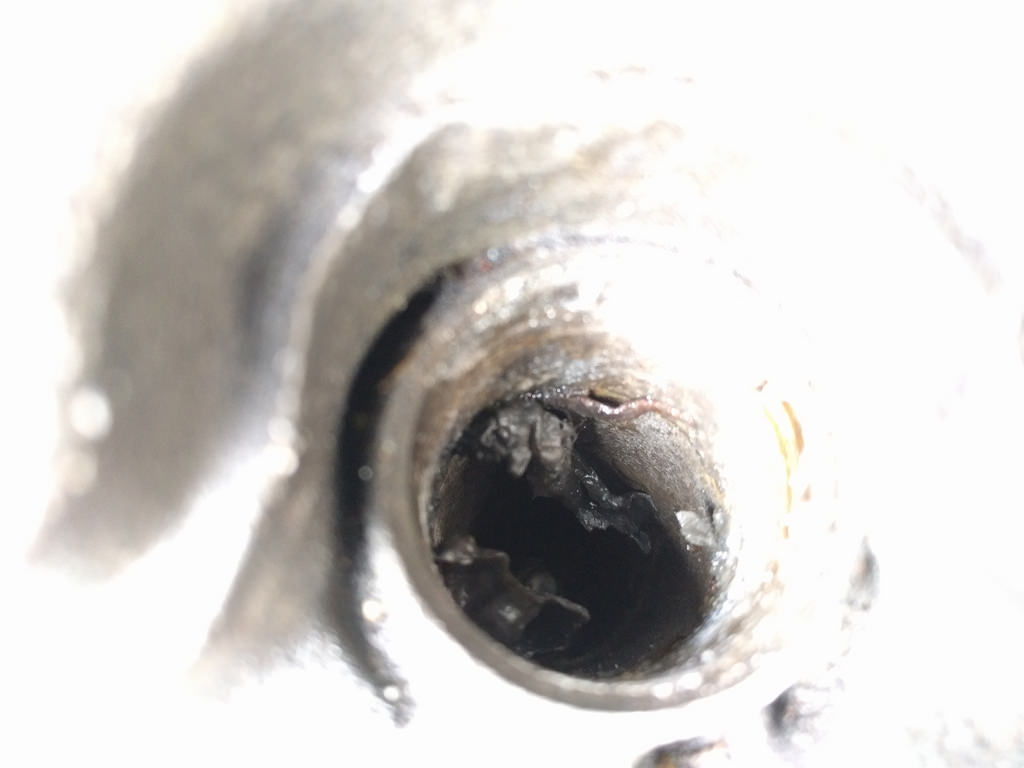

I've just taken the inlet manifold off, and pulled out the spark plugs.
First off, all of the spark plug holes had oily residue inside them, some worse than others - but the 3rd cylinder from the cambelt side also had some rubbery gunky stuff... maybe dialectric grease or something mixed with oil...
I cleaned each hole out with a rag, then blew it out with compressed air.
Once clean-ish, I took out the plugs - cyl 1 (assuming that's the one closest to cambelt side) was dripping with oil, on the actual sparky bit beneath the seal. Worrying!
The other three were dry, just trace of oil on the top-side terminal.
Since it's just Cyl 1 that was oily, I'm guessing/hoping this has just been the result of a clumsy oil top-up in the past. When I blasted it with compressed air, certainly plenty of oil residue was sprayed upwards. I gather that there are a couple of seals/gaskets in the region that may be worth swapping too - but generally the top of the engine is very messy, so I imagine it's had a few clumsy oil changes at least. The "well" part between the inlet manifold and the fuel rail guard had small pools of oil in it, which backs up the theory.
