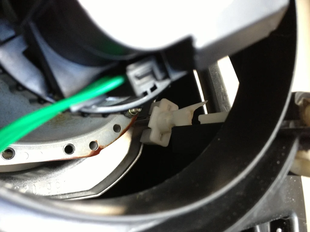

As above. Bought a set off eBay. Arrived very well packaged etc. However there is a broken clip. Before i send it back etc. can someone tell me if they are repairable / fixable.
_WILL_
  172 Cup
Common knowledge on here that xenons shouldn't be couriered. These aren't fixable without taking apart the whole unit.
I know it's not ideal, I am aware of that. Equally it was cheap enough that it was worth the risk. You say I need to take them apart, I'm okay with doing that, can you buy replacement clips?
  A.N. Other
Nope, and they're a right pain to try and fix - I broke one on refitting after successfully glueing back together. Was quite annoyed!
_WILL_
  172 Cup
For it fixed today. Fitted them and I am very happy.
I just used the clip out of the original cup headlights. Took a bit of effort but sorted now.
