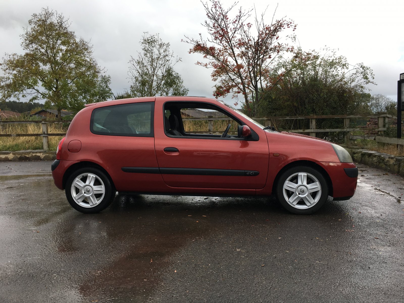

Afternoon all,
As the title of the thread suggest... I have just picked this Dci up today.
I wanted something that would be brilliant on fuel as im travelling 50+ miles a day. I wasnt too bothered how it looked, as long as it works.
This one does just that...kind of. And this is why im looking for advice from any of you in the know about the Dci model.
There is a noticeable issue, which is a droning sound which i believe to be a front wheel bearing or something to do woth the disc or pad. When breaking i can feel a judder through the pedal. Does anyone know if this sounds like it could be the bearing, or would you suggest it would be more brake related?
Im also looking for advice on how to service. I service the 1.2 mk2 we have myself so assume i will be fine doing this.? Is there anything i need to be doing differently when changing the oil and oil filter on this to a normal 1.2?
And who can tell me how much oil this model requires?
Im also welcome to rcomn dations on what oil and grade to use. I dont mind spending premium for oil as i want to make sure it is in as good shape as it can be. The service history with it stops at 2013 on 65 and its now on 89k. The oil on the dipstick is BLACK and the oil filter looks really old so im. Ot sure if it has been serviced recently.
What else would you suggest changing on a self service? Air filter i will be doong but is there anything else that should be done with the dci model?
It is currently showing as getting 63mpg which i believe is a good figure?
Thanks in advance. Anyone who can be bothered to read the above and comment i really appreciate it!

63mpg sounds about right for those! Looks like the 65hp model so should probably be able to get that figure up a bit still with some careful driving on long runs.
For a first service, I'd be doing the lot. Oil and filter change, along with changing the fuel, air and pollen filters too. They're not expensive cars to service so you're as well doing the full lot for peace of mind. Following that my service intervals were always 8-10k for an oil change and do the fuel and air filters every second one. IIRC they take about 4.5L of oil on a change. I always got away with a bit left in a 5L bottle on oil changes anyway.
Also, don't get overly worried about the oil looking black. It's pretty normal on a diesel. You could do an oil change, run the car for 10 minutes and check the oil and it would be black again lol!
