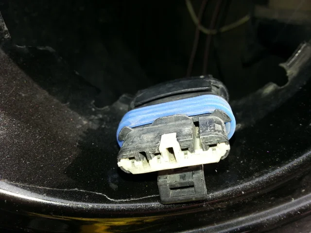

Bought some very cheap foglights off a car boot stall today for £10.. Saw they had wires and thought it would be an easy plug & play thing to get them wired in atleast. (know about that they wont work without the ecu being programmed for them) but oh how wrong I was with the wiring.

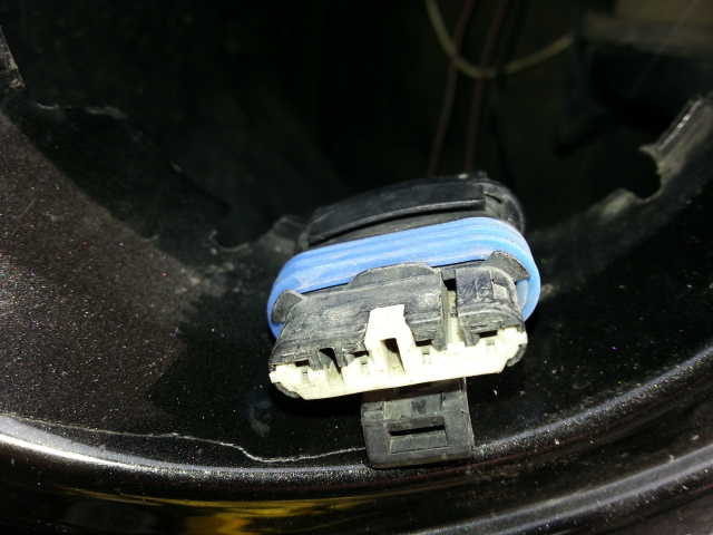

Below is the picture of the wires that come from the car that was attached to my foglight cover:

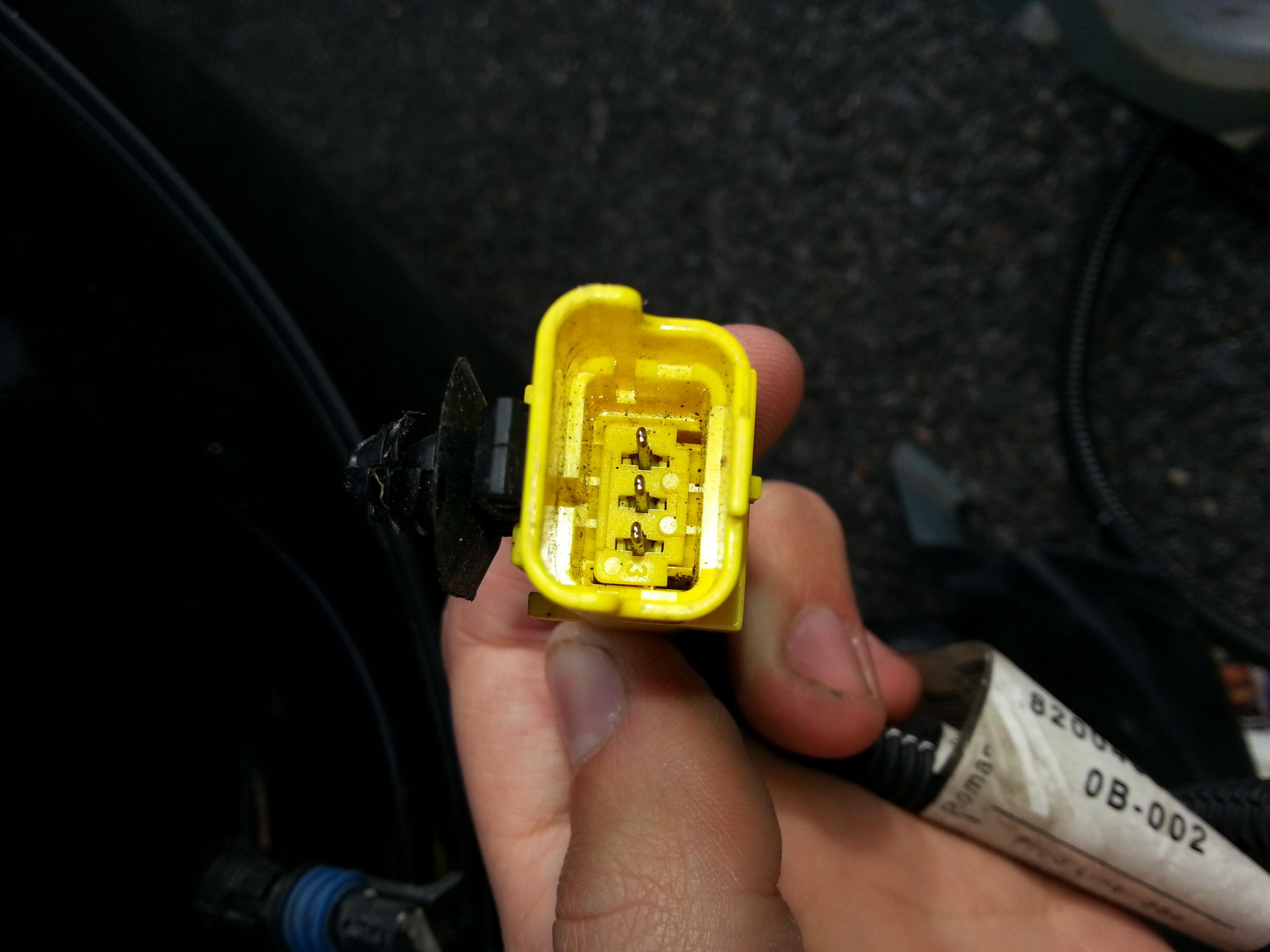

Here is the end of the wire that came with the fog lights:
The one that came on the fogs is smaller to the one that was on the car?
Also heres a few more pics to show:

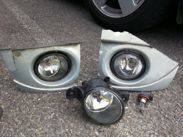

Picture of the foglights +1 extra!

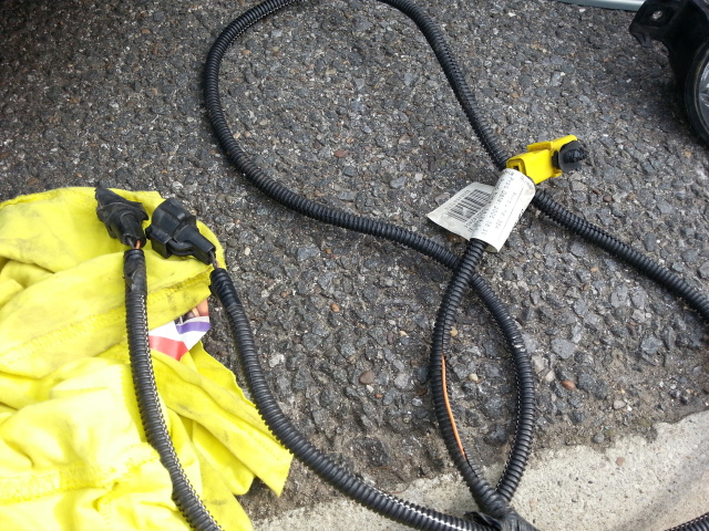

Picture of the wiring I got with the foglights?

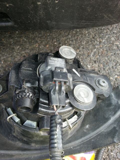

Picture of behind one of the foglights with fixings.

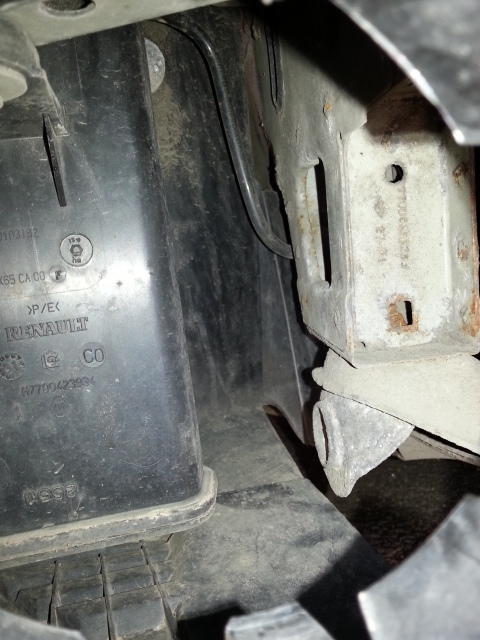

picture of the driver side through the fog light cover hole.. No wires at all
For some reason the passenger side picture wont upload but there is a cable but doesn't wire up right.
Also whilst I was looking I didn't seem to feel any fixtures for the fog lights to fix onto.. Could my bumper not have any on?
If there isn't its going to be a massive pain to sort and will most probably sell the foglights on!
Any help would be good as I need it!
right ive had a little search and i think the wiring loom that came with it is for a MK3 Clio. The fog lights will fit my car but the wiring wont! So i will need to sell this mk3 loom and buy the mk2 loom!
