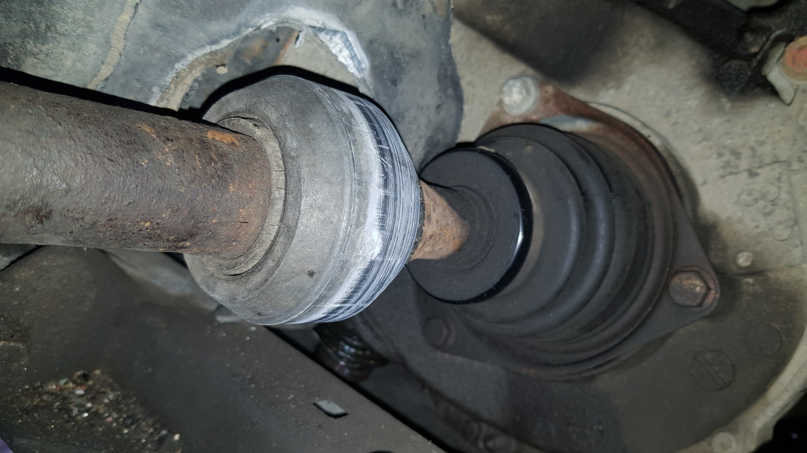

Noticed this but just seems like its rubbing on the fabric heatshield hence the shine.

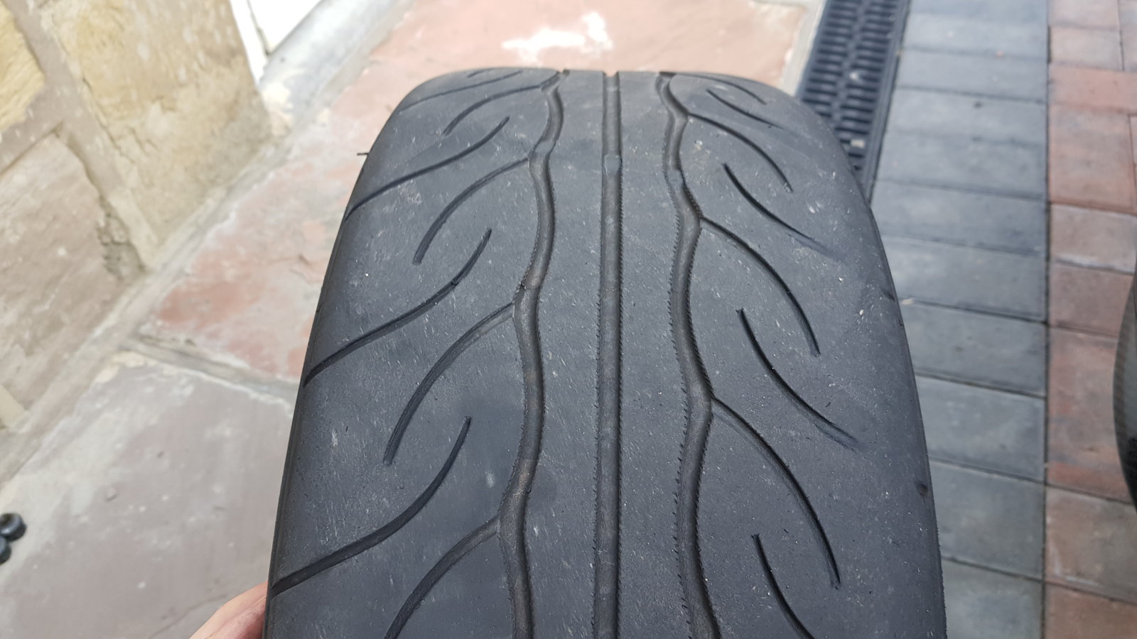

Also noticed my tracking has been good
